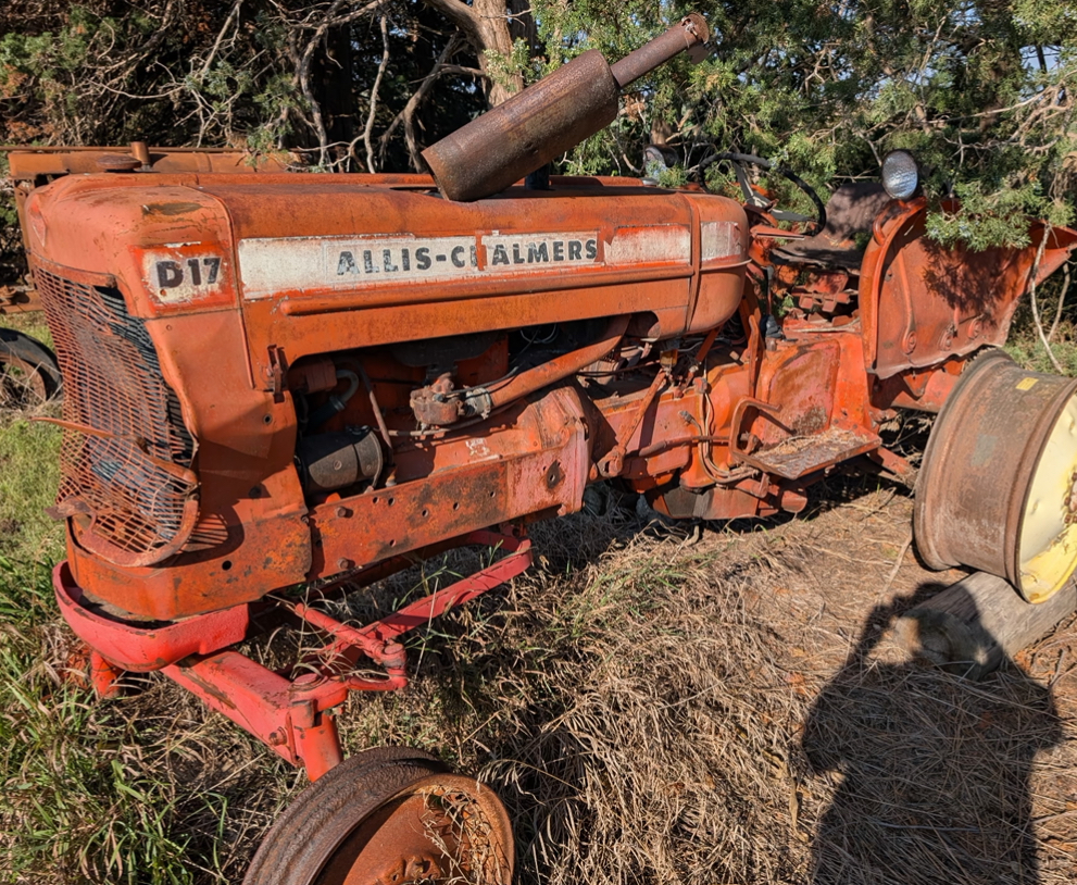

I did it again, bought another tractor out of a fence row…
Looks to be a series 3 d17 gas with a serial number of 66169, correct me if I’m wrong because I have been before.
Haven’t picked it up yet to mess with it but hoping to get it this week before harvest stuff get crazy but I figured I’d post it now to start from the beginning.
The front end is only sitting on it due to some one swapping the original narrow front to a wide front and not taking the time to do it properly.

The guy who owed it is a John Deere guy so he was really excited to have this one gone, he has another one that’s in better shape he’s trying to get rid of too but it’s a series 1 I think.
Don’t think this one will be a throw a battery in and go type….
What size of front tires are the series 3 supposed to have?

6:00 or 6:50 x 16's. Some later ones may have had 7:50's but on a wider rim.

Standard size was 6.00 X 16

55allis, Congrats on rescuing it. Serial number 66169 would make it a 1963. So its got the dry engine air filter. Assuming since its muffler is busted over, engine may be frozen?? One good thing, is that you won't have to remove old tires from rims.... :)

Good save. Yes we are all curious if there is any chance the engine isn't stuck.

Not sure yet, previous owner was thinking it wasn’t stuck when he got it… but he wasn’t sure how long he had it…
Was told the muffler got broke off in the year before storms…
Not sure how good the muffler kept the moisture out but it does look like it has a good rain cap. Really hoping it didn’t fill with water and freeze…. I know from experience what that could do…

Good fixable tractor. Go slow and easy on the bent up sheet metal.

I got it to its new home!!
It’s missing the starter, waterpump and both snap coupler latches.
The engine is stuck but I got all the controls to move freely. The gear shifter is stiff but it will shift in all the gears. The gas tank is mostly shiny in the bottom as I can see.
