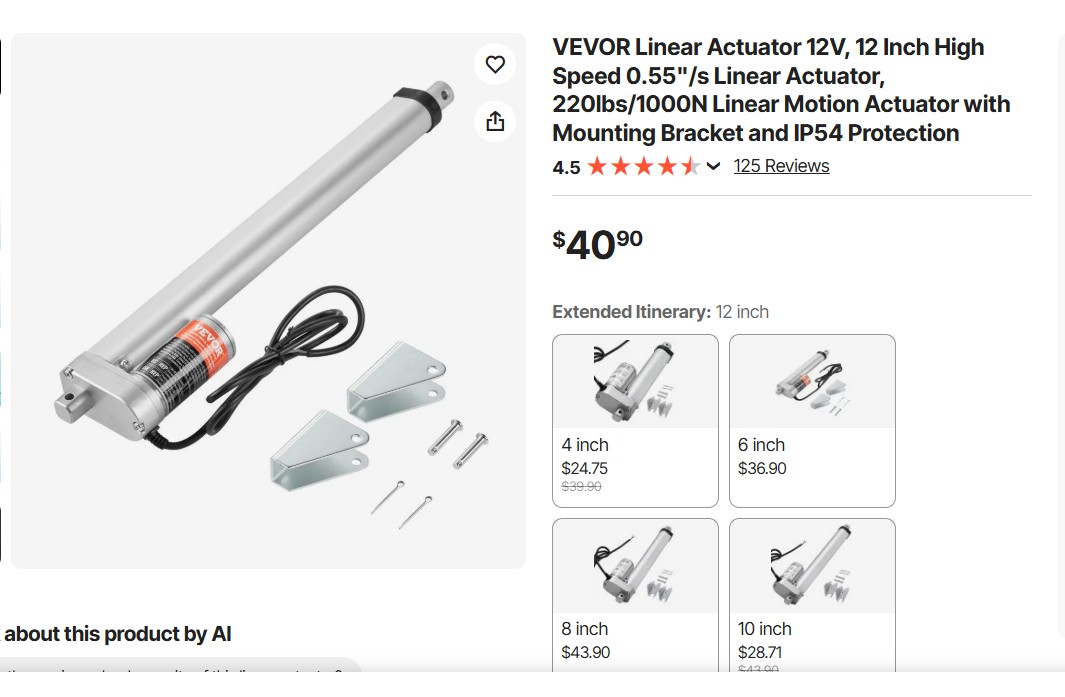

Post Options Post Options   Thanks (0) Thanks(0)   Quote steve(ill) Quote  Post ReplyReply Direct Link To This Post Posted: 1 hour 41 minutes ago at 7:53am
iowa has the plan... its called an electric linear actuator.. and you can stop at any spot in the lift... used in place of the lift cylinder... and WE NEED PICTURES of that door now !!

Post Options Post Options   Thanks (0) Thanks(0)   Quote desertjoe Quote  Post ReplyReply Direct Link To This Post Posted: 1 hour 3 minutes ago at 8:31am
 Hey Steve this looks like something I could dang sure use,,,!! What site did you find it on?
