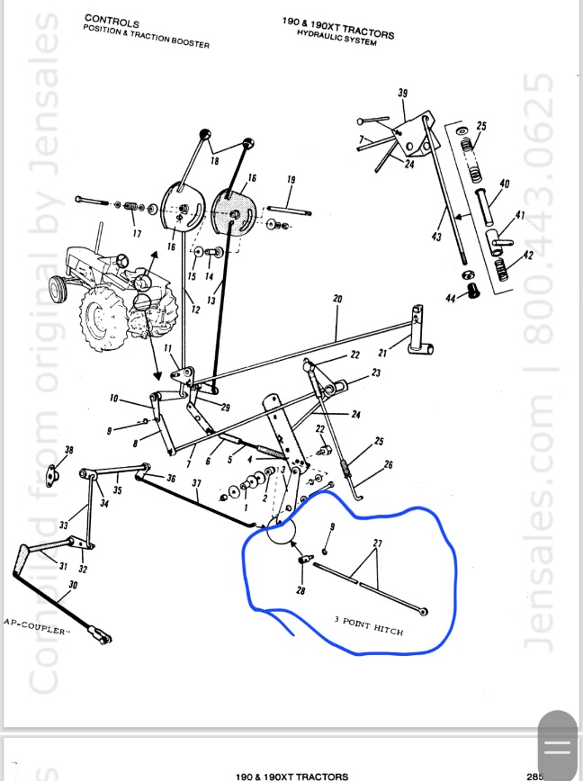

I'm looking for part 0234574-1.
It's the 'sensing rod' that connects the bell crank to the 3pt lower arm on the right side of the tractor.

With your draft arms let down to "level", grab a hold of them and see if they can move forward/backwards by pushing/pulling on them by hand. There should be basically zero movement. If there is, the torsion bar hex ends, left mounting bracket and bushings are worn out. That link rod is what sends the draft signal to the "Traction Booster" system to  transfer weight when plowing with a mounted plow.  The TB system is useless if things are worn out.
