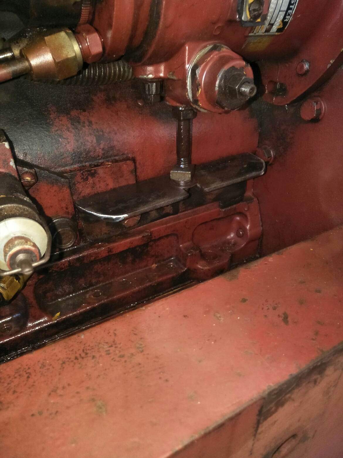

Was wondering anyone seen this before,bought this 7040 a few years back and thought, hmm,maybe the owner lost the timing pin plug once and that is his safe gaurdšŸ˜‰.fast forward to now ,tractor is getting a make over and i decide the mod is going while im putting new orings in throttle shaft on pump.. Turns out the plug is stripped and that mod holds it in?

That is a clever and unique repair.

Guess it's better than duct tape, baling wire, or zip ties.

Yup that’s different

I assume no threads left in the pump housing.

No doc,not onešŸ™it will have to stay that way until it ever comes off for work.
