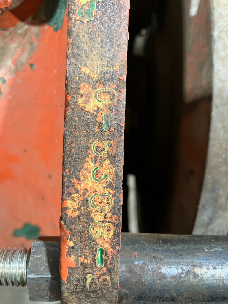

i picked up this engine and pump with some other parts pump dosnt fit that engine   , what is the engine  and what is the tank on it ? also it has a oliver looking color green paint that is under the orange.   will this fit in my c ?  was this some military spec. engine

There should be a s/n stamped on the engine behind the carb or on the left bell housing flange lip.  The engine looks to me like a G-138 or G-149 to a D-10 or D-12. The Barnes pump has a diesel p/n on it. So, maybe a WD-45 or D-15 diesel ? The square drives shaft looks like an old Detroit diesel engine, but the p/n is clearly Allis-Chalmers.

D-10/ 5308 serial number should make the engine a G-149 cubic inch power plant. G-138 cubic inch was prior to D-10/ 3501.

what is the dash backwards 2  or5 on the end of the serial number ?  will this fit in a B or a C ?  i  bet this was one of those backwards tractor forklifts

The serial number is 10- xxxx not D-10, This makes it a 138 engine. The tank when the engine was installed in a tractor was used for the non draft sensitive live hydraulics.

If that stamped number (5308) is the chassis serial number, effective 10-3501 was the start of the G-149 engine. So, unless there's something I don't unnerstan, 5308 is newer than 3501.

tonight i will measure the bore and stroke the was allready off it  but i do have the pan

Stroke is the same 138-149-160. The bore is different between all three.

3.50 bore , now will this bolt in my c

The stamp is on the engine flange.
10-xxxx is a 138
12-xxxx is a 149
14-xxxx is a 160
My early D-12 has the 10-xxxx in the engine and next to it on the torque tube is D-12 1886 . This is an all original D-12 including the tires
