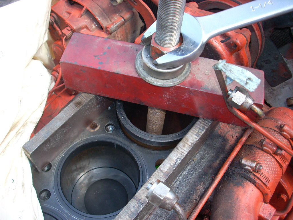

today all by myself! First time for everything. It went well and this morning my Mechanic is coming to check bearings, journals, condition of an all original engine. When I measure the crank and rod brg it appears to have no wear on standard parts...2.3725" for both...but maybe that's just what I want to see lol!

Great pic's cap!!! Were the dogs suppervising the whole time? The sleeve pulling op pic's are a great referance for others-- a picture is worth a thousand words.

Did you make the puller tool? Great advice on the bearing. Go the distance Dana, its a field of dreams, Trev.

Thanks for the tip Doc A. I did that and when my mech showed up I told and showed him. He said WOW he would do that from now on. He miked and said everything was good. He always puts new rod bearings on when apart even though they mic ok. Mine are standard with no apparent wear. He said with no ridge in the tops of the sleeves he thinks somebody's been in there within the past thousand hours. My wishbone anchor bolts were 3 different sizes outta the 4 bolts and my oil pan gasket had cement on top and bottom so I think someone had been in there if the factory never glued both sides; did they? Anywho I will put back together with new standard rod brg, sleeve, piston, rings, wrist pin and clips, all new top end gaskets, oil pan gasket. When the shop finishes the valve job she'll be tested again. If she doesn't purr like a growlin' kitty then...the pump man's gettin the pump back.

Cappy and Dill helped supervise the job. Kept askin Cap to start the nut at the bottom of the sleeve for me but he just sat there supein'. lol Not flat top...they have bowl. 2900 turbo diesel AC 301.
