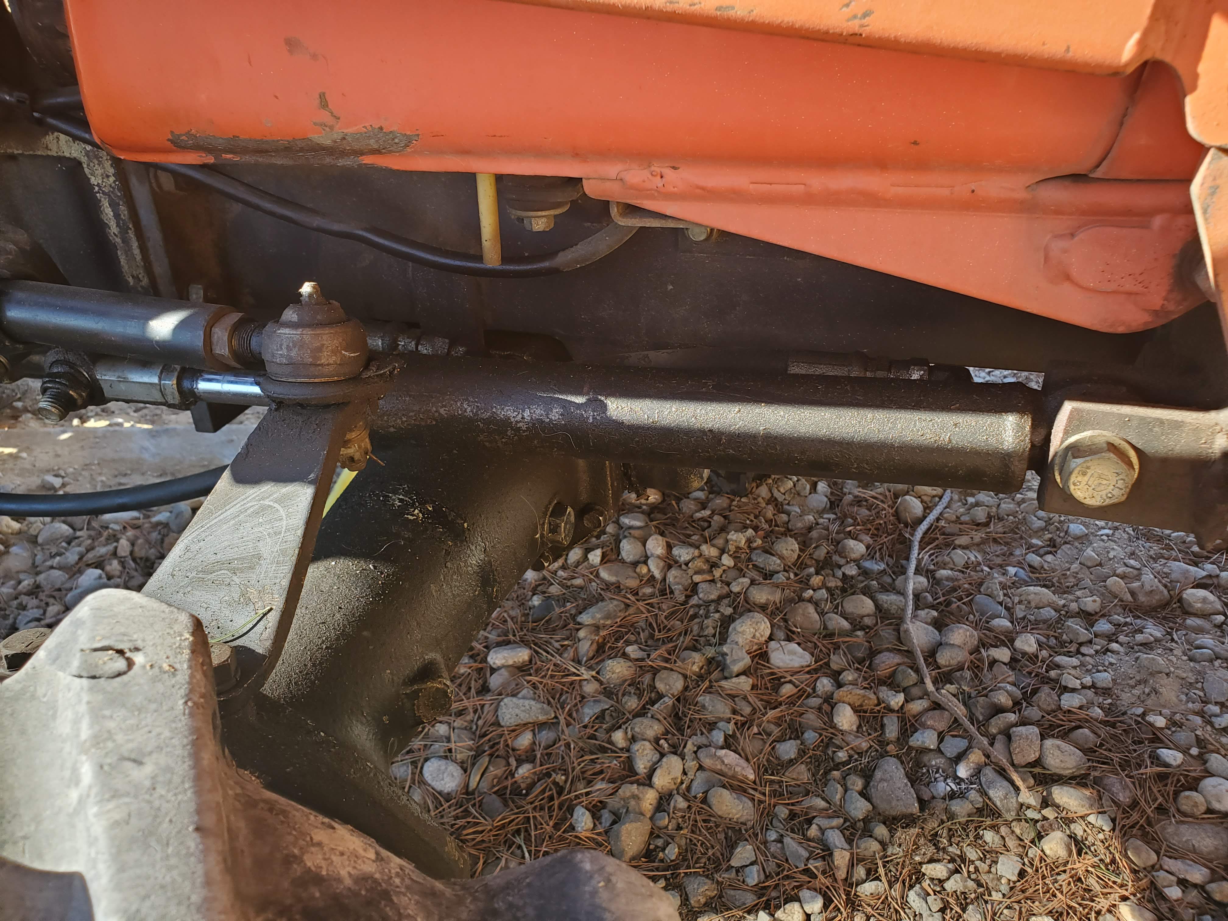

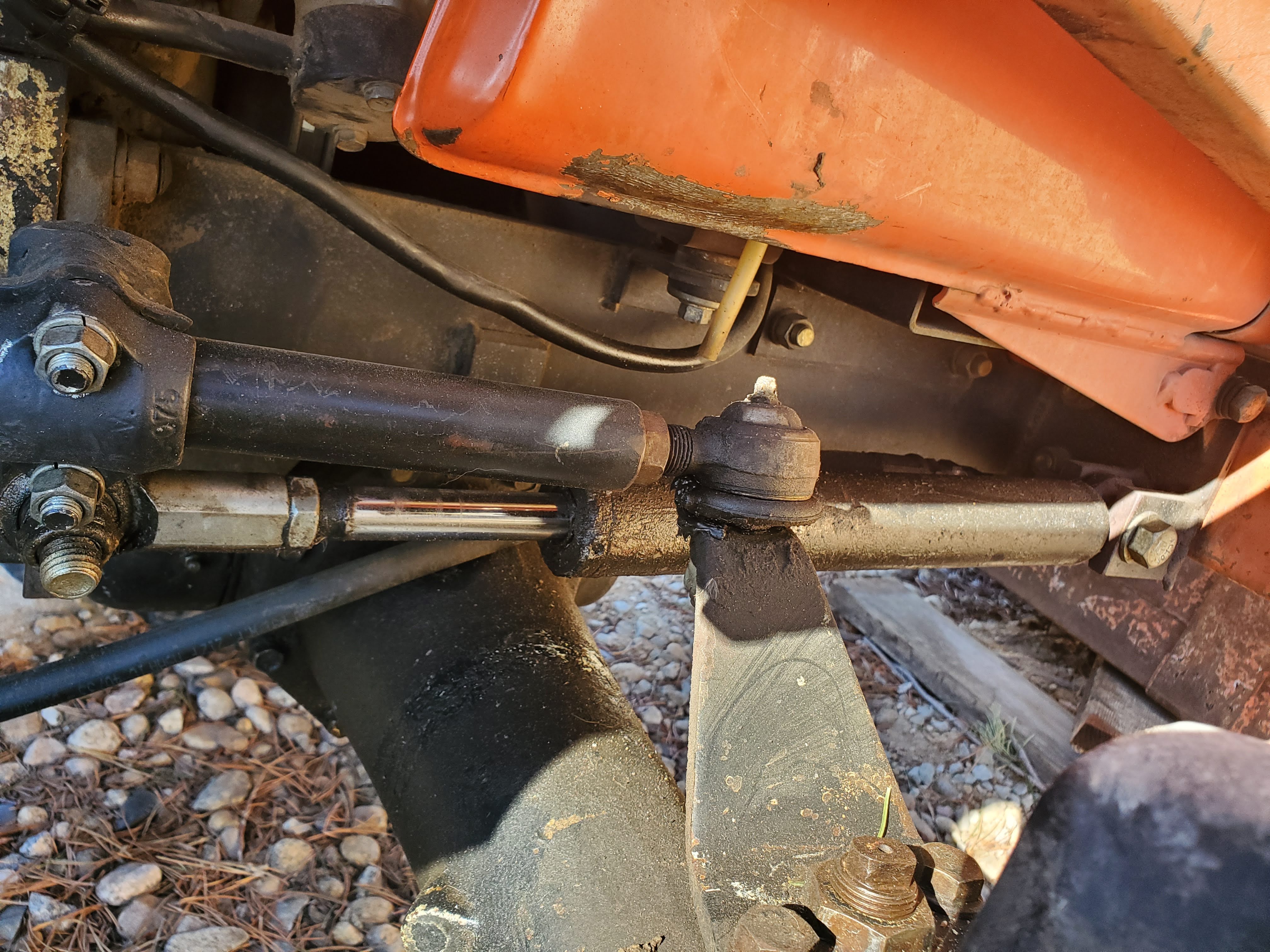

5020 MFWD Power steering
TramwayGuy View Drop Down
Joined: 19 Jan 2010
Location: Northern NY
Points: 11763
Post Options Post Options   Thanks (0) Thanks(0)   Quote TramwayGuy Quote  Post ReplyReply Direct Link To This Post Posted: 22 Dec 2019 at 10:39am
As far as I know, power steering was not available on the 5020 (or 5030; which I have one of).
herm0016 View Drop Down
Joined: 18 Jun 2019
Location: Longmont, CO
Points: 22
Post Options Post Options   Thanks (0) Thanks(0)   Quote herm0016 Quote  Post ReplyReply Direct Link To This Post Posted: 22 Dec 2019 at 11:02am
It was via a 3rd party kit.
Joined: 19 Jan 2010
Points: 11763
Post Options Post Options   Thanks (0) Thanks(0)   Quote TramwayGuy Quote  Post ReplyReply Direct Link To This Post Posted: 22 Dec 2019 at 11:33am
Who made it? Jackson? There’s really no way to put it on anywhere that I can see?
Do you have any photos?
Joined: 18 Jun 2019
Points: 22
Post Options Post Options   Thanks (0) Thanks(0)   Quote herm0016 Quote  Post ReplyReply Direct Link To This Post Posted: 09 Apr 2020 at 2:33pm
the kit was bought in 2014 from jacksonpowersteering@gmail.com  roland jackson.  that is all the info I have.  there is a priority valve on the fender between the loader and transmission.
Edited by herm0016 - 09 Apr 2020 at 2:36pm
