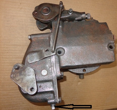

The drip is coming off the drain plug on the bottom of the valve on the pump. (Not my pump, I borrowed a pic online. I think it's Sugarmaker's.) It is tight but I don't see any thread sealant on it and I don't think it is coming from there anyway. It is just the low point that it is dripping off. ![]() The left side is moist about half way down so I think it is coming from above but I do not see any drips. That's why I am going to try the dye. Edited by DanC911 - 09 Oct 2017 at 11:27am |

You need to give the old girl a good bath to clean away the crud so you can see where the leak is coming from. That would be my first step.

I put some UV dye in the hydraulic fluid and saw a leak from the hand
clutch cover. So I took off the battery box and the cover to find no
gasket and what looks like silicone calk. Just translucent or clear
caulk.
![]() I made a gasket put it back together and started looking for other leaks. This is the leak I have been chasing. Leaking from the bold on the right and dripping off the drain plug on the bottom of the pump. Lights up like a neon sign under UV light. I couldn't have found this one without the dye. ![]() Any suggestions for an easy fix? I really don't want to pull the pump again. Hytran is getting expensive!! |

If the gasket behind that right bolt head was installed without any sealer or goo, it will probably leak.

Thanks Dr. Allis, That may be the problem. I think I have a temporary fix by using some thread sealant on the bolt and a fuel resistant o-ring behind the bolt. Leak seams to have stopped for now. Let's see what happens when I run it doing firewood this weekend. |
