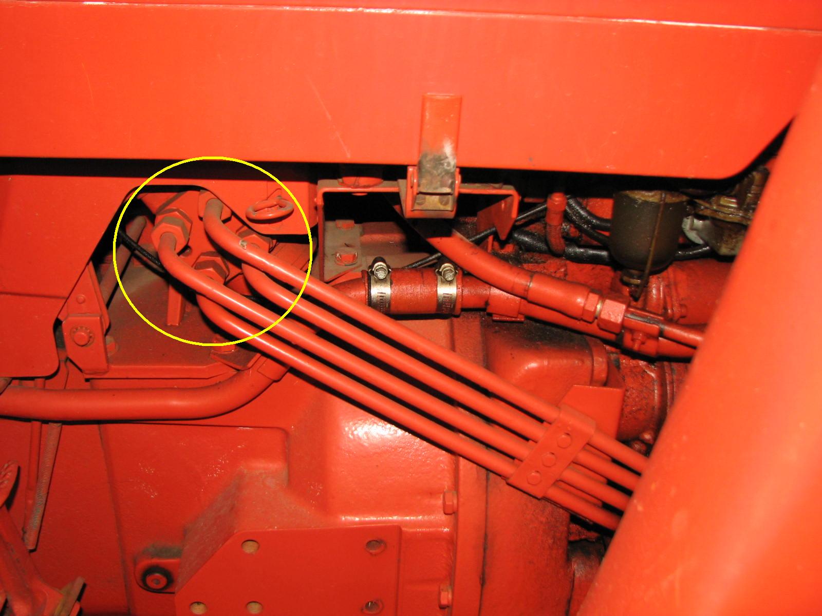

I heard the noise coming from this spot I believe.
Can someone please tell me what part this may be called?
Does it have something to do with controlling the hydraulic flow?

That is your steering motor. Those went into use when the companies went away from solid(shaft) links.

wow...that's a clean tractor!

Hi there, yes but that's not my tractor, my tractor is not as clean as this photo!
Then I guess that's not the part, because I can steer no problem.
I need help to determine what part has failed on me, I heard a whine before it failed.
