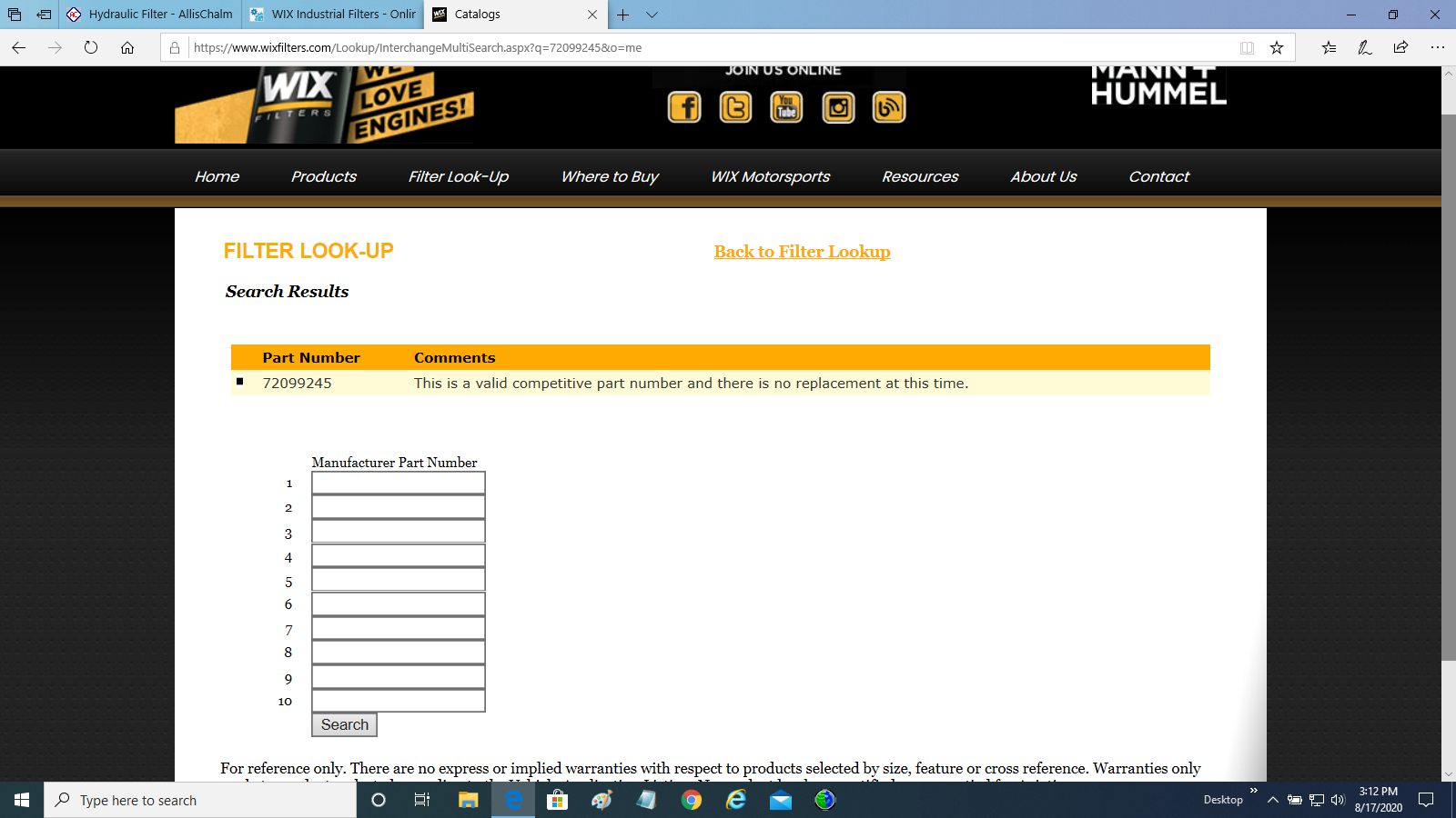

Hello, I am searching for a replacement Hydraulic filter for my AC 6140 S/N 1735. The filter on it now is an 72099245 which I have verified is the correct number. I have called all kinds of different places and MFG's with no success. Does anyone here have any information that could help?

holy crap...they have you by the short and curlies
WIX says it's an active # with no cross reference. yikes....

I just ran the # thru CARQUEST.... same deal not available
I think you are going to hear the words we all hate..."dealer only"
it may be worth putting in a call to WIX technical support. they may give you some info

From the WIX manual .......... hydraulic filters have no "generic" cross reference..

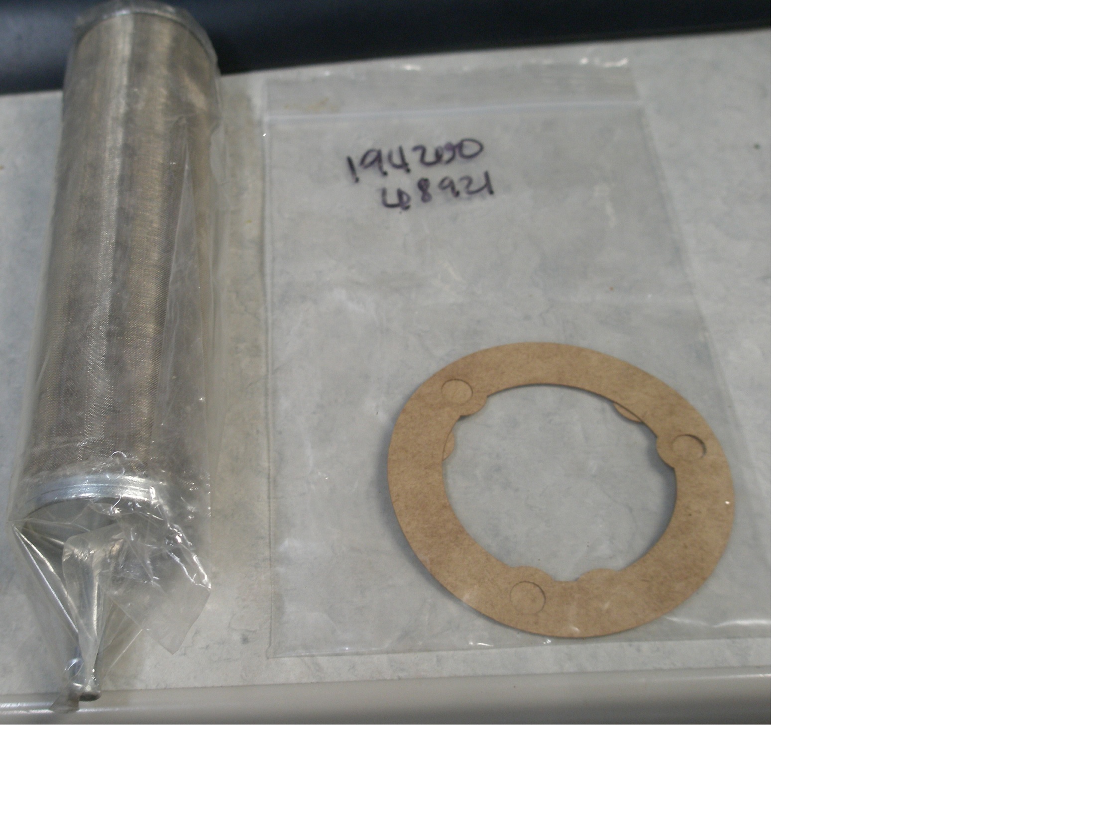

Well that was the original number, (7210875) I have a receipt that shows the original owner bought that filter, however I ordered that filter from Best Farm Parts and got one that looked like this picture nothing like the picture on the website at all which looked like the spin on filter. After some research, this filter is for a Yanmar

well that looks like a CARTRIGE filter or STRAINER that goes inside a CAN or inside the gear case... I think your looking for the OTHER part number ( spin on)..
there is NO REASON a spin on filter would cost $100.   They must be using the wrong picture in the sales lit............ or they just sent you the wrong filter ( suction screen)....  I would call and ask the SIZE of the spin on filter for $20.

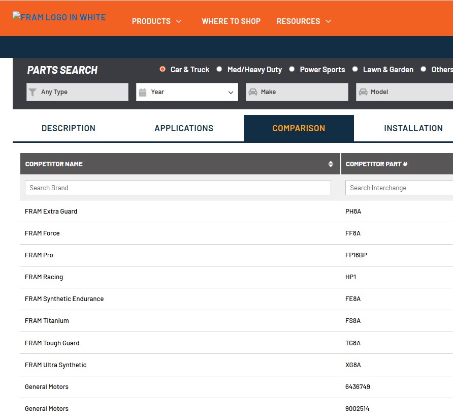

Just looking up some filter numbers for the AC 715B - what a confusing mess ,
Engine takes a PH8A for the Perkins 4-236 engine - but seems every other cross reference doesn't list that .
 Then fuel filters are listed as spin on - but use C1191A filter which I just got from a Marine Supply outfit for $5 each - but a marked John Deer on box
 Looking at the hydraulic filter - the thread size is 3/4 x16  and guess what it's same thread as the engine oil filter - as are the other size and specs as what hydraulic filter has .
