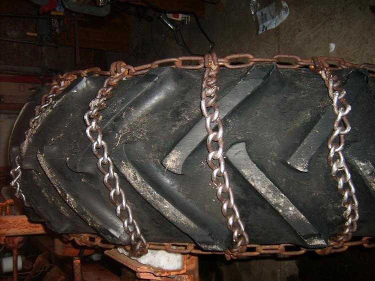

These chains were made for 14.9 x 28 tires but I cut the length to fit the 12.4's and before next winter I'll cut the width down to fit the 12.4's better. I made them out of chain stock from Lowes.

Brian, looks like they would do some good. My experience with those kind of chains was with a different tread design. The tires had a flatter angle for the tread and the chains went all the way down between the lugs so no part of the chain contacted the ground.

Here is how mine fit. They do fall between the lugs but it is night and day without them. The only time I get wheel slip is when I am pushed up to the snowbank. I bought the set for just under $100 at an auction if my memory serve me right.

 The chains that just run straight across are a waste of time to put on IMO. The chain will drop down between the tire lugs and become useless. The x pattern chains are great, but you won't want to drive down the road with them on.

there seems to be a dozen different designs for tire chains. some are just strap chains over the lugs. some cross or do an x patter. some have little VEE or X lugs on them.. What really works or is "any" type chain better than rubber tire lugs. Cost varies drastically and i would like to get economy, but good working chains ????

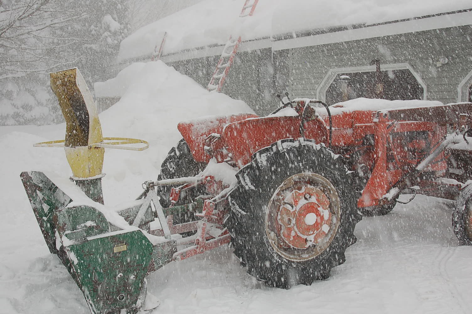

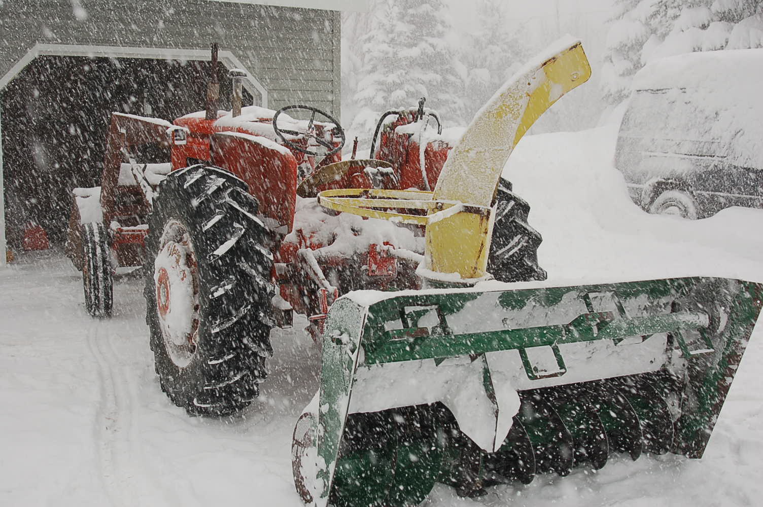

I've blown snow with my B and my CA, the problem I find (aside from a sore neck) is that reverse is too fast. With the CA I can use the hand clutch to let the blower clear it's throat but if the snows real deep  I have trouble getting moving again (I need chains) so I pull forward while lifting the blower and then get a bit of a run at it while I drop the blower again.
Plans for spring and summer are front mount the blower.
I've used the loader on the B but with 300' of driveway and a 150' x 200' parking lot I prefer the blower.
