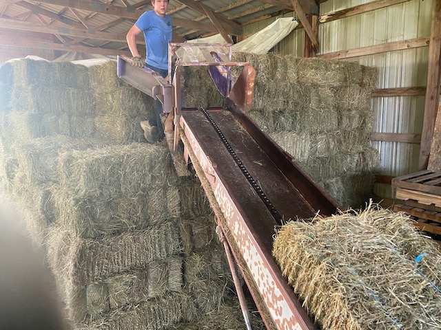

Hydraulics is powered by a single small pump mounted on frame in front of engine. A pto shaft runs from front pulley off crankshaft to the pump. If engine is turning, pump is pumping. Hydraulics running off the pump include a remote fan behind the radiator (runs on hydraulic motor), power steering, lift cylinders for the front snout and when loading or unloading, a hydraulic motor runs drag chains on front snout and conveyor down centerline of the bed.
To give an idea of it's purpose, couple days back driver and two stackers on the the truck picked up 150 bales from the field in 20 minutes. At barn, front snout raises up as much as 12 feet to become hay elevator. Can unload as fast as stacker guys in the barn can keep up. Or would if the driver (me) didn't screw up and kill it.

This is the actual contraption in question...........
This is a cleaner version.......closer to original. This one a Ford engine. Second half shows front chute/snout with elevator extension for reaching barn lofts, etc. I have the extension, but it's not working.....yet.
A couple items high on agenda to fix........one is that alternator. Somebody did some creative redneck engineering.......welded a tightener bracket to the FRAME, so belt tightens and loosens as engine moves. Have the actual Mopar/Dodge alternator brackets for the engine, but need to get a different alternator. This one is a Delco, with internal voltage regulator, but mounting holes don't fit.
A real Dodge has a voltage regular setup under the dashboard and behind the firewall. The hay monster doesn't have that.
Creative parts solution for some of this comes from Summit Racing......which have several self regulated alternator options for this engine. All high output, but if the lights are on, there is a big voltage drop........which may also be an indication the battery is weak......but existing alternator may only be 30 or 40 amp.
