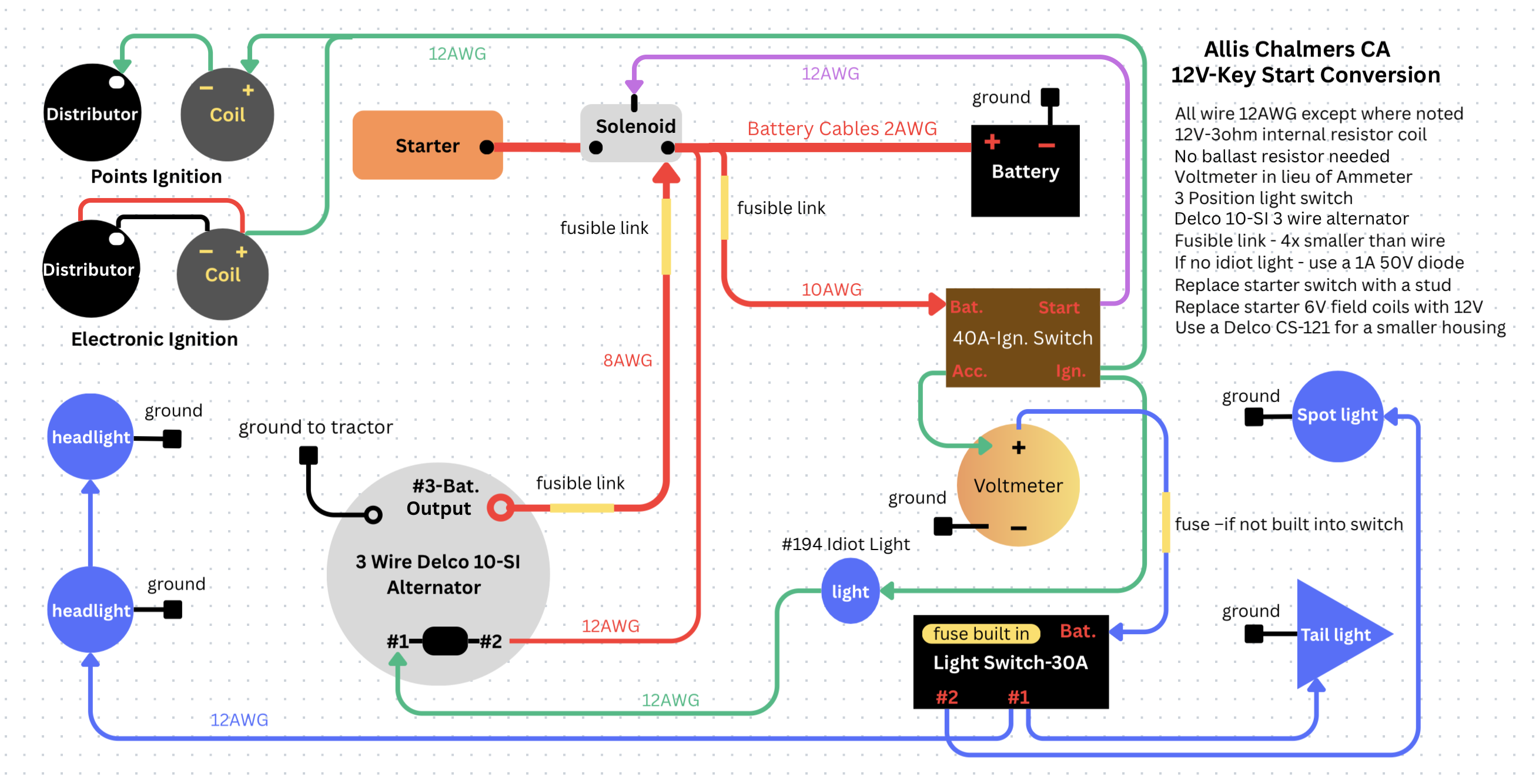

Here's my plan for wiring the CA

Any thoughts or advice...
