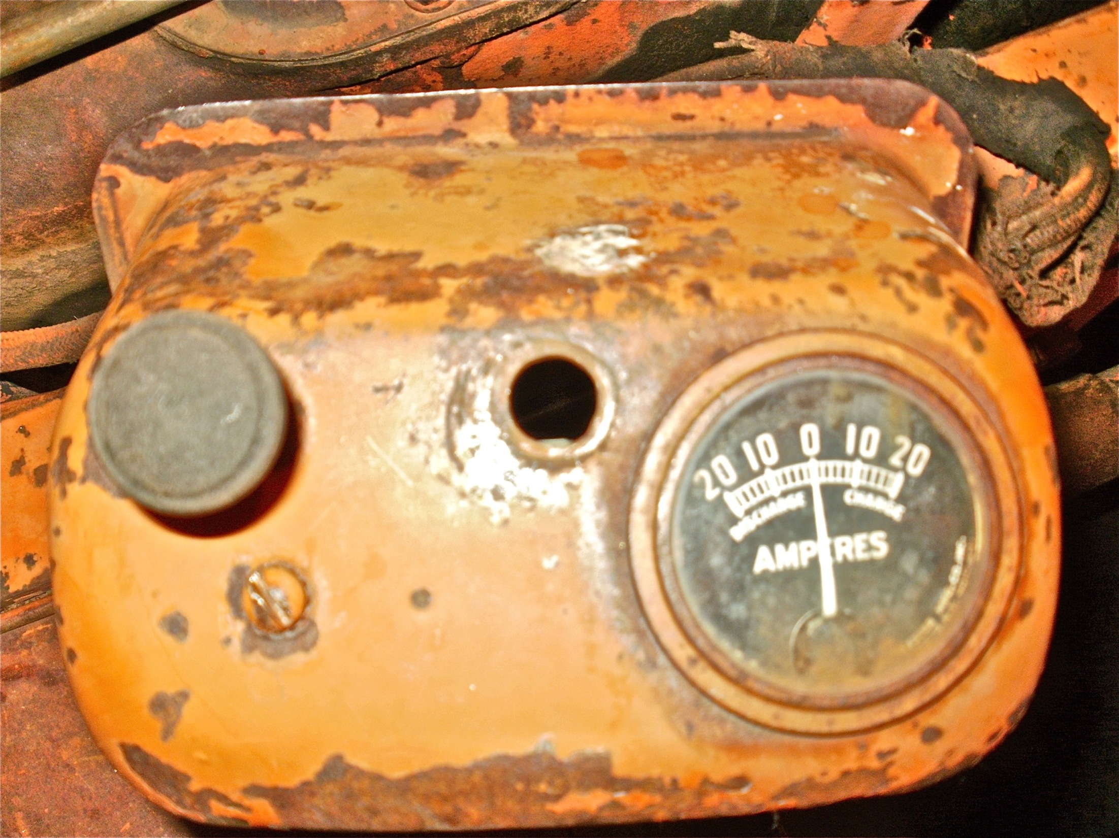

This is the dashboard for my 1950 WD. Can anyone tell me what goes in the center position? It was removed when I bought the tractor. Many Thanks!

I think the light switch goes there.  If the left one is a kill switch, the center is lights.

  kill switch goes in that hole

Your Light switch is in the correct place. That hole would have the magneto switch. If you had a distributor then you should have a key switch on the bottom left corner.

Thanks guys! Now I just need to find a kill switch and a wiring diagram.   :-)

If your generator has been disconnected, read this page before you start the tractor up.
http://dueyschutter.freeservers.com/photo5.html
Wiring for the mag is a wire from the post on the mag to a grounded switch. When the mag is grounded, the tractor is dead.

That looks similar to the one on my 1941 WC. I guess there wasn't much difference.
