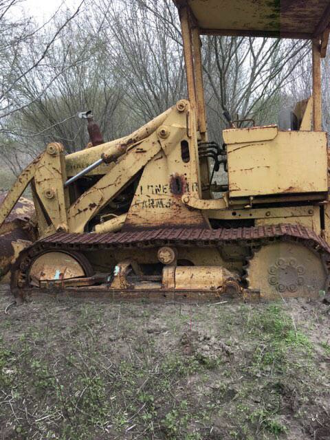

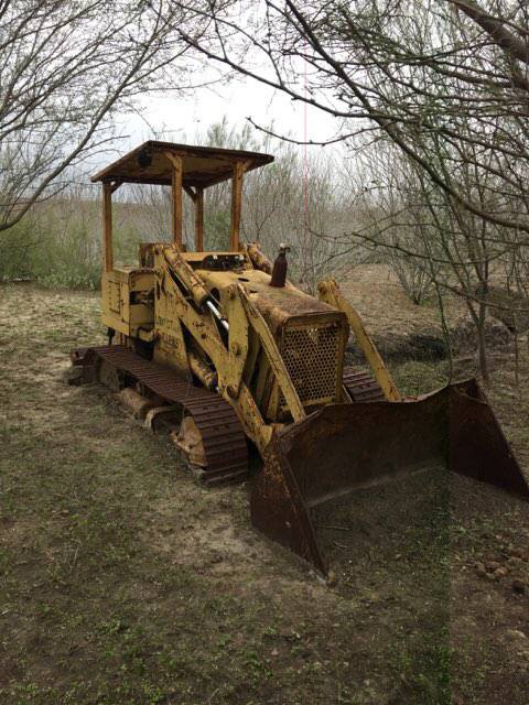

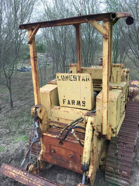

Can anyone help me identify the model of this allis chalmers track loader?

It is a h4,hd4 or 655 series if I remember right. Been setting a while. HTH Tracy

I do not see steering levers, so I am going to say 655.

I thought it might be a 655 but I got an owners and service manual and some things look different. It has 3 pedals and 2 gear shifts, one between the pedals by the radiator and one under the seat. Also on the left side console by the seat I have a throttle lever and another blank spot that looks like it’s for the hydrostatic forward and reverse. but it’s not there?

one between pedals at radiator must be the forward / reverse shuttle shift. one under seat is for transmission. I have seen hydraulic steering clutches next to the front of the seat on a 653.

Unless this is a mix and match machine - the spoked front idler and the cover near the throttle control - operators left side  - indicates that the machine is an AC HD4.
The 650 series machines had solid front idlers, and no secondary cover near the throttle control.
With no steering levers ~ the machine might have had the optional pedal hydraulic steering.
