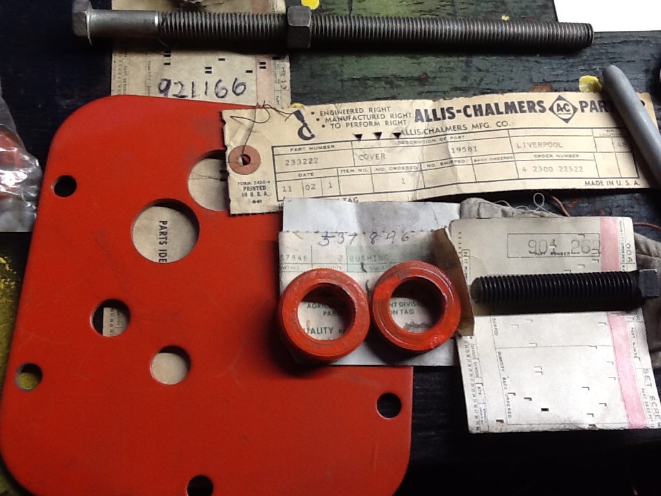

Hi everyone
Have some more stuff for you to school me on
First is this cover, it looks familiar to me but the number isn't in my book here tag has part number 232222
sorry I took the picture the other day with the bushings sitting in it.

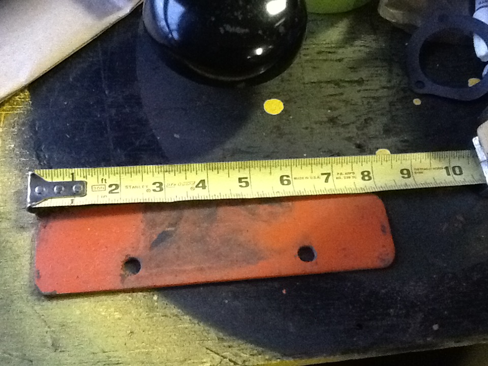

Second is long shot. It's about 1/8" thick X 8-1/16" long X 2-1/16 tall holes are 3/8s. and 3-7/8" apart and 2-1/8 in from ends
Thanks

D14/15 transmission side cover for one with oil cooler?  Dale

Thanks dale, that's what it looked like to us

Second picture is spacer under PTO Shield D17.        MACK

Thanks Mack. What's the reason to space the pto shield.

Don't know.

May be for top link bracket geometry, bracket that attaches in front below the seat and runs under the seat frame mounting and down.
I say that because I have two D15's that had that type of plate behind the lower bracket mounting and both had longer studs (3-hole bracket).
Three other D15's I have with OEM top link bracket did not have the added plate and used the original studs length in single hole brackets.

Hey Tim your on to something. Came across a page in d15 parts book. Does any of you nos guys have this 332339 an see if it looks like this one.
Thanks
