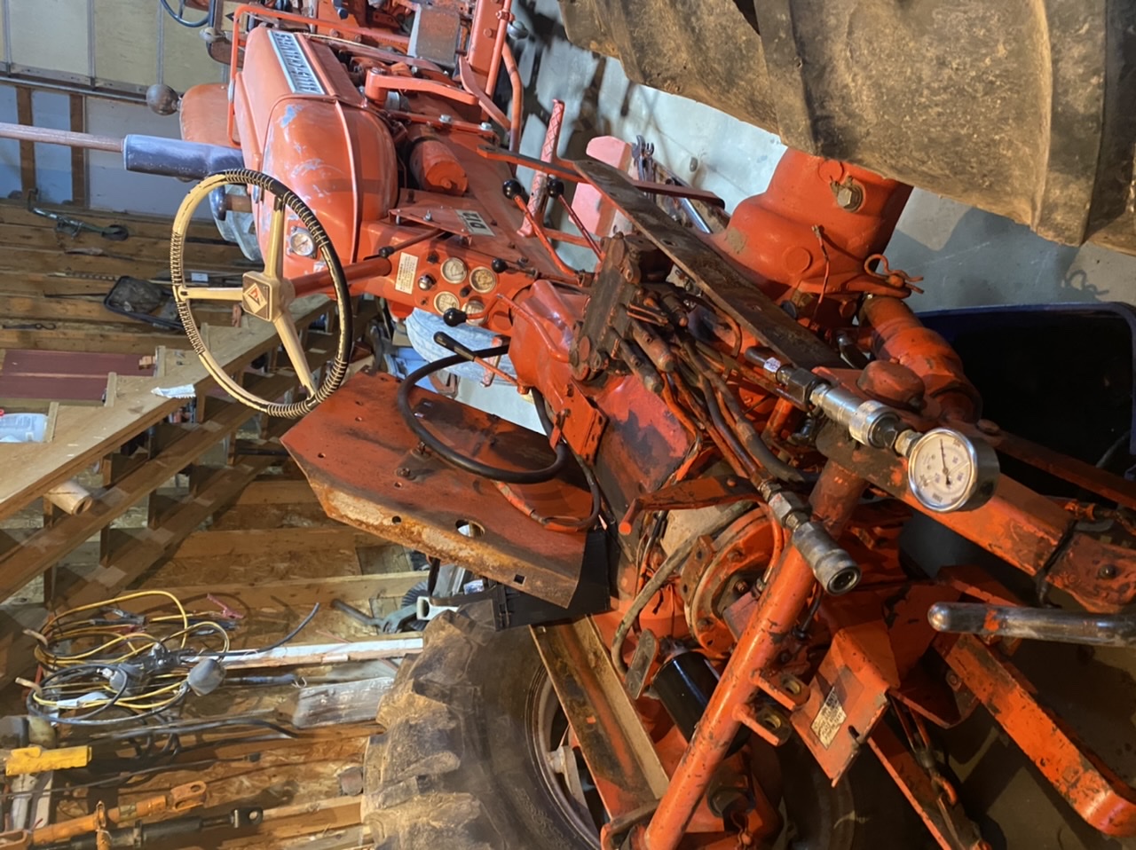

I’m having the same problem. Everything was fine, was discing with 3pt disc then out of nowhere hydraulics wouldn’t lift disc out of ground. Had pump off and it checked out good. Fluid and filter are new. Swapped relief valves with a used one. Checked and lubed traction booster linkage. Can only get 200 psi at remote. Any ideas?

Well, a good pump and a good relief valve will yield a good hydraulic system that will lift a load. So, either your pump is bad or relief valve is bad. Nothing else. You say the pump "looked" good, but that in itself is not much of a test of the pumps performance. Relief valve has to have a good pump to test it for pressure settings. You don't have a "flow-rater" to test the pump. I could connect your pressure gauge directly to the pumps outlet ( dead-heading/ahead of the relief valve) and using the starter (with the coil wire unplugged) carefully crank the engine in short bursts to determine what, if any pressure the pump can actually make. Not a perfect test, but at least something. If that pump can make say 1,000 psi with the starter, which isn't as fast as the engine running, that's more than the 200 psi you say you have at the remote outlet. That would point the finger at the relief valve.    EDIT:  You blow up your hyd pump, it's on you, not me.

Got it. Have you ever tried the deadhead test? I have read posts that the traction booster system can be a culprit also. What gets me is the system was fine, no issues then just got lazy. 2nd is the pump was pulled apart at a hydraulic shop by the owner and he said everything looked good.

Never had to dead-head test a pump. I've got the tooling to properly test it. But, in a pinch I do a lot of things not according to the book. If your valve stack has TWO relief valves ( right rear corner and left front corner) swap their position. This of course assumes one of them is still good. I can see the one at the right rear corner.
