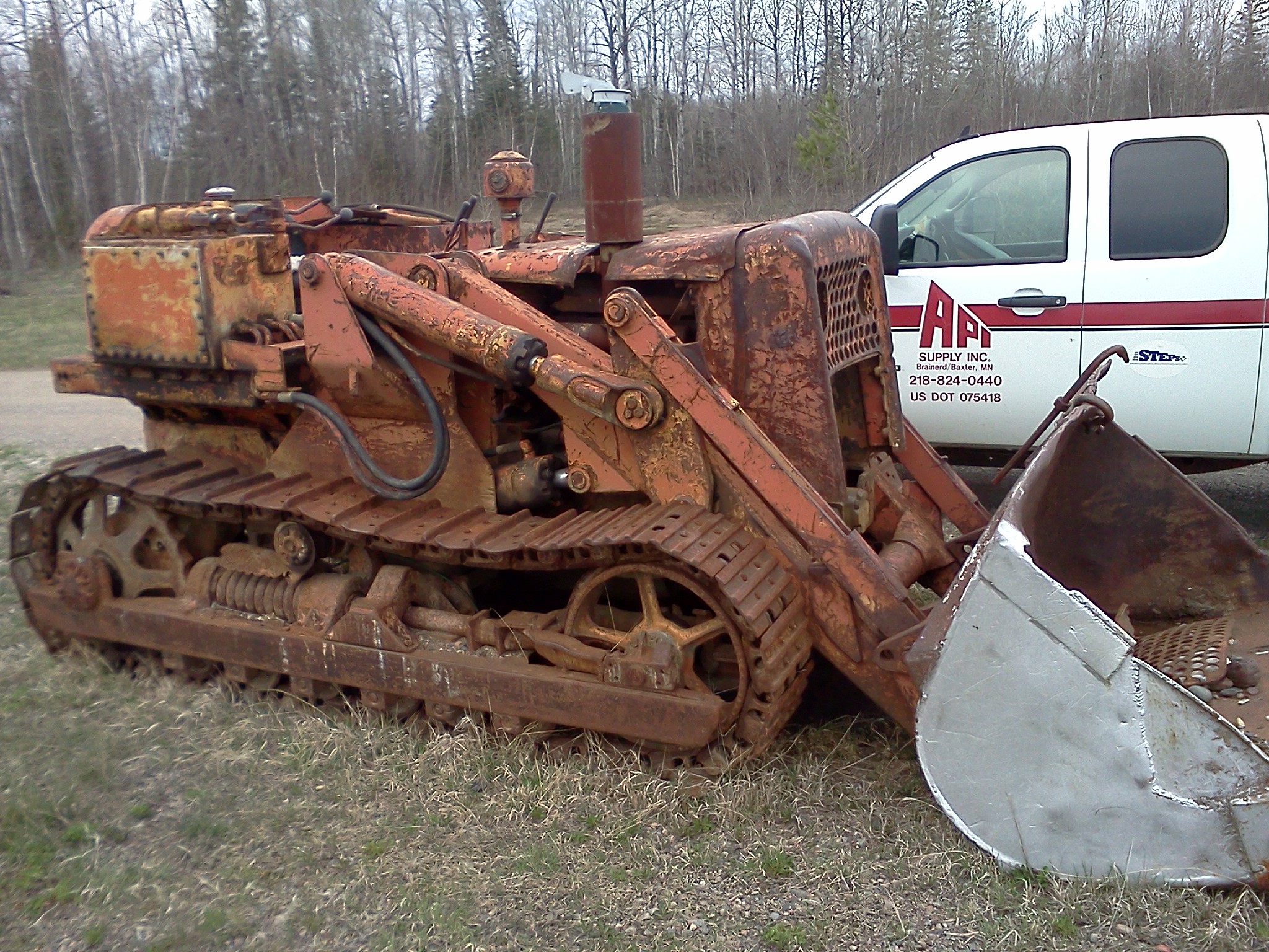

Some pictures of the old girl.
First picture: Found her in a gravel pit south of Hibbing Minn. 1 1/2 years later, doing some work done by the river thaks to this forum and alot of good advise.

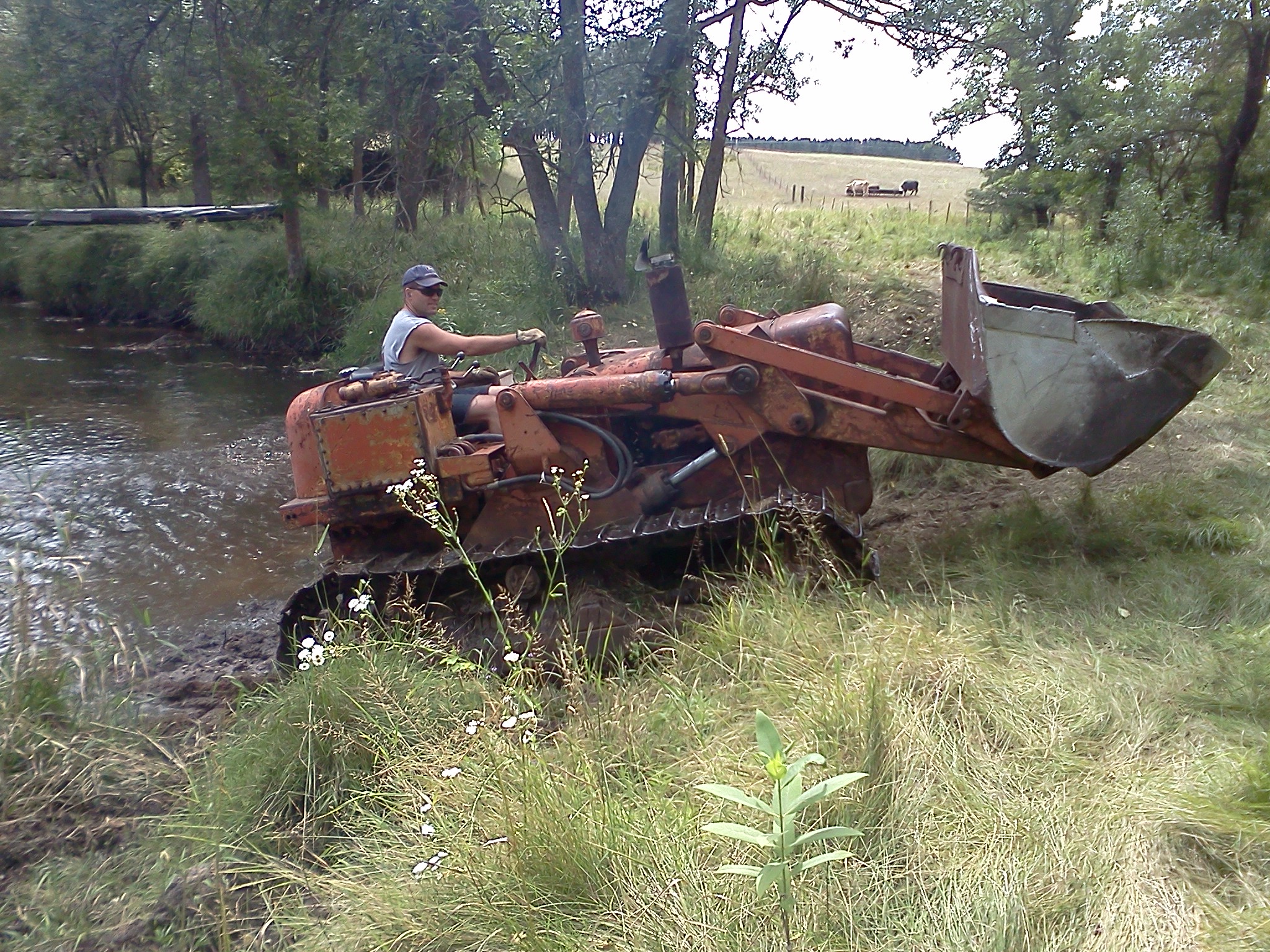

Remember if working by lake or stream not to touch the water . Also watch no one looks to close the stupid thing of silt fence around area to prevent runoff is another big pain.
 Are single grouser - dozer track so be careful on the sharp turns or spinning a 180 .

my dads 6g when it was about 10  years old when the dirt business slowed he did dimolition it took 2 story brick building with it.

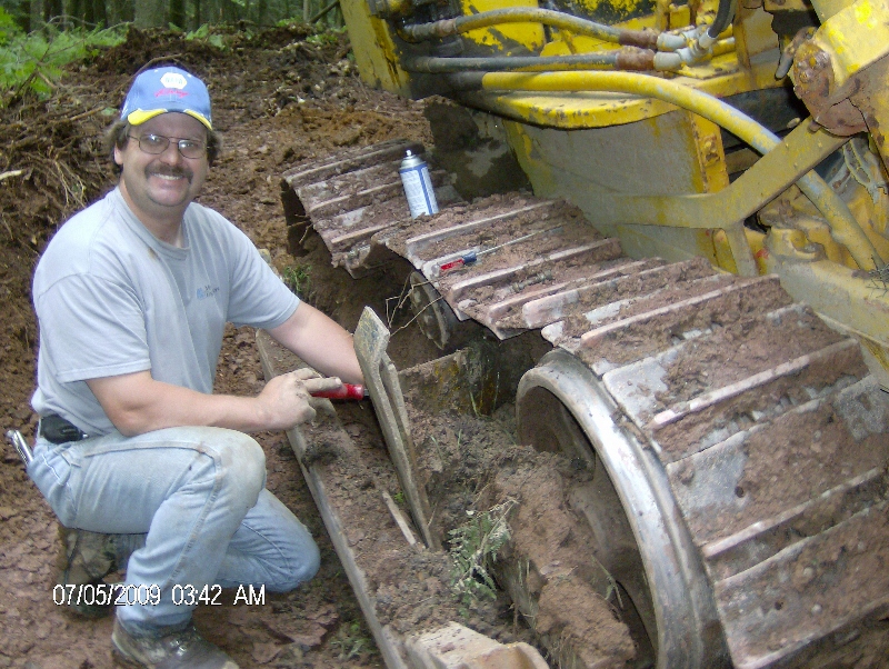

is your track off as bad as this? mine is an hd5 with screw adjusters. i had once where the pins that keep the shims that the idler rides on wore and came down far enough to not allow more adjustment but have not had your issue. good luck.

I hopefully will have some time this weekend to give digging the pond a shot again. Perhaps running a skidloader for years has spoiled me. Smaller bits a slow down, got it. If I have succuess I'll try get some pictures.

Hate when that hapens but it seems that is part of having a old machine or saying I will adjust the track next time . Seems every machine I have had I walked out of a track at one time or another . After whle you just get use to putting it back on be it with come-along, tanker bar, or lot of tools.
 Keeping up o nthe adjustments helps but also watching the load on the tracks, to try not to get into position where you do walk out of it or catch it so you can sometimes revers and get it back on .
