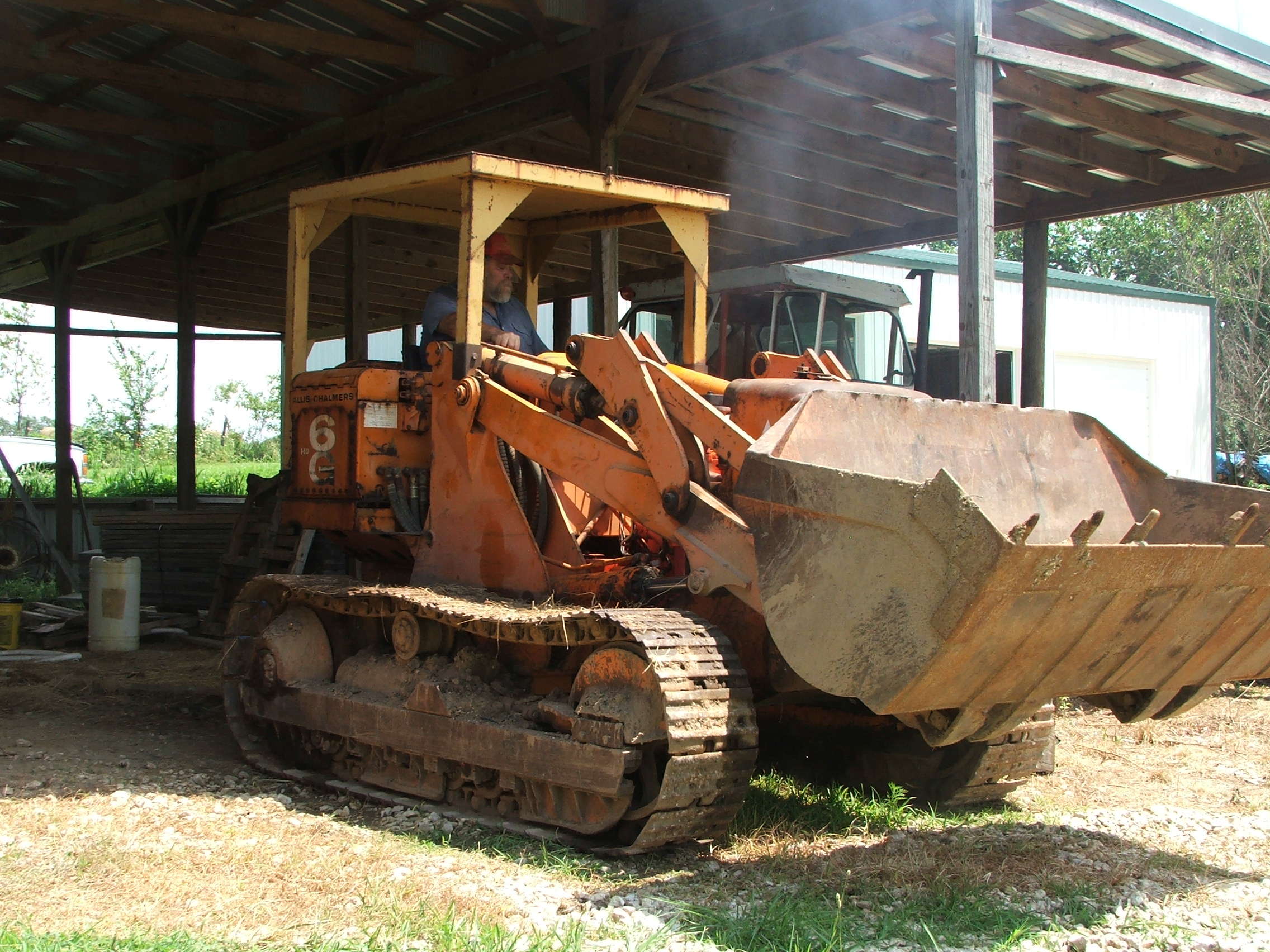

Greetings to all whom have read my messages for help , many thanks for your input. We installed the engine and it runs great. Had to change the cam gear and transferred  the front end parts to allow use of the oil clutch motor and the original injection pump. A lot  of work but  I t hink it was worth the effort . The turbo works fine, 60+psi oil pressure, 13psi fuel pressure .If our  unit was a dozer we would not have had to make so many changes.  I've tried to upload  three pictures, I hope they are there when I post this message. Thanks again to all. Superchief. uploads/4827/AC_7000_series_engine_conuploads/4827/AC_7000_series_engine_conversion_&_installation_043.jpgversion_&_installation_035.jpg

Good looking loader. looks ready to work. thanks for the pictures.  Danny
