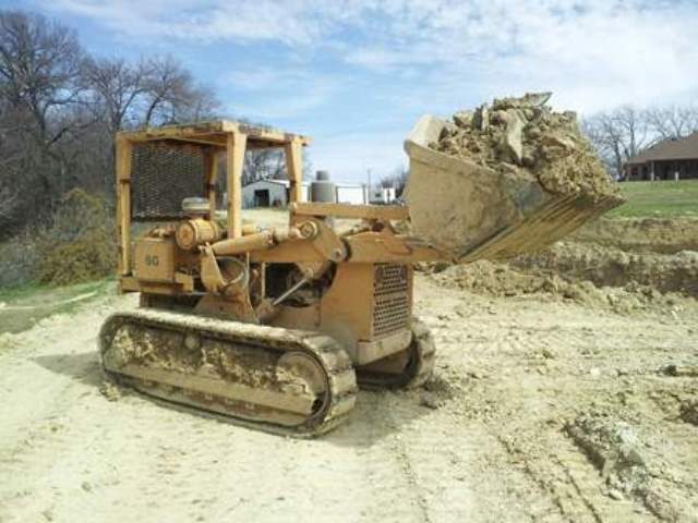

Post Options Post Options   Thanks (0) Thanks(0)   Quote Silencer223 Quote  Post ReplyReply Direct Link To This Post Posted: 07 Mar 2016 at 5:30pm
Well here she is gentlemen. An HD6G repowered with a 7000 engine. I have been digging with her for about a month now. Awesome engine swap.Thanks for the help.

Post Options Post Options   Thanks (0) Thanks(0)   Quote Dozer Quote  Post ReplyReply Direct Link To This Post Posted: 08 Mar 2016 at 7:32am
Great accomplishment. Are you driving the fan and generator from the crankshaft or the injector pump?

Post Options Post Options   Thanks (0) Thanks(0)   Quote Silencer223 Quote  Post ReplyReply Direct Link To This Post Posted: 25 Mar 2016 at 10:43pm
Drive the fan from the crankshaft. Early HD6 drove them that way and it will also drive the Hydrilic pump. Flip your belt tensioner 180 deg and rebolt on. You will still use your original 344 top pully and mounting bracket so your generator will work. I used a 24 volt alternator so I modified my bracket. I went with A@I belts and used the smaller length belt to make my adjuster stroke length the shortest it could be. I can send you those numbers so you won't get the wrong belts twice like I did. As for the lower pully I just did a Google search for the part number and one popped up in Pa. I think I paid $150 for it but it solved all my issues. And I really like the Roosa master pump. I just went to the auto parts store and bought an inline adapter for a common spin on caterpillar fuel filter and bolted it to the plate that the double fuel filters bolt to. Simple setup. No fuel pump needed.
