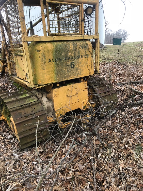

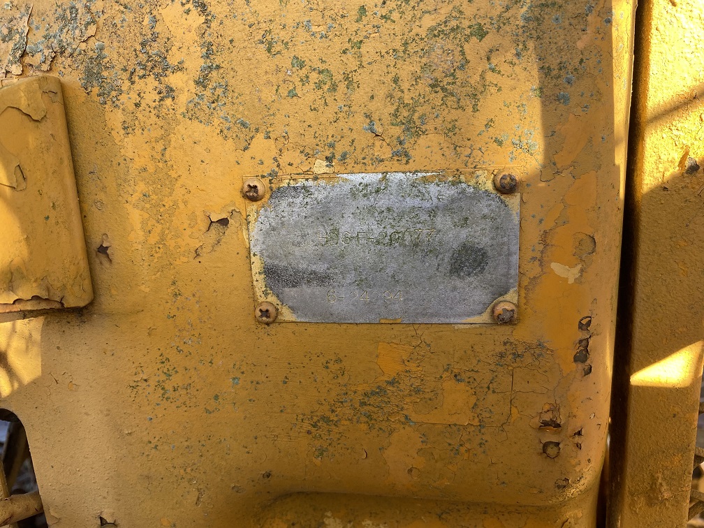

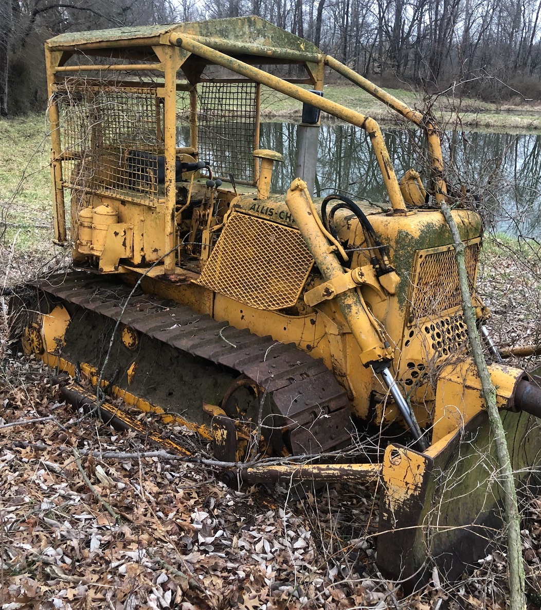

I just purchased this HD6E serial number 20077. The previous owner was going to scrap it and I thought it still had life in it so I told him I would take it. The story is it ran when parked 6 years ago and the only known problem was the radiator had a leak. My goal is to try and get it running and use it for some projects around the farm and possibly restore at some point. I have no idea where to start with getting it running after sitting for so long. Any advice or words of wisdom would be much appreciated.
