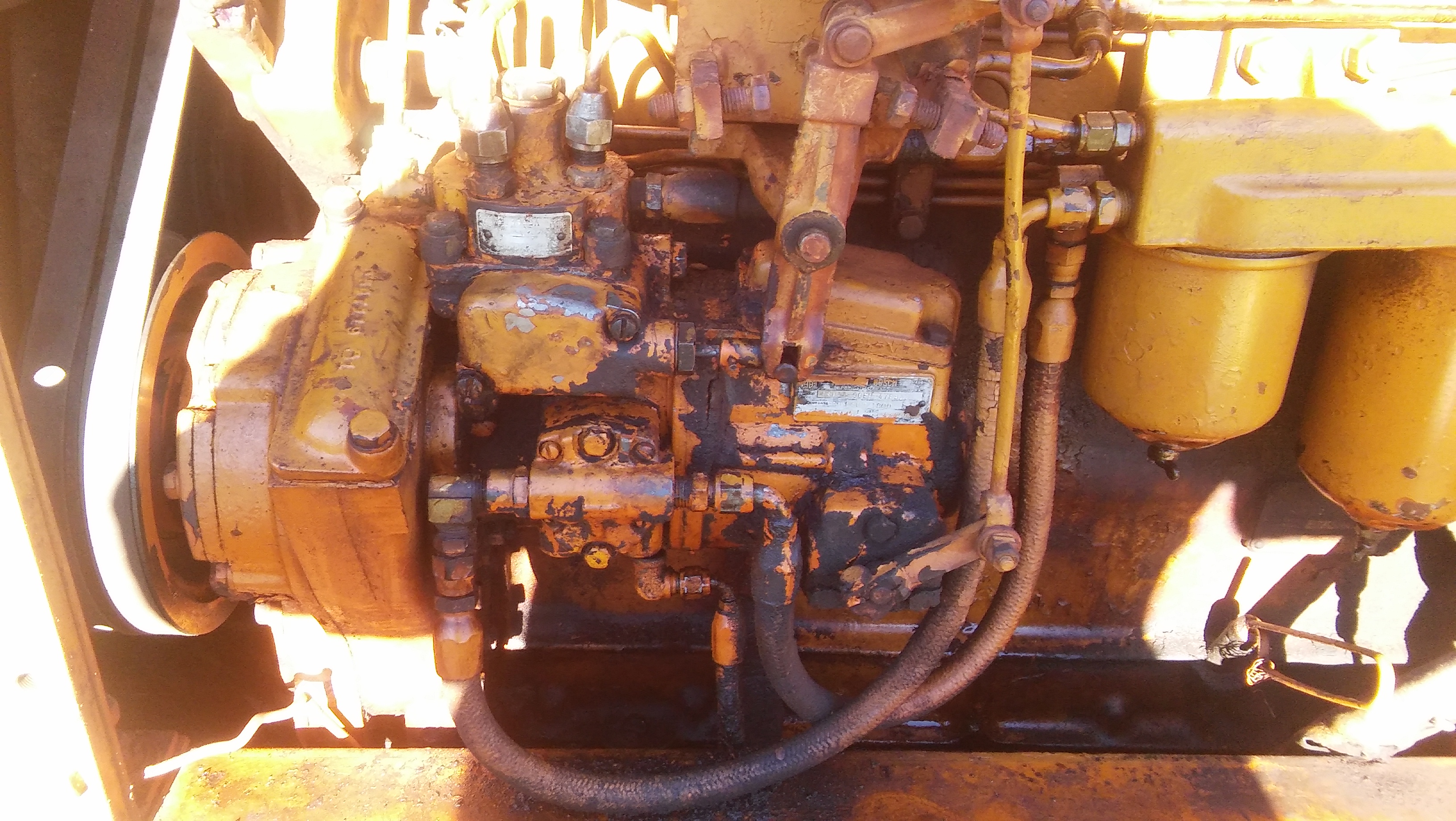

Is the pump timed with the engine? Also..it sat up for 2 yrs..we can get fuel out of the everywhere except the top 4 lines..the single line to the injectors has pressure on it as you spin the motor but no fuel at all from T the top 4..Would the pump need rebuilding and if so..where can I send it to be built?

Terry, Yes the pump is timed to the engine.Any chance you could post a picture? The PSB pump that was common on those was very temperamental. If they sit very long and you hit the starter, things can break?  Any other history? Tractor serial number?

HD6B 11474 is the serial number on this dozer..it sat for 2 yrs and previous owner couldn't get it to crank so I bought it..I'm thinking this pump is bad but its getting fuel through the 1 line to the injectors but no fuel out the 4 lines on top to the injectors.W

You could try to check the transfer pump section, is the unit with two lines at bottom of photo, put the output line into a can and crank the engine see if it works at all.
Is a typical PSB injection pump and few shops will work them anymore.

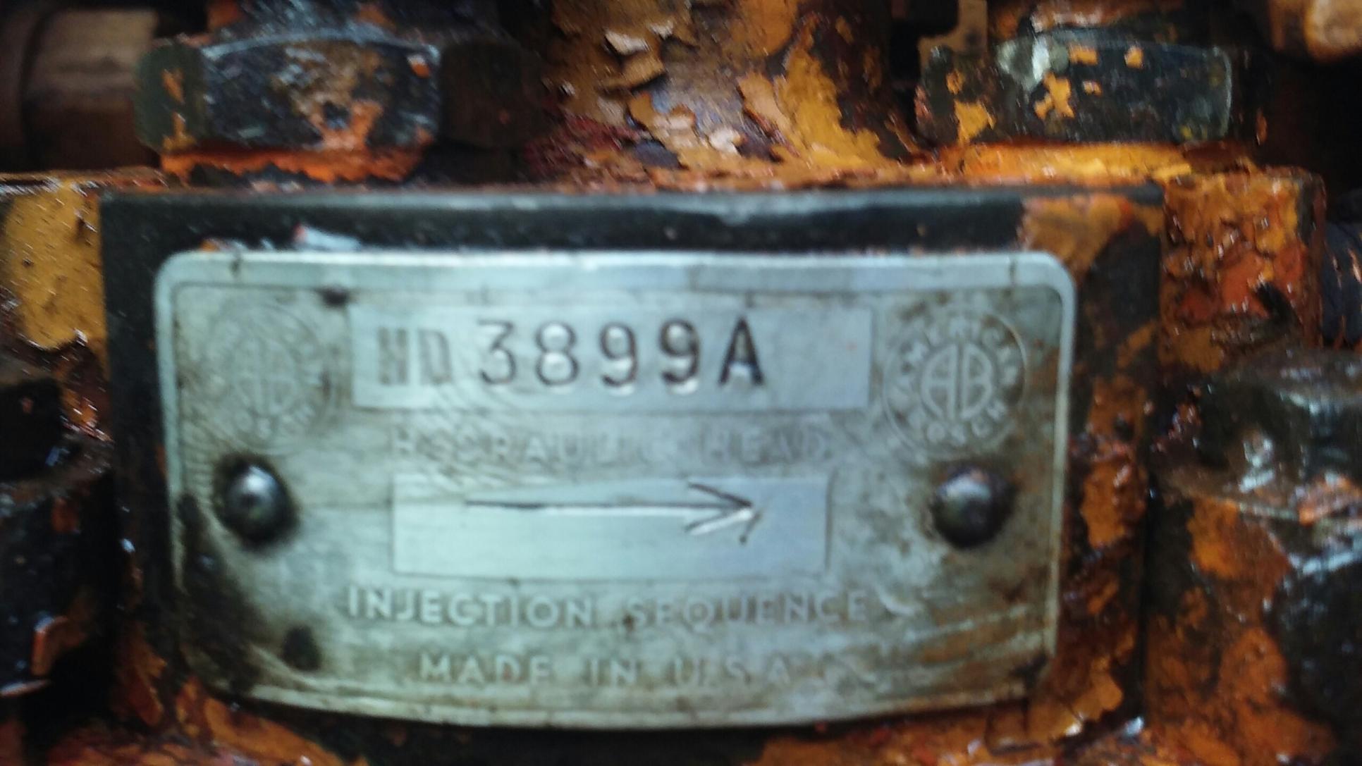

I need this head for my pump.

There is a nut on the side off the hydraulic head on the PSB pump ,undo it and make sure the little spring inside is not broken or jammed .

I have 3 injection pumps PSB4A but only one have a tag on side head 59000 ar
Gemdozer
I understand that the "r" sufix says rebuilt
