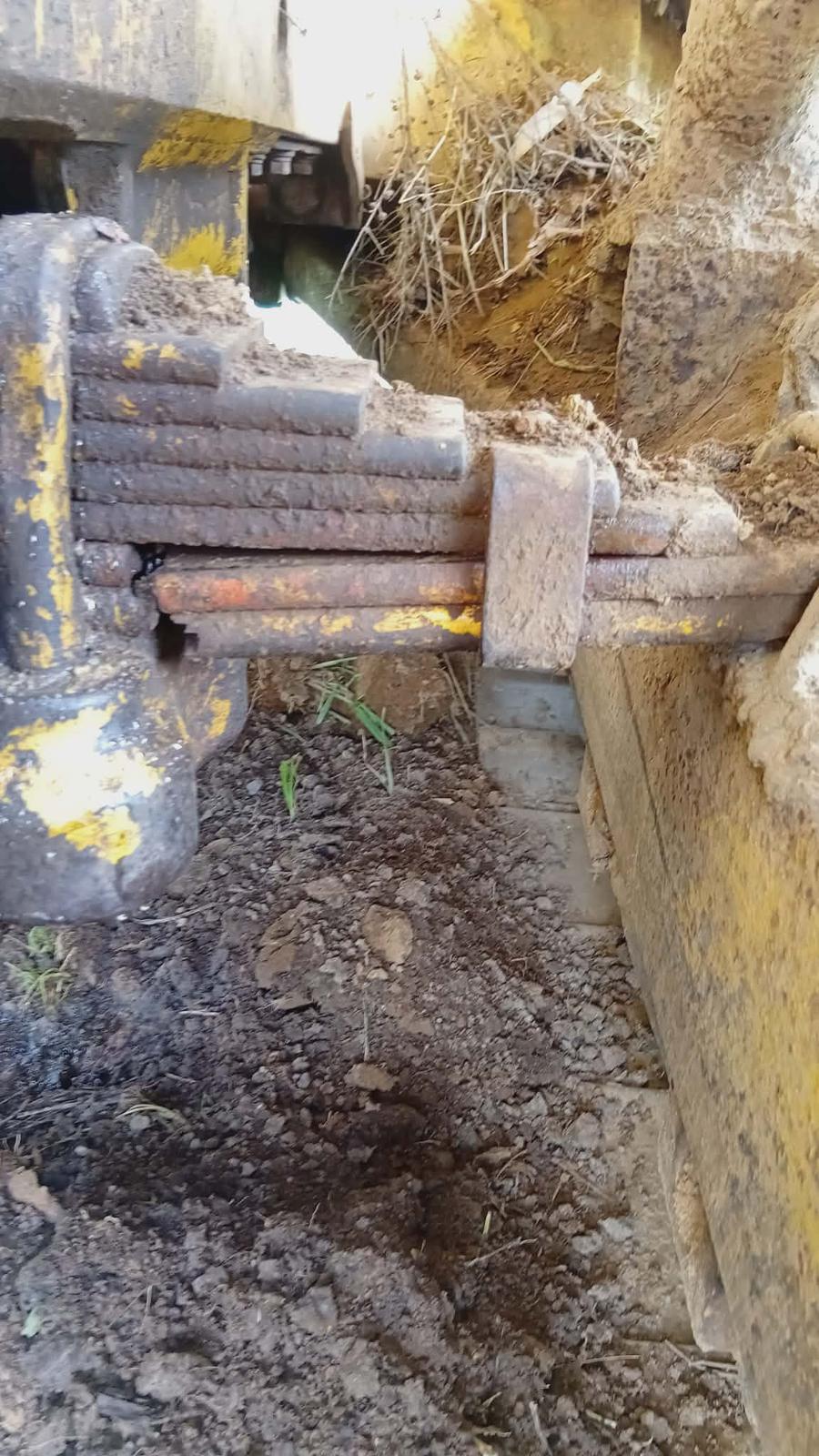

Hi All,
I've broken 2 leaf springs on my HD6, does anyone know if there is an aftermarket spring that can be purchased? I'm in New Zealand.
Is it possible to slide out the 2 broken ones and replace them without taking the whole leaf pack off? Any tips or tricks on the best way to do this would be appreciated.
Thanks in advance....

I have no idea of what is available in New Zealand, however around here there are many shops that make truck springs. If you have something like that, you could take the broken pieces to them and they could make new ones that match the size and curvature.

I assume they are a stack of leaf springs. If so, there is a center bolt that draws the whole stack of individual springs tight together in the center. No way to repair in-chassis.

Is this a dozer, loader, or just farm tractor. Loaders seemed to have more trouble than the others.  They just put a solid bar across later model loaders.
Neighbors bought a Cat D6 with broken spring, found an older model D6 to buy a spring from. It was a bit lighter, but being somewhat careful it never broke.
So if you know of any old parts machines even if not a HD 6 check them out. Might be close enough.

Thanks for your answers, I found a local company that will make me a new one. To clarify its an HD6 dozer that I have
