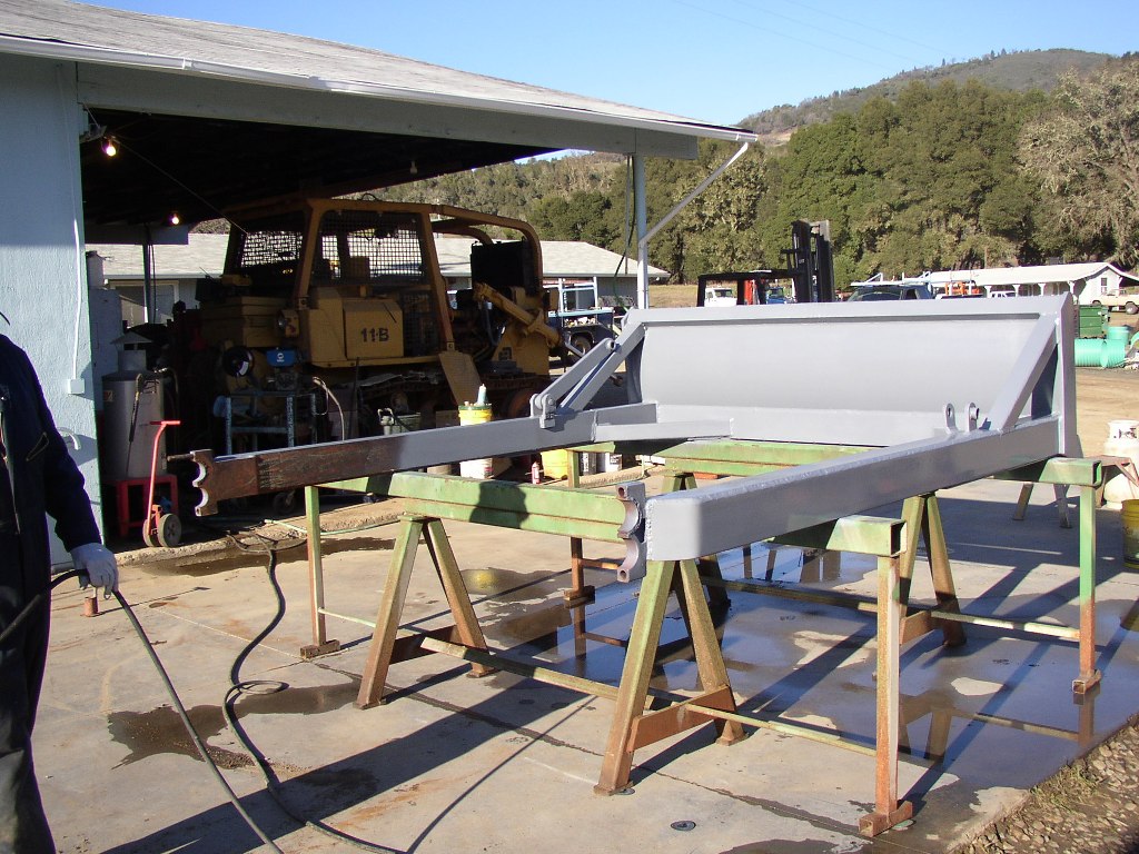

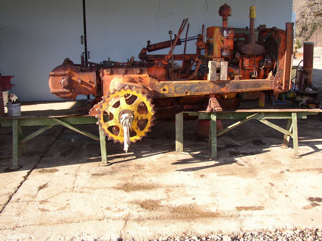

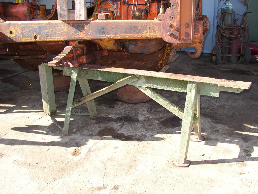

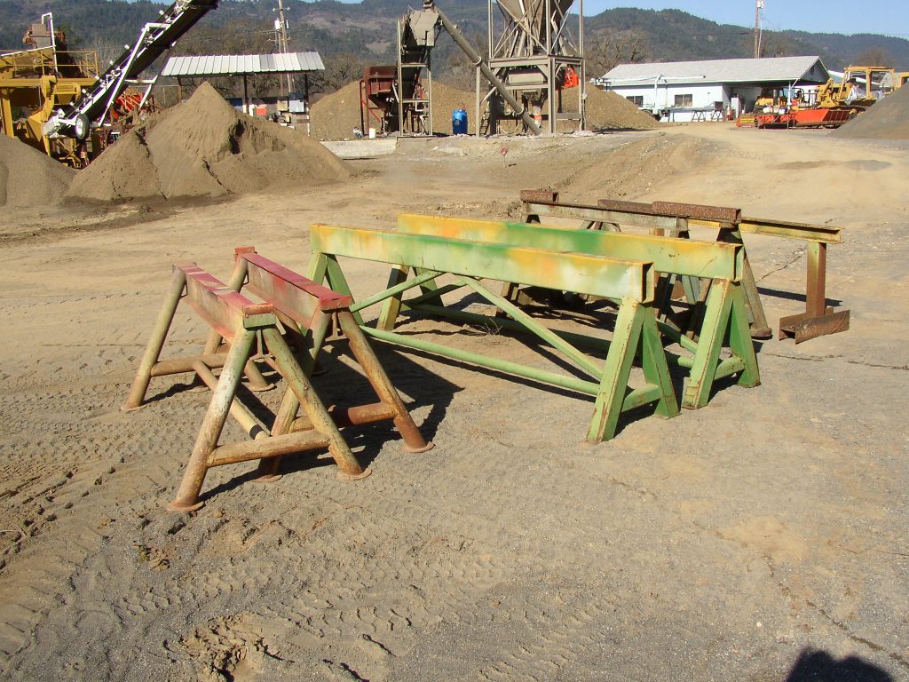

Orangeman- Here's a better picture of the steel saw horses holding the tractor up and some other options, also the long ones under the blade being painted. There are different heights and lengths (our problem is forgetting what piece of equipment we left them holding up the last time we used one)

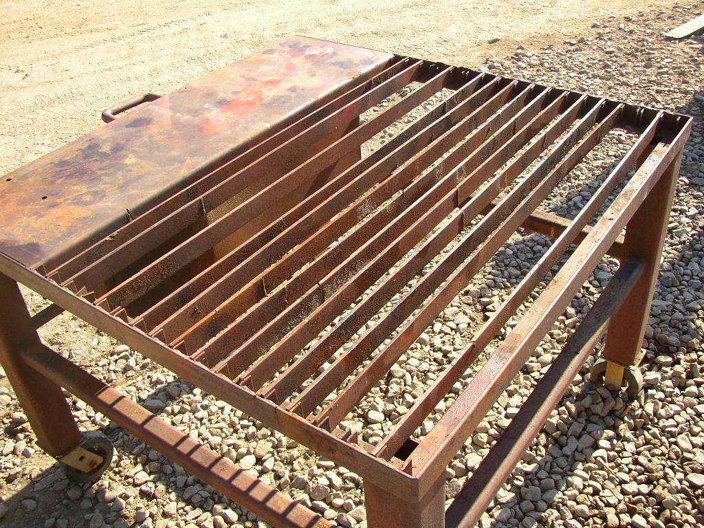

ERIC PA- The slatted table is just kind of a standard cutting torch table. You can make your own, 1/4'' x whatever flatbar 1-1/4'', 1-1/2'' etc. cut across them with the torch,turn them over, replace, etc.
