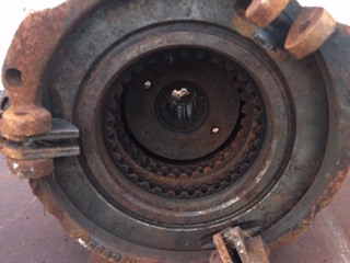

Reverser looks like this I hope
HD3

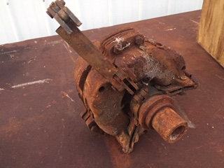

Post Options Post Options   Thanks (0) Thanks(0)   Quote NomoreJohnDeere Quote  Post ReplyReply Direct Link To This Post Posted: 12 Jun 2019 at 9:41pm
HD3
