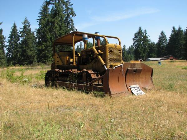

I just bought AC HD21A wont steer left or right Runs good moves back and forth ok just wont turn thought I would check with the pros ??
Have the manual the former owner said they tried to bleed the hydraulic control valve the machine is a hundred miles away so im trying to get all my ducks in a row before I go back up their
