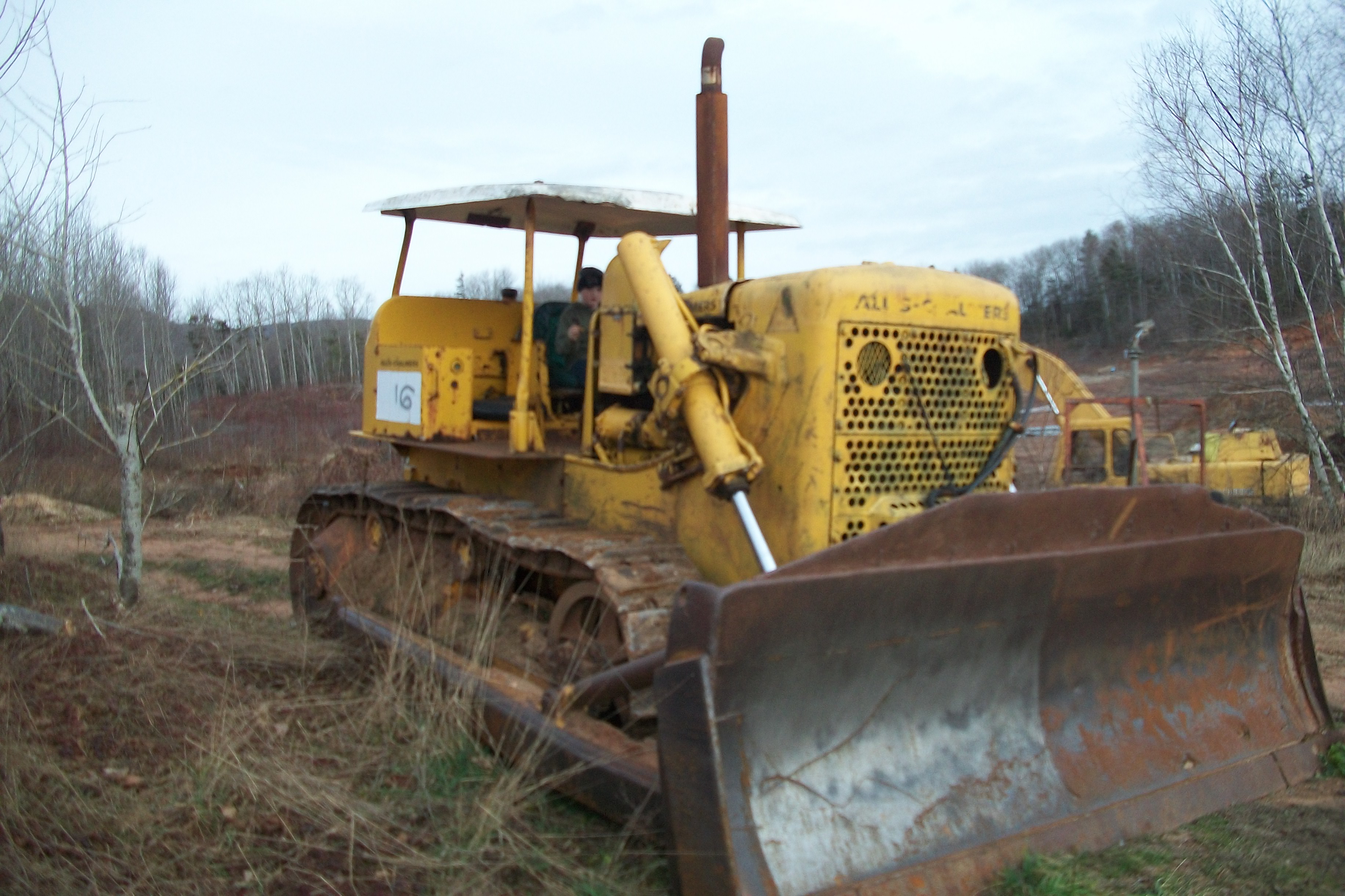

Looks like you have an operator already!

Yes, the operator looks like he's ready to push some dirt.

THE NEW OPERATOR IS MY GRANDSON. I THINK HE LIKES THE POWER SHIFT.
