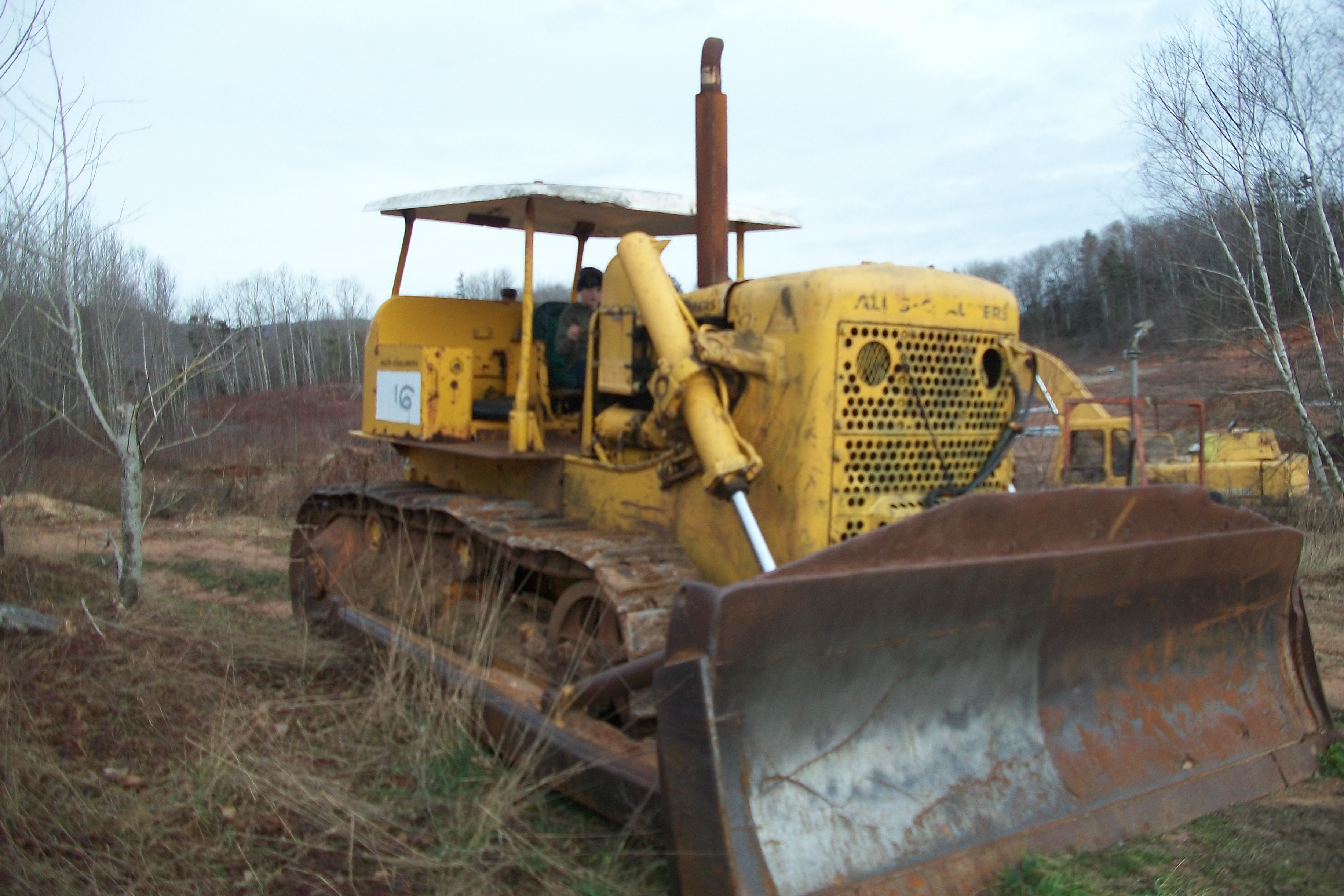

I JUST PURCHASED A HD16DP SERIAL# 8029. THE TAG ON ENGINE READS 16000H. THE MAN I PURCHASED IT FROM SAYS IT HAD A TURBO AND THE EXHAUST MANAFOLD LOOKS LIKE ONE FOR A TURBO. NORMS BIBLE NO TURBO ON 16000H.DID THE TURBO COME OUT BEFORE THE 16B IN THE 1970S OR HAS SOMEONE BEEN DOING SOME ADAPTING?

Looks like you have an operator already!

Yes, the operator looks like he's ready to push some dirt.

THE NEW OPERATOR IS MY GRANDSON. I THINK HE LIKES THE POWER SHIFT.
