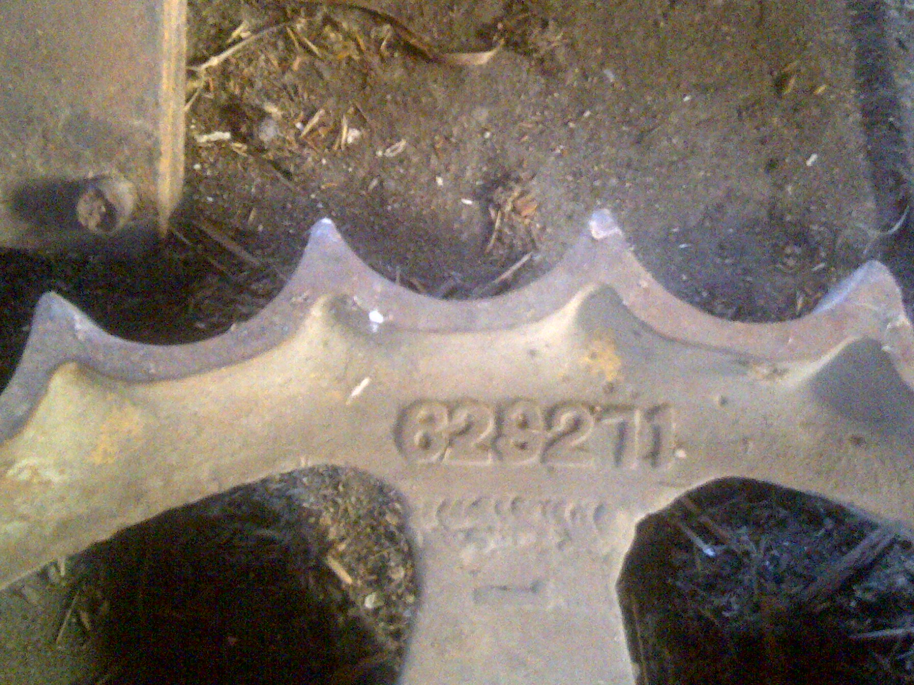

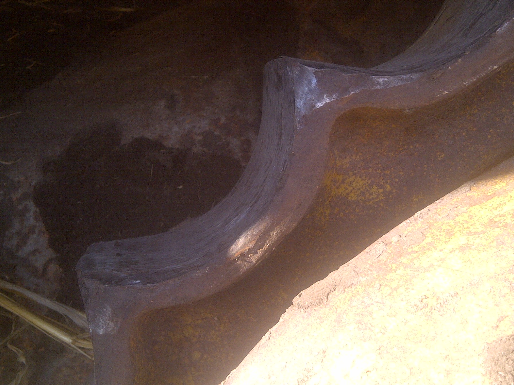

Many sprockets in that shape have been built back up with weld using 350 grade surfacing rods with the sprockets still on the tractor. Just bear in mind, when tracks get to that stage of wear, its time to reset the preload on the tapered roller bearings in the final drives. The owners that dont do that are always the ones that have final drive problems, then complain that the finals in their tractor are weak in design

I apoligize for the pics I couldn't make them smaller....
The first one is one of the used pair I have and the 2nd one is the current ones on it. Would anyone use the used pair vs buying new?

always remember the reason the sprockets are worn is because the track chain pitch is stretched; ie worn pins and bushes. I,ll second what mac said about rebuilding sprockets with 350 hardfacing rods. Helps immensly if you have a template of a new sprocket tooth to help show you where to build them up. Is easier to do with track off; but i have done it in place on my D4D. Pins were actually worn through some of the bushes on my tractor. But just built up the sprockets with weld to keep it going for another 500hrs till i got new chains and sprockets for her. I just did it in the field with a lincoln 225 weldanpower, petrol welder. took about a day a side. only really cost rods, petrol and beer to replace the lost sweat !
