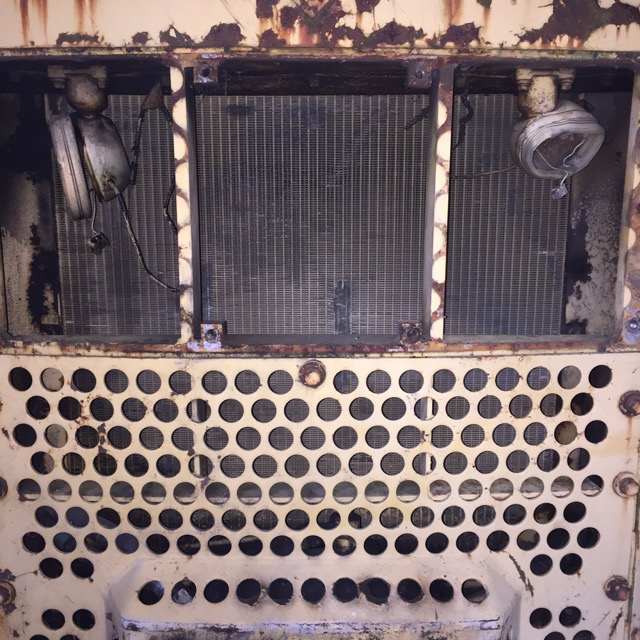

I have somewhat abused the forum by posting pics randomly for a specific question to be answered or advise requested. Taking my lead from some of you whom have done extensive renovations and repair, this will be my one topic to show some before and after pics. I am humbled by ACMEL and his work and that of Rick, Cal, D Miller, Coke, Shameless and Morten to name just a few of you whom have posted some very nice work on restoring and saving this old iron. Most of what I have are the before pics and some piece work as up till now, I have been working on the basic mechanics of my baby. Filters, fluids, hoses, wiring, greasing, flushing and cleaning. To look at the outside nothing has changed so far but my girl purrs nicely. I have a few pics of pieces of equipment taking off and cleaned up like grill, lights, brackets, track adjusters, air cleaner, and floor plates as I can take them off and do them in my heated barn as opposed to the big barn the tractor sleeps in which is dirt floor and airy to say the least. It is however dry and thats good.

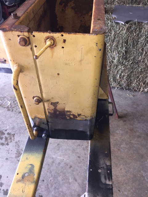

After pics will come over as I get them. Just got my battery boxes cleaned up, cut out all the rusted metal and welded back up. Solid and level. Pretty happy with them. floor plates all sanded and grounded, nuts bolts replaced and ready for paint.

Now that's starting out good. I like the idea that in the off season you're doing a few pieces at a time. That way you don't feel overwhelmed. It looks like a good machine to begin with. Thanks for posting. Eat your heart out Mel. LOL

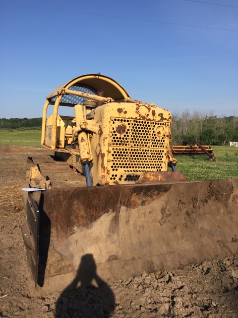

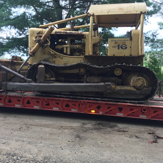

I don't have a cutting torch but i am going to borrow a K12 gas saw with a metal cutting blade on it to see if I can cut those blade wings off. They did a great job putting them on but I don't like the look. The pics of her outside is when I found her. had to load her on the low boy myself as the hauler didn't want to do it. Nailed it the first time. Tracks today are up to spec with 0 sag.

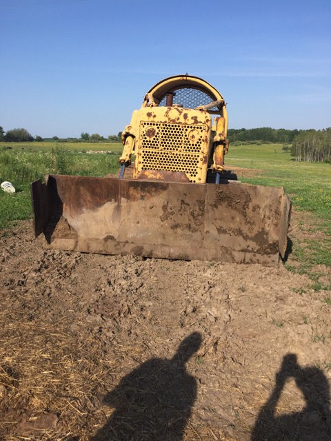

Battery boxes repaired and ready for total cleanup and prime. I will admit that I did not weld them by myself as I don't own a welder YET, however I cut out the bad metal, formed the new steel plates and then played with the welder on the inside of the boxes. They are rock solid and Im pleased with them. My plan will be do cut a piece of 2x12 to fit inside. The boxes in addition to being bolted to the bar that runs across the back from one side to the next, I will lag screw through the sides into the 2x12's for added support. I used 1/2" threaded rod and stainless nuts and washers for the battery hold downs, and will secure the 2x12's to the deck with the same stainless nuts and washers. Will be rock solid when done. also added pics for MORTEN on the side extensions that my blade came with.
