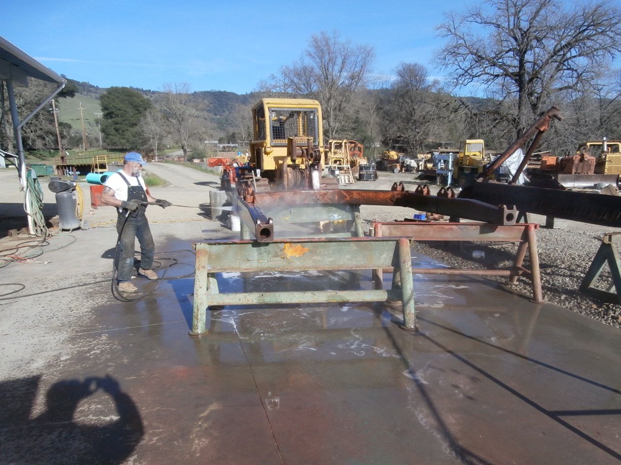

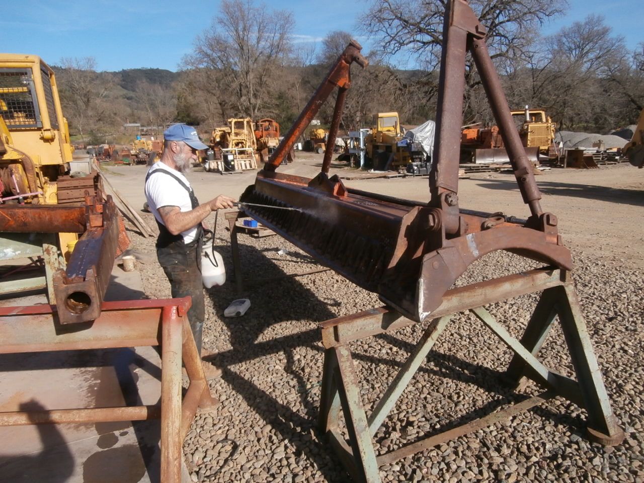

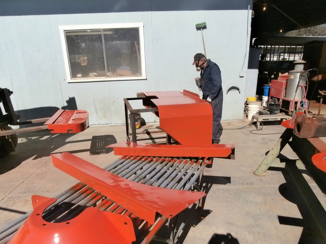

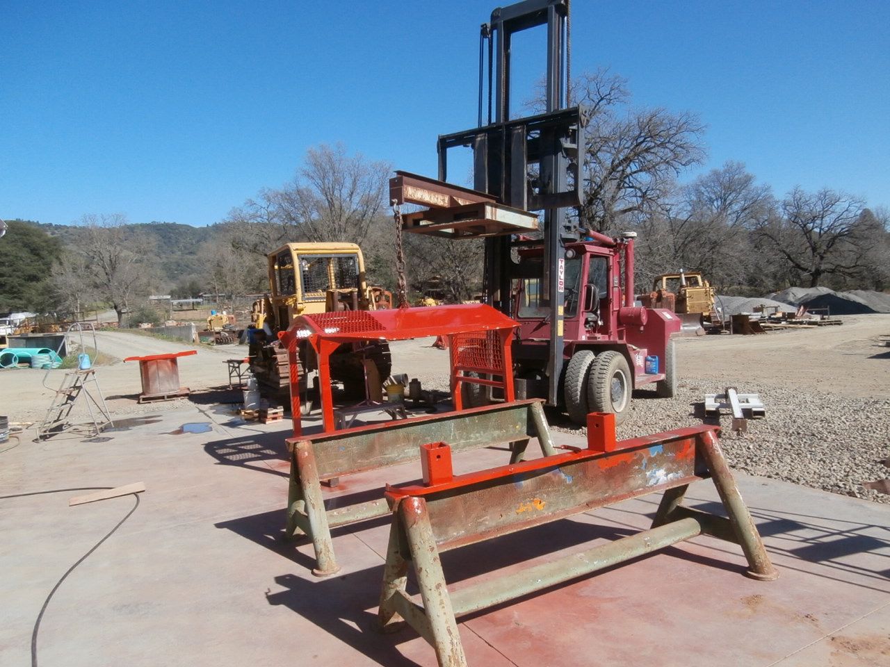

Painting has started with just a few pieces left to clean. Not all pieces were sand blasted. John use's some super clean  then pressure washer for some blade parts. Are goal here is to have this done in time to take to the antique equipment display at the Redwood Region Logging Conference to be held in Eureka, Ca. March 19-21 The tractor has some history of Redwood logging in Sonoma Co. Ca. in it's early days. We think we're on schedule to make it in time (kinda like some reality tv show that I can't stand to watch)   photo HD15 RESORATION 008_zpshzfhnhik.jpg
Most of these little parts had been sand blasted and primed
, some weren't

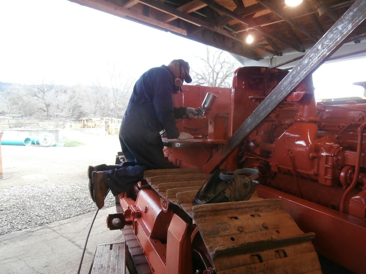

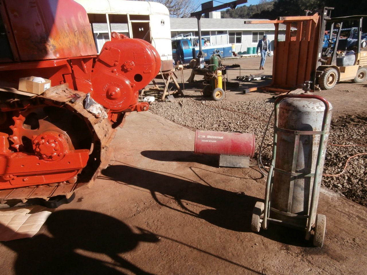

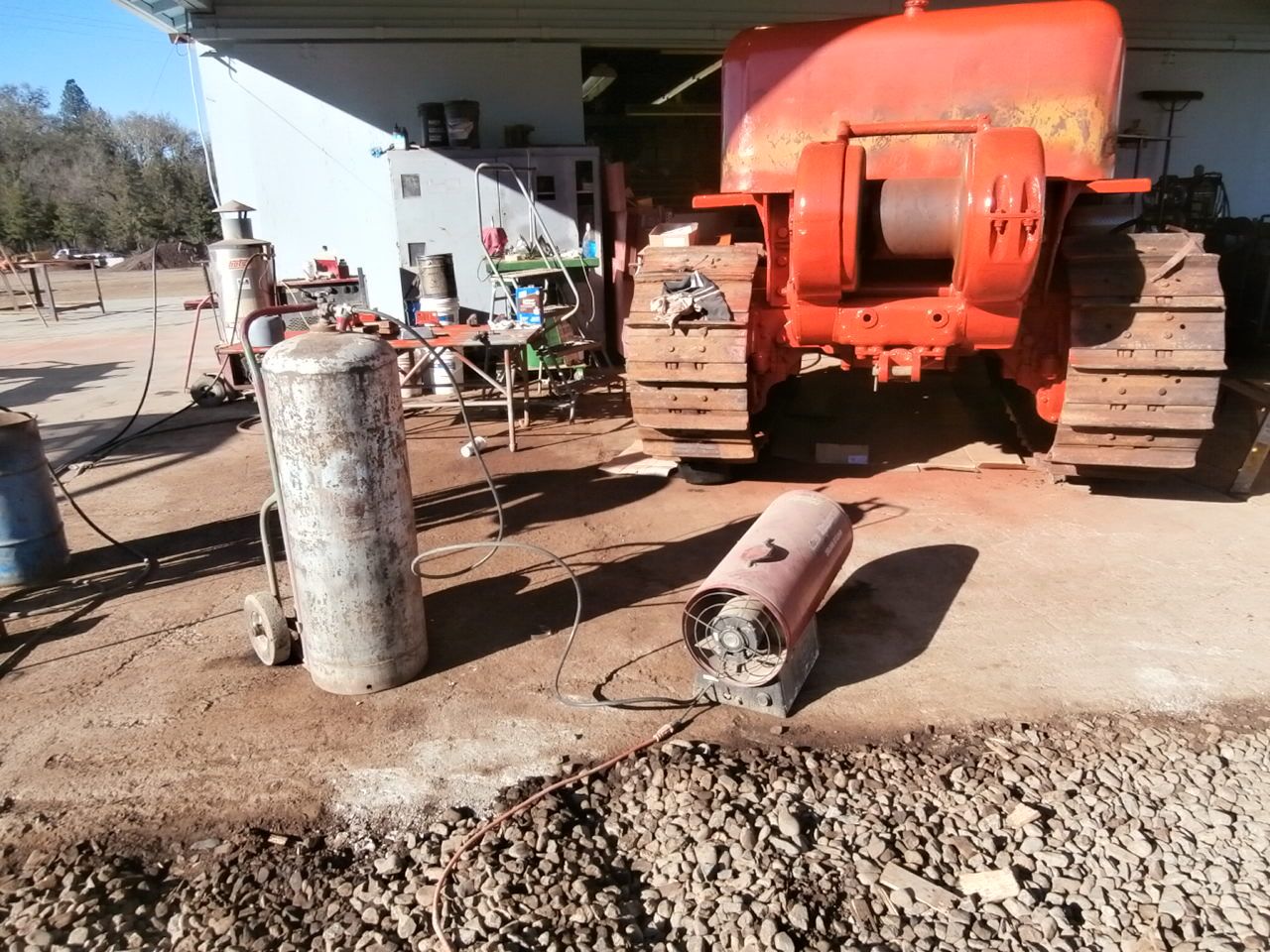

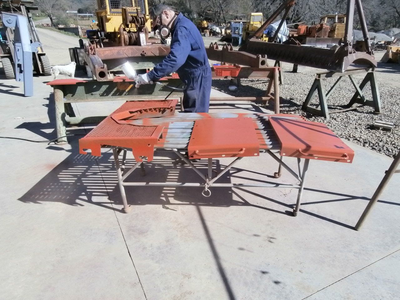

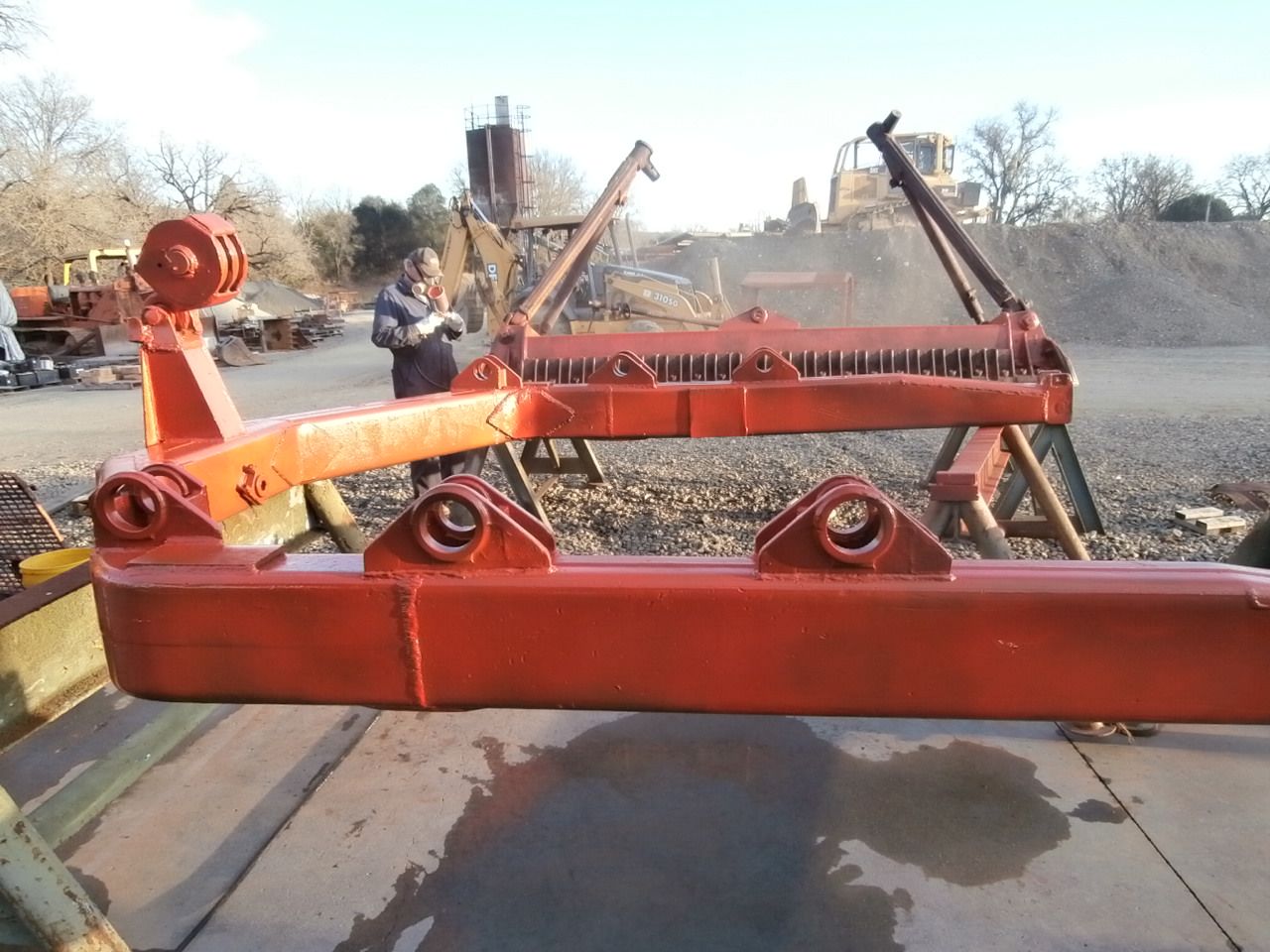

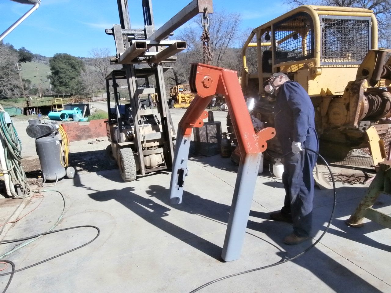

So even though we're in sunny California last Sunday morning it was 28 degrees which is not favorable to our outdoor organic paint booth. I did find all the pieces for the space heater. photo HD15 PAINTING 2 006_zps4dgedl10.jpg

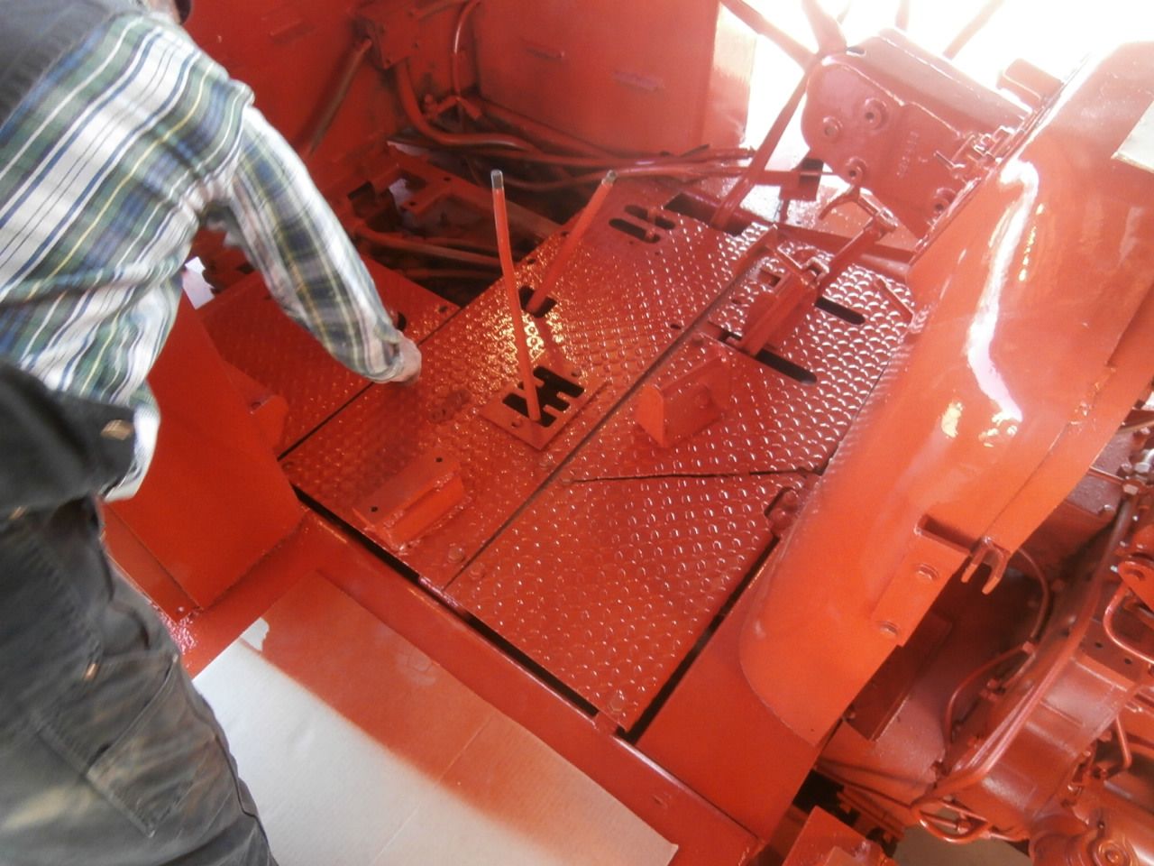

It got warm and toasty under  there, so David started there first photo HD15 PAINTING 2 004_zpsybjs8kv7.jpg

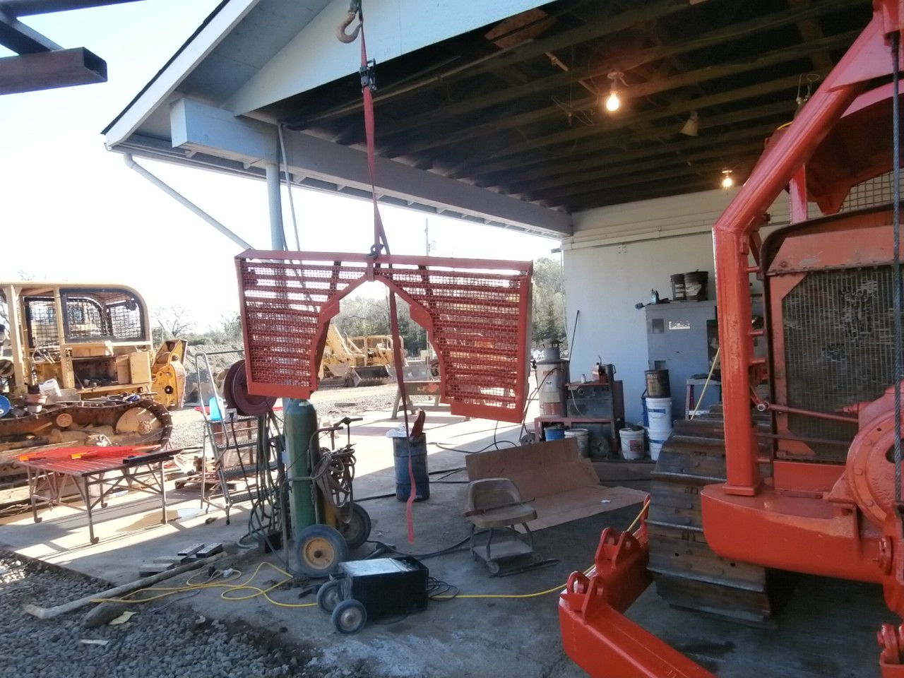

So there's still more painting to do but we started reassembly too. photo HD15 PAINTING 2 011_zpscxarhr8l.jpg
But there's a lot of orange showing now. photo HD15 PAINTING 2 019_zpsntpd9ukn.jpg

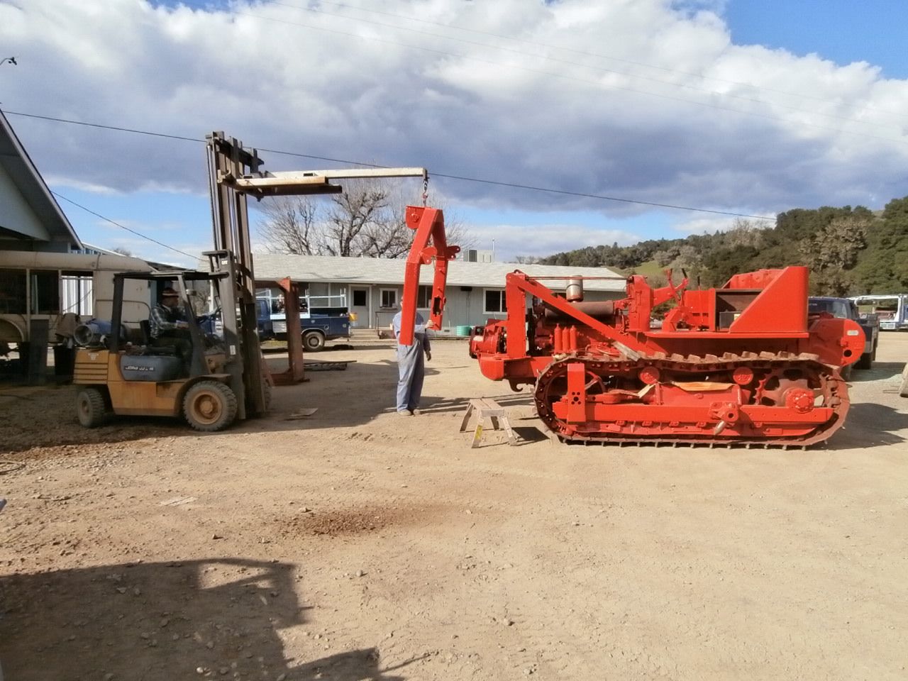

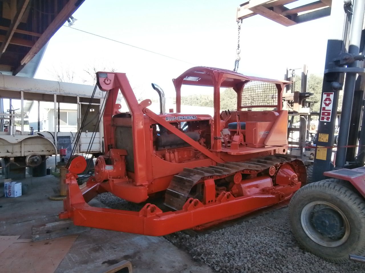

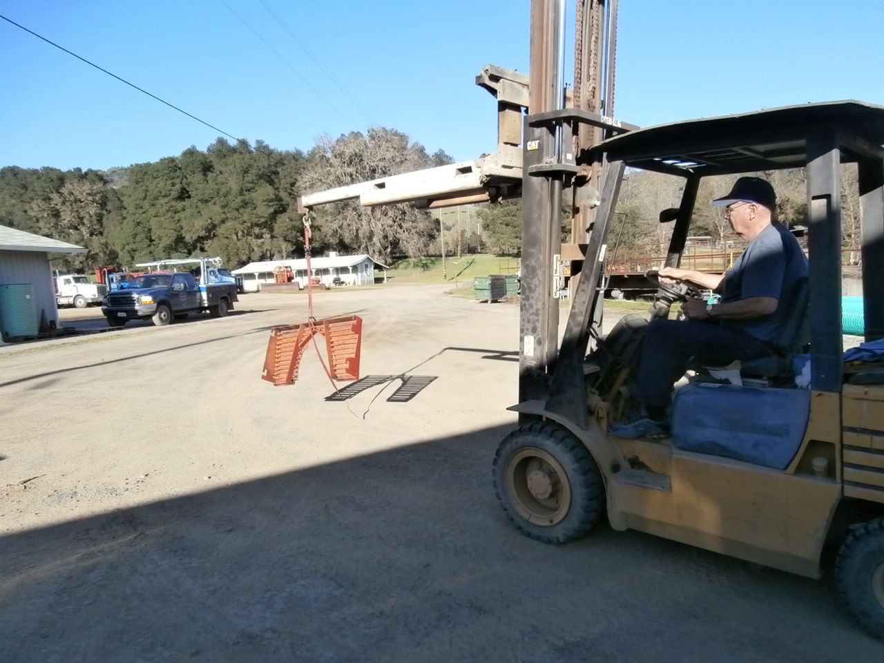

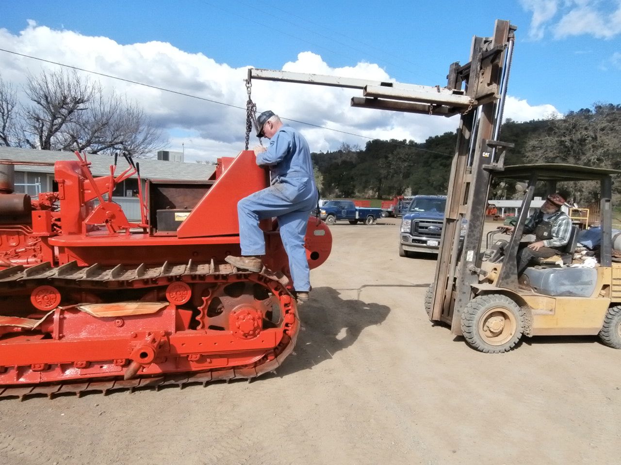

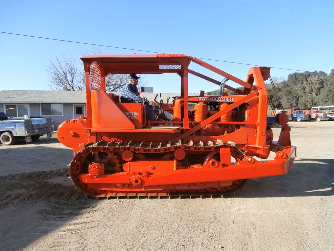

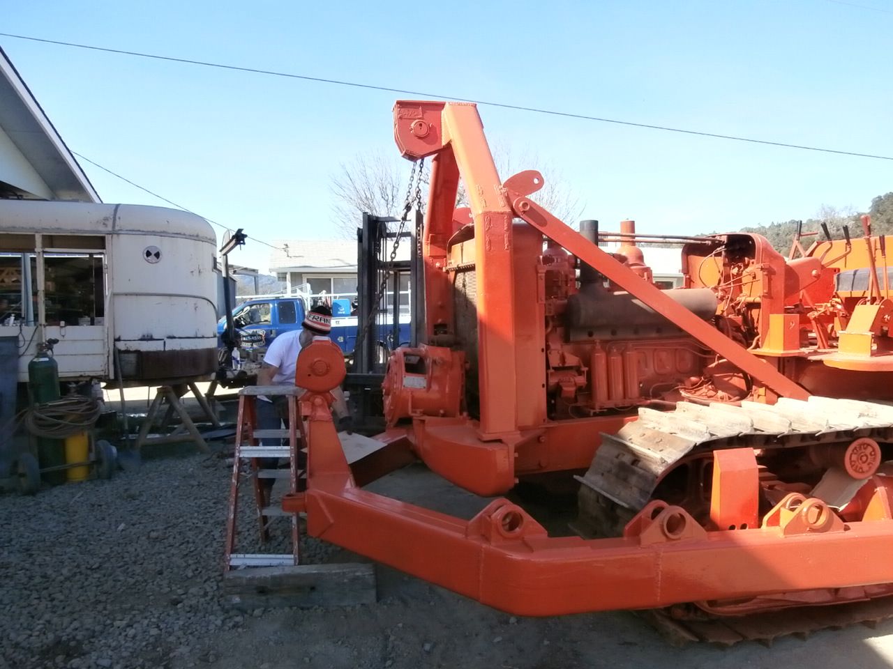

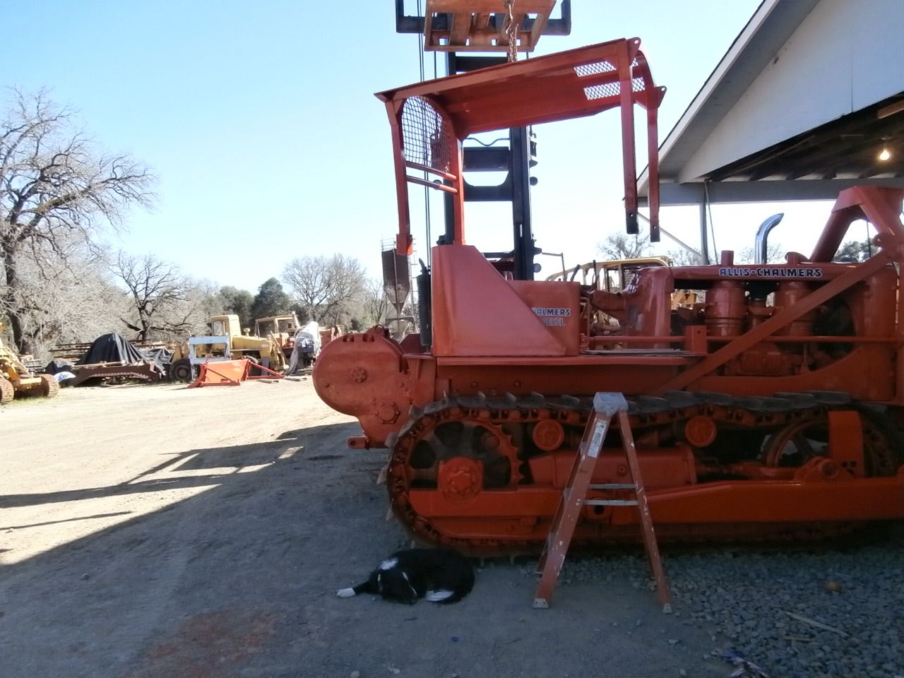

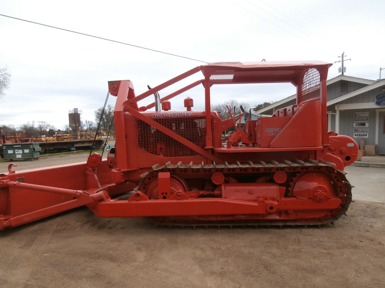

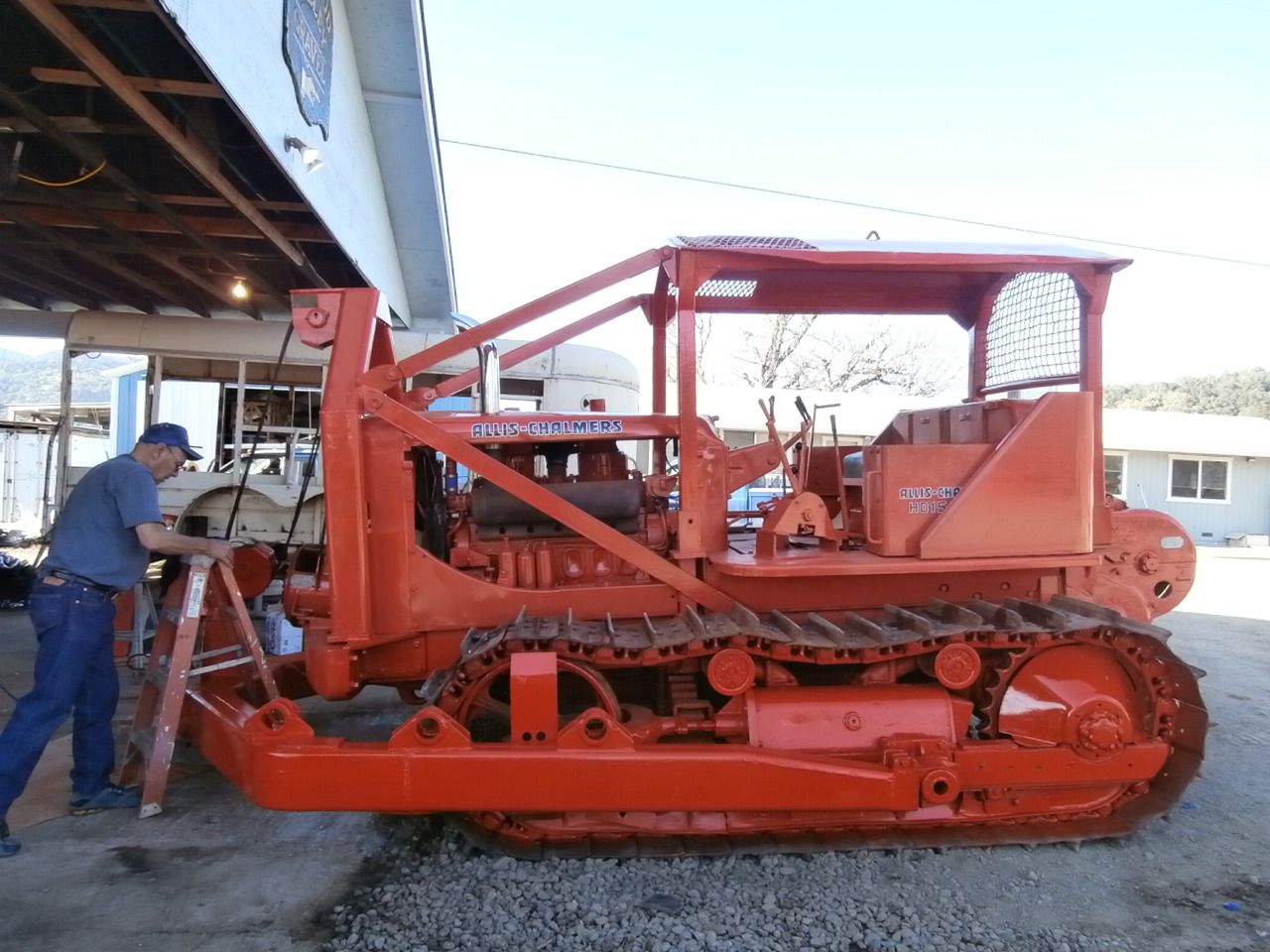

 Ok, so this is what happened since I made that last post at 7:30 this morning photo HD15 PAINTING 4 011_zpsklgfaasy.jpg

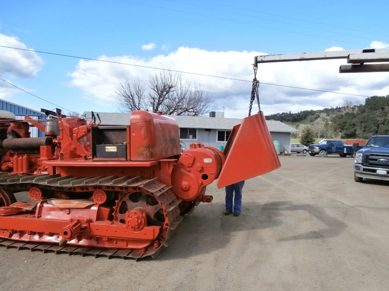

Got he big Taylor sky crane to put the roof on (with Hooch's supervision) photo HD15 PAINTING 4 015_zpsy8ry9lf8.jpg
Front grills still fit after painting photo HD15 PAINTING 4 023_zpseef0ks5s.jpg
Ok kind of looks like this now photo HD15 PAINTING 4 025_zpsi353enhi.jpg photo HD15 PAINTING 4 028_zps7austbvf.jpg
We're waiting for new seat cushions and armrests and some more lettering,but wait there will be more!

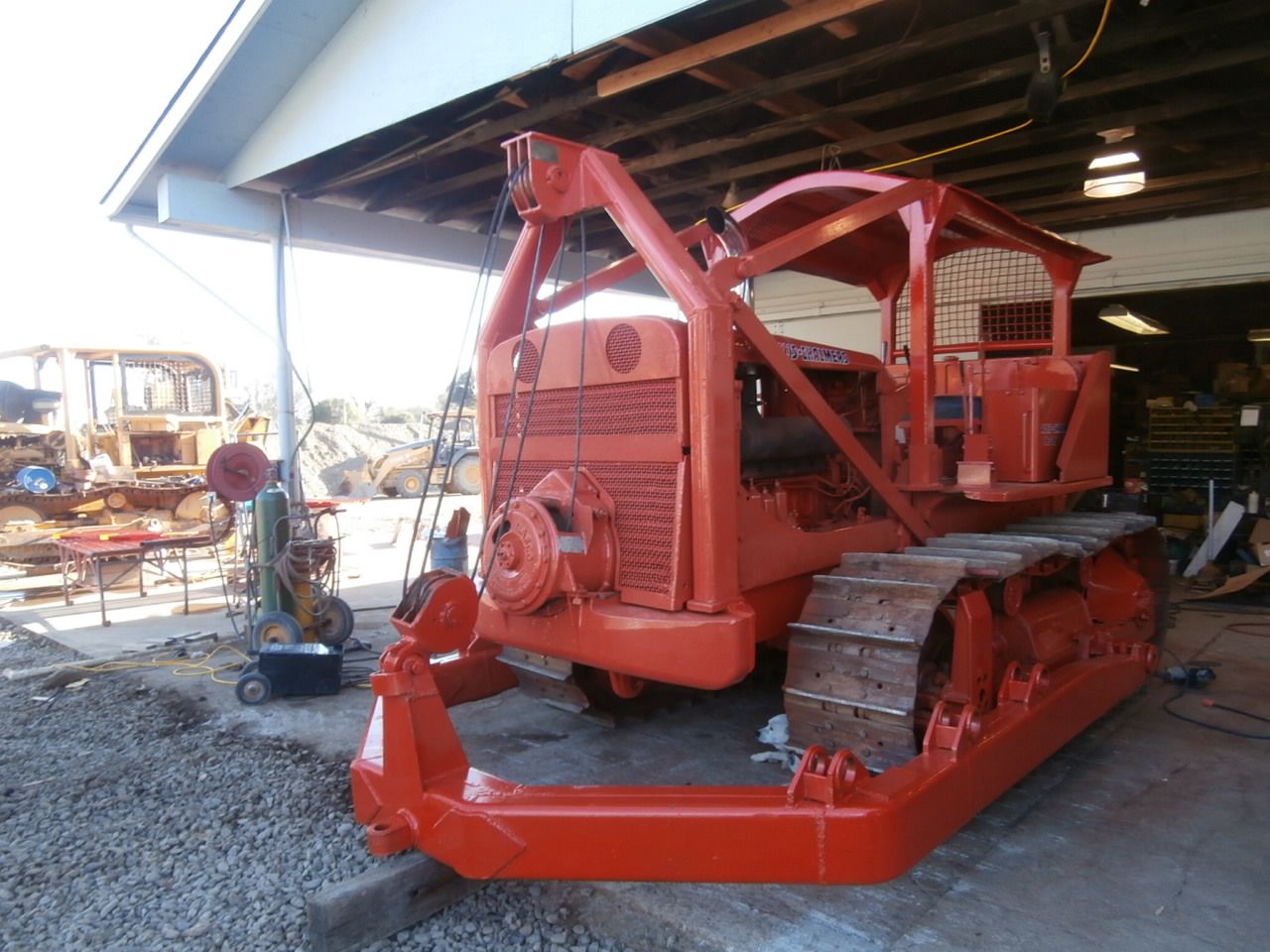

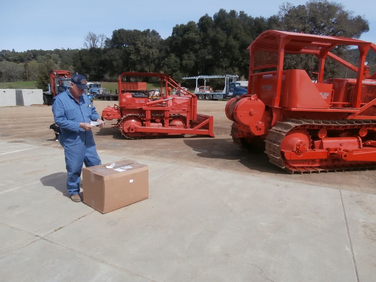

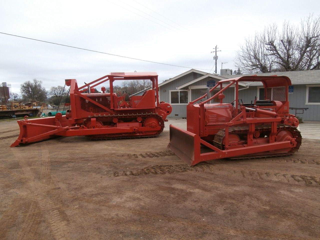

Ok, this is almost the final, final. This was yesterday at 5:00 PM. We're waiting for all new seat cushions which should be here today or tomorrow and a couple of more decals.  photo P3110018_zpsbgcsenyu.jpg
The HD5 needs to be washed. It hasn't been run since the steamshow back in Sept. But it started, so almost ready for showtime.
 photo P3110019_zpsivnfzqhl.jpg We also have made contact with some of the original owners of the HD15 (1951). They are planning on coming to look Sat. afternoon.Needless to say the chance to learn some history will be very exciting for us. I will be making notes (and yes pictures).
 It took a couple of phone calls to catch up with them. I was able to forward this actual Forum link to them. Got the call, we have to come look. I'll keep you posted

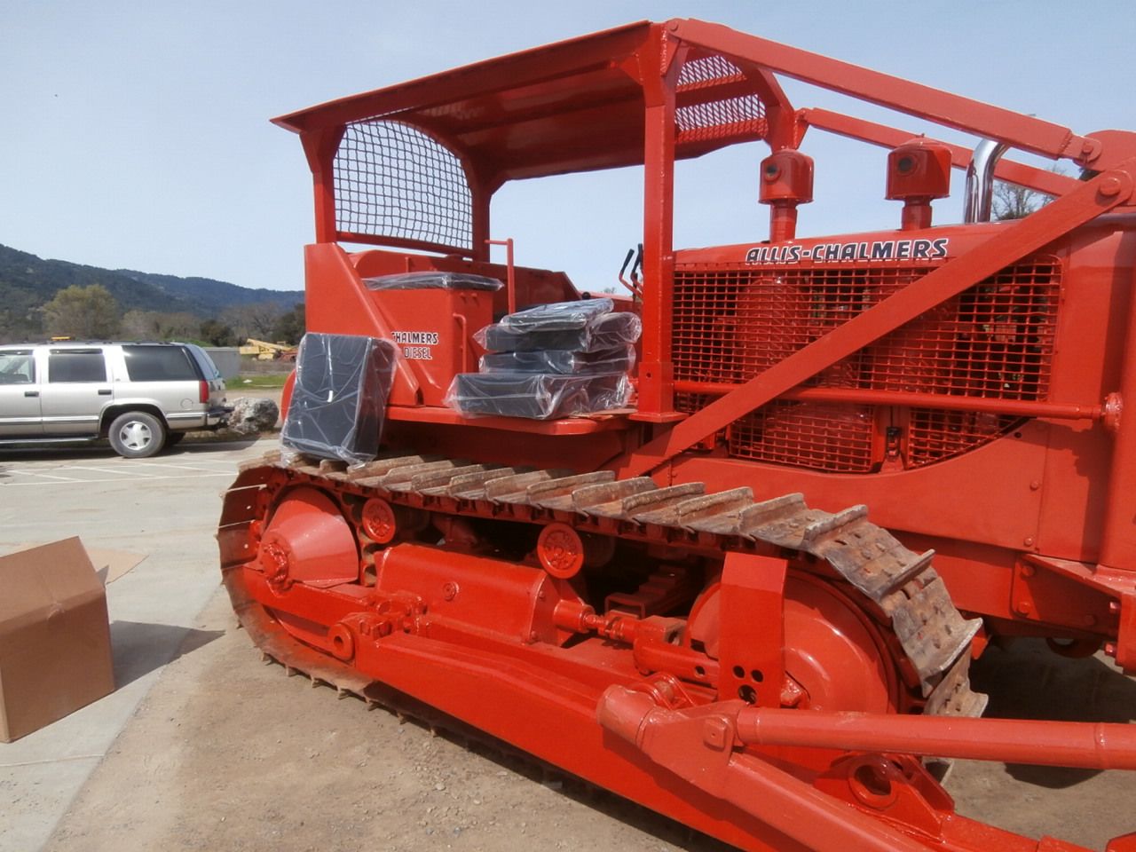

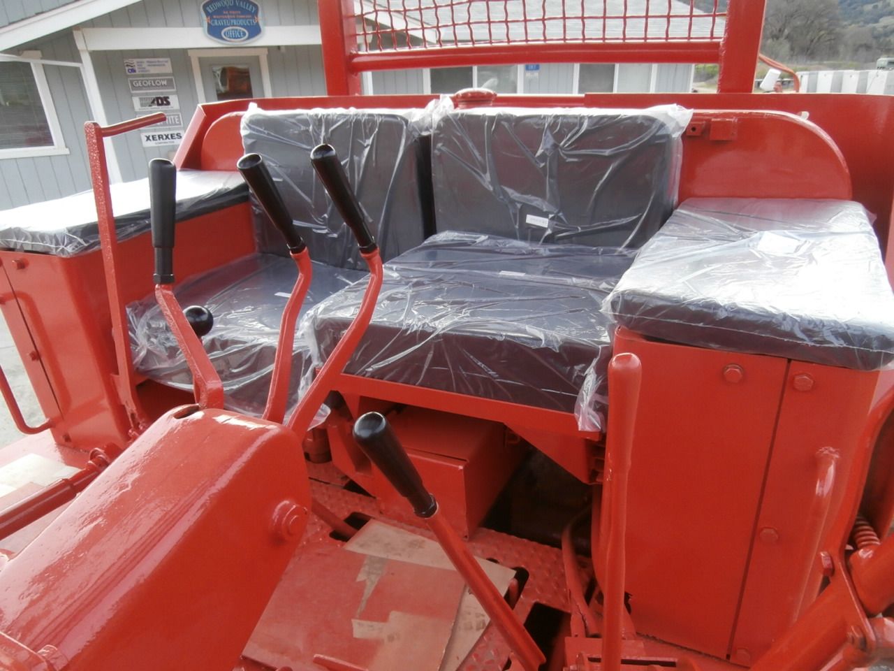

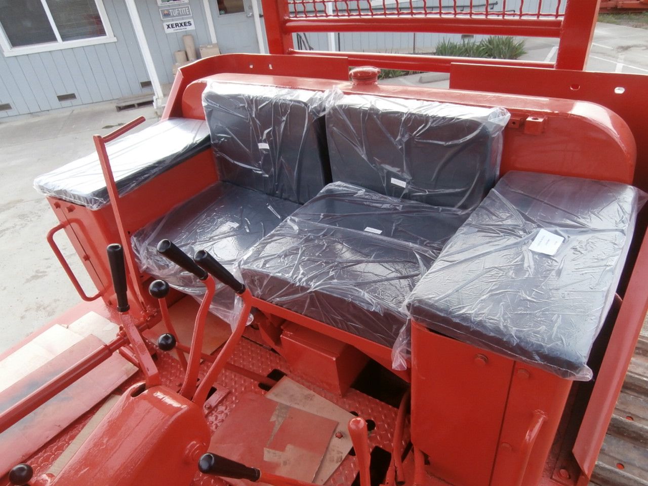

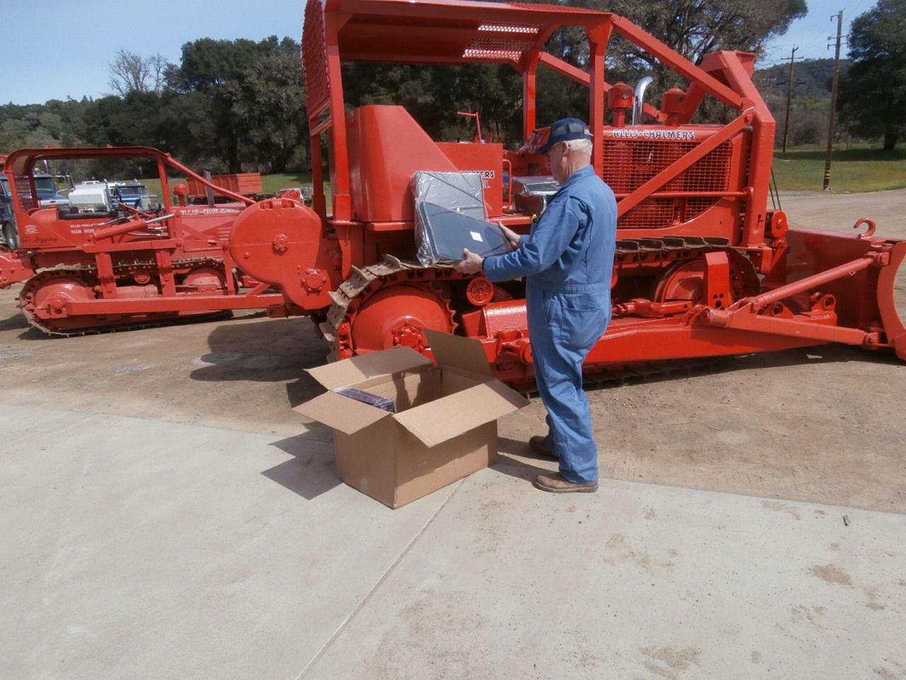

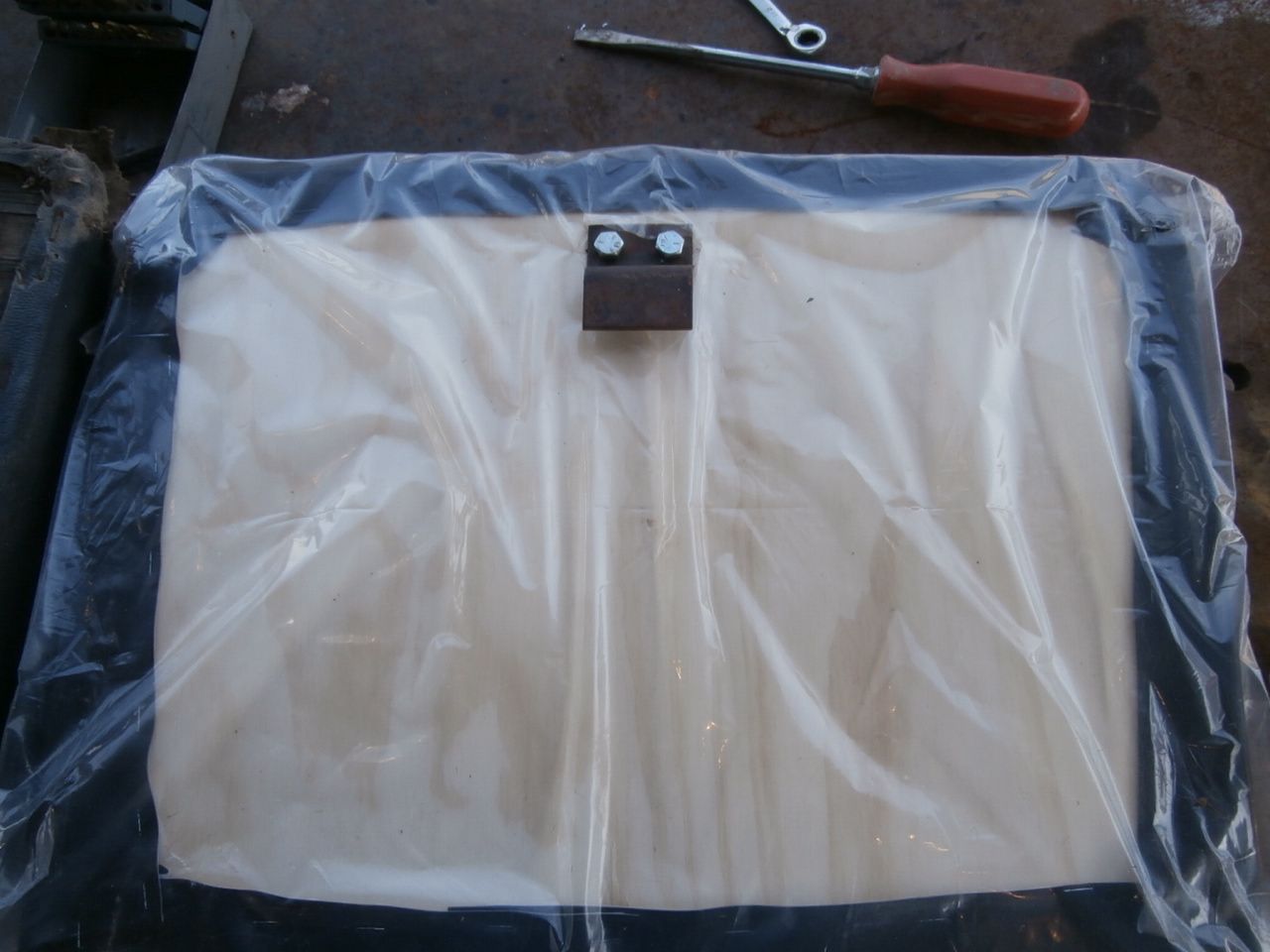

Ok, got a box of new seat cushions yesterday. We're almost done. photo P3120026_zpso88pjexn.jpg

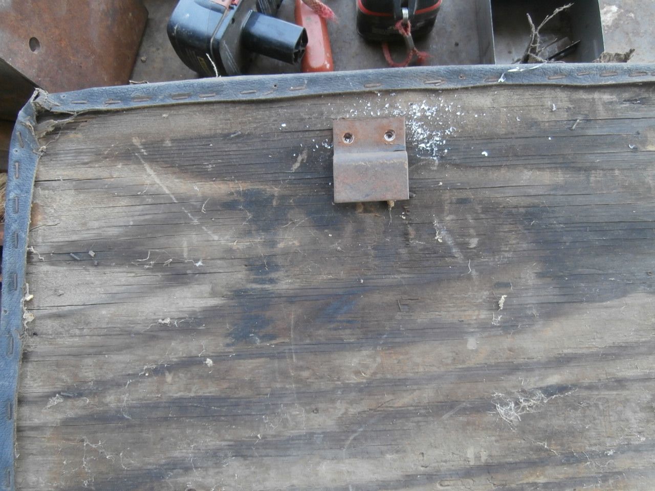

Did a quick inventory to see what adjustments needed to be made photo P3120030_zpsrto8blmt.jpg
I knew from speaking with Debbi at SPEER CUSHION CO. that we would have to use our hardware and brackets but there cushions would have the threaded inserts already photo P3120031_zps4l5edqur.jpg
WOW!  it worked great. I drilled out the old brackets and cleaned them up photo P3120032_zpswuuav7sr.jpg
So it hasn't been that many years ago that when you said you had a new tractor  with the seat still wrapped in plastic, it meant NEW. So what do you think I should do, leave them wrapped? (It's pretty cool) photo P3120034_zps8fwf7lnv.jpg
The Speer Cushion people made this job a whole lot easier. There catalog system which is online has almost all of  the Allis Chalmers tractor seats listed by model/part number/and even dimensions. Makes it very easy to cross reference parts. It appears they have almost every other manufacturer also Cat / IHC/ etc. and new type seats also, So check them out   http://speercushion.com  1-800-5258156
