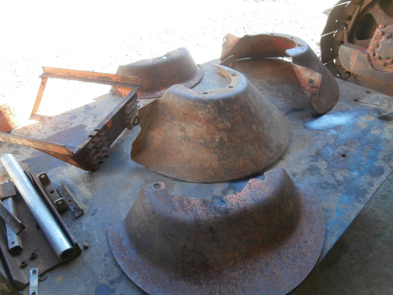

Ok, I got behind on posting. But this is some of the body work that AC tractors might need, but I can't find this in the service manual or service bulletins, so we just make it up as we go.  photo P2130031_zpsqsrqhycx.jpg

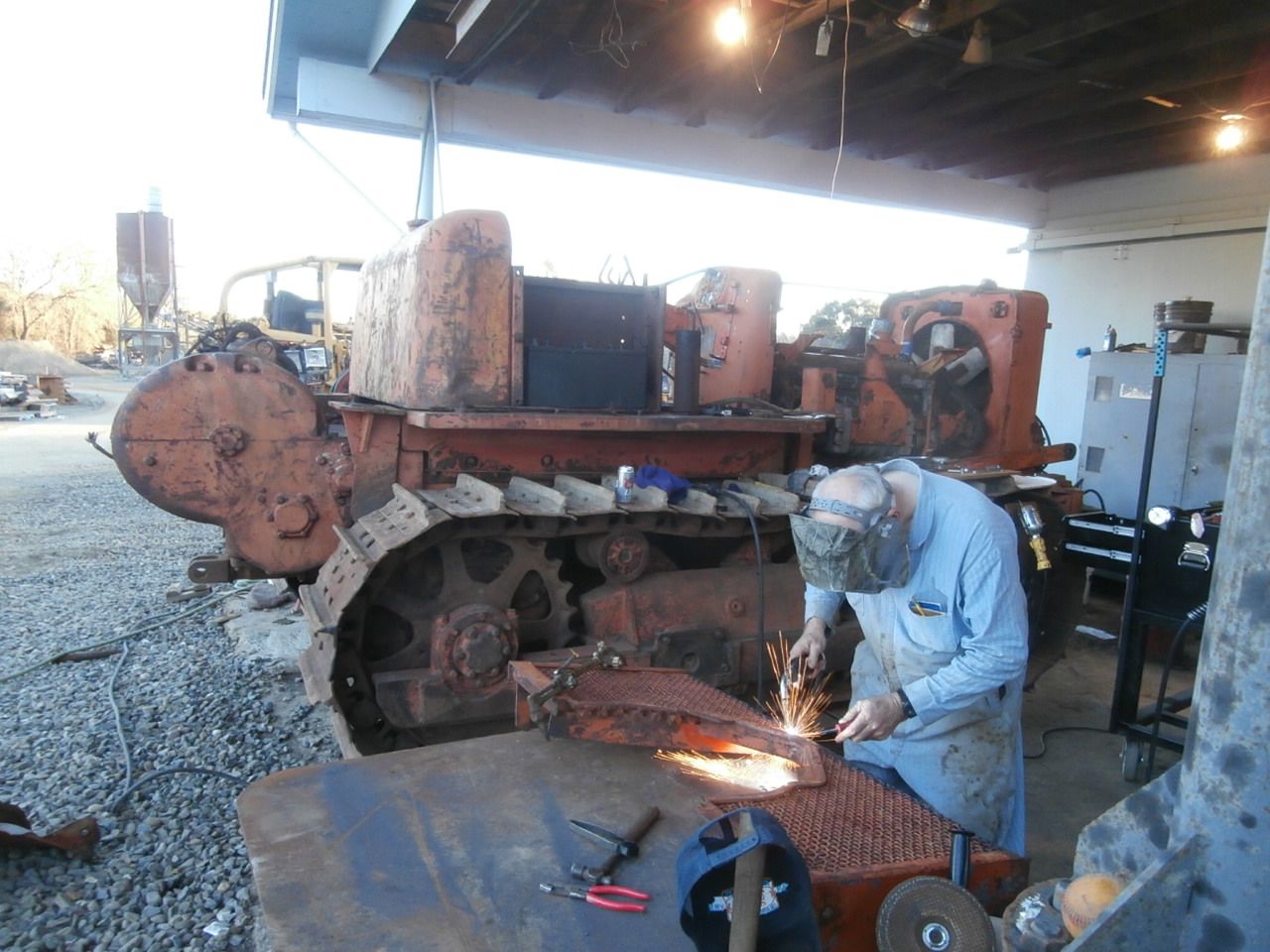

Some of these things don't look as nice once there painted with all these cracks in them. My body work style consists of filling the cracks with .035 wire and a compliment of 2 different size grinders and a couple of die grinders with sanding disks. photo P2130030_zpsiw26yflu.jpg
These all needed some attention. We usually wander around the yard looking for the best ones to start with. (we have several donor tractors) I'm a weld and grind kinda guy, but if they need final touch up with bondo and putty my brother specializes in that (I don't do wood either) photo P2140036_zpsqah2fm9j.jpg

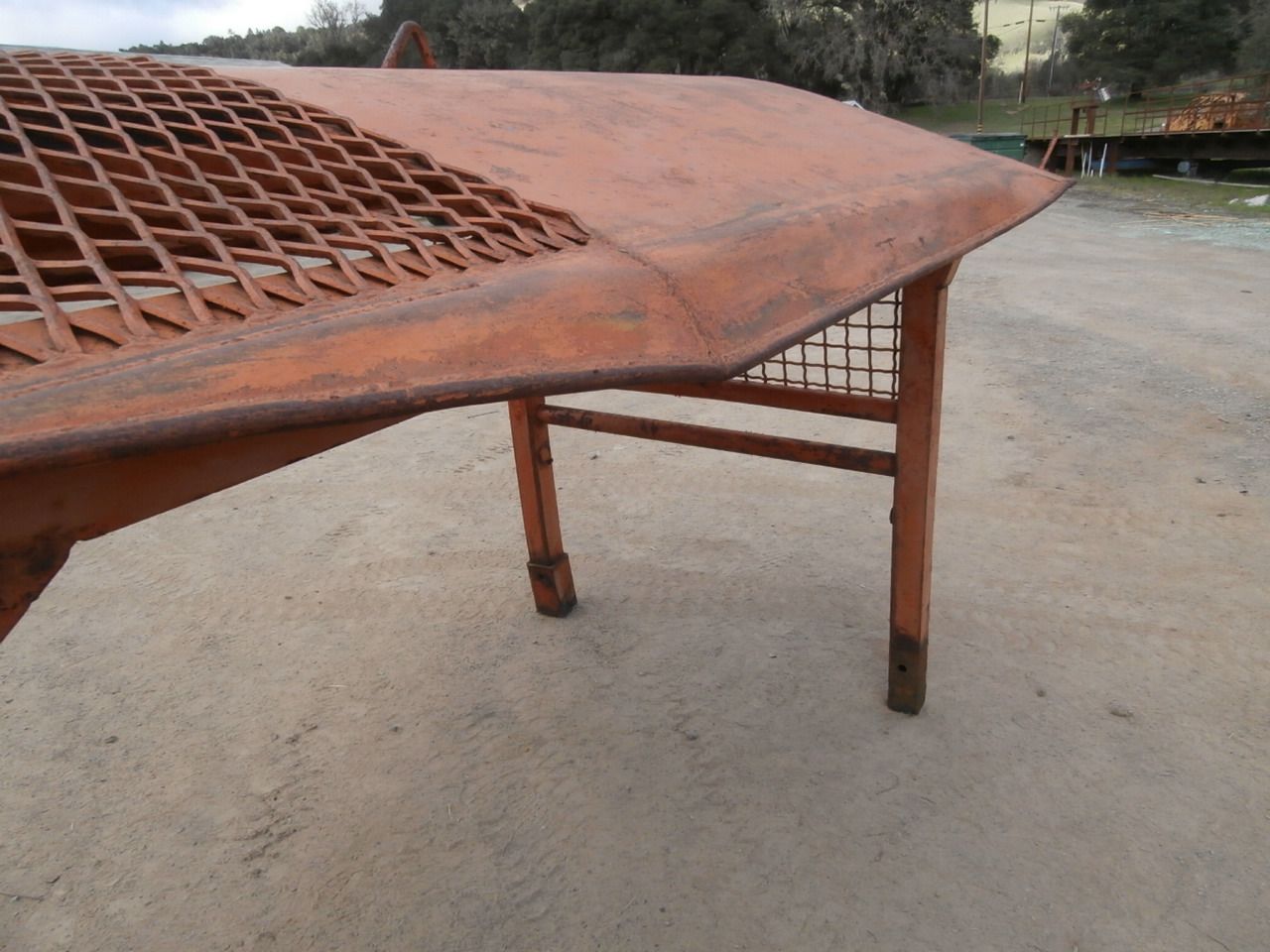

Front radiator guard could have used new screen, but I think you won't be able to tell when I'm done (I'll try to post pictures so you can't tell  photo P2140037_zpsf8cciwrr.jpg

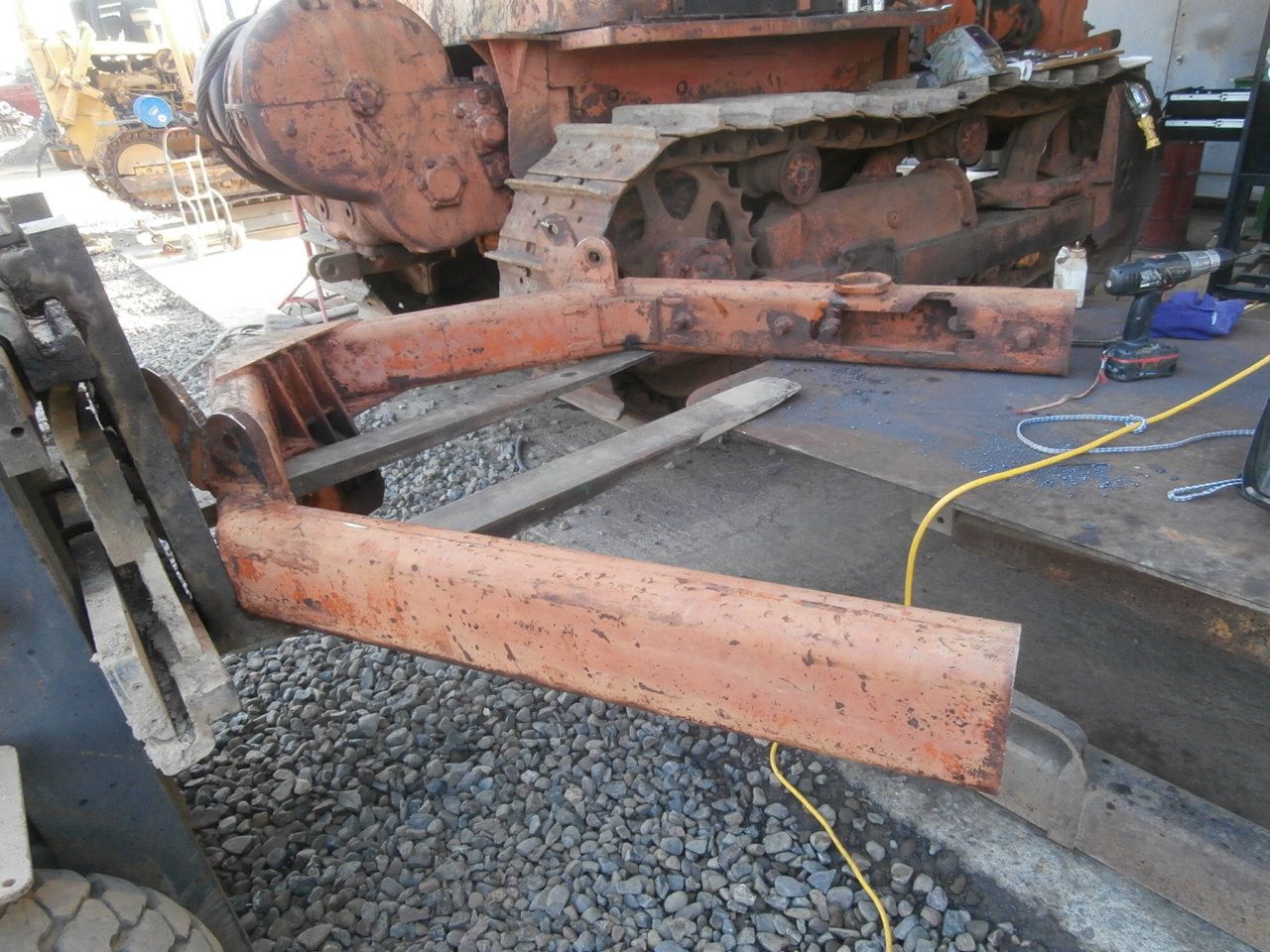

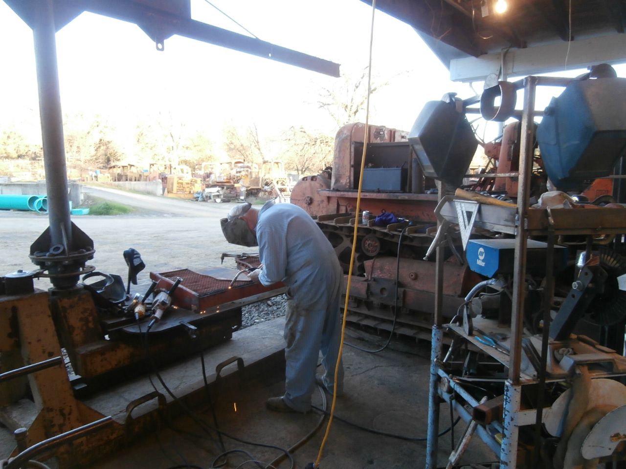

The A frame for the cable blade needed some welding and the 3 bolts in the control lever bearing holder all broke and had to be drilled and tapped again photo P2150040_zpstizflohv.jpg

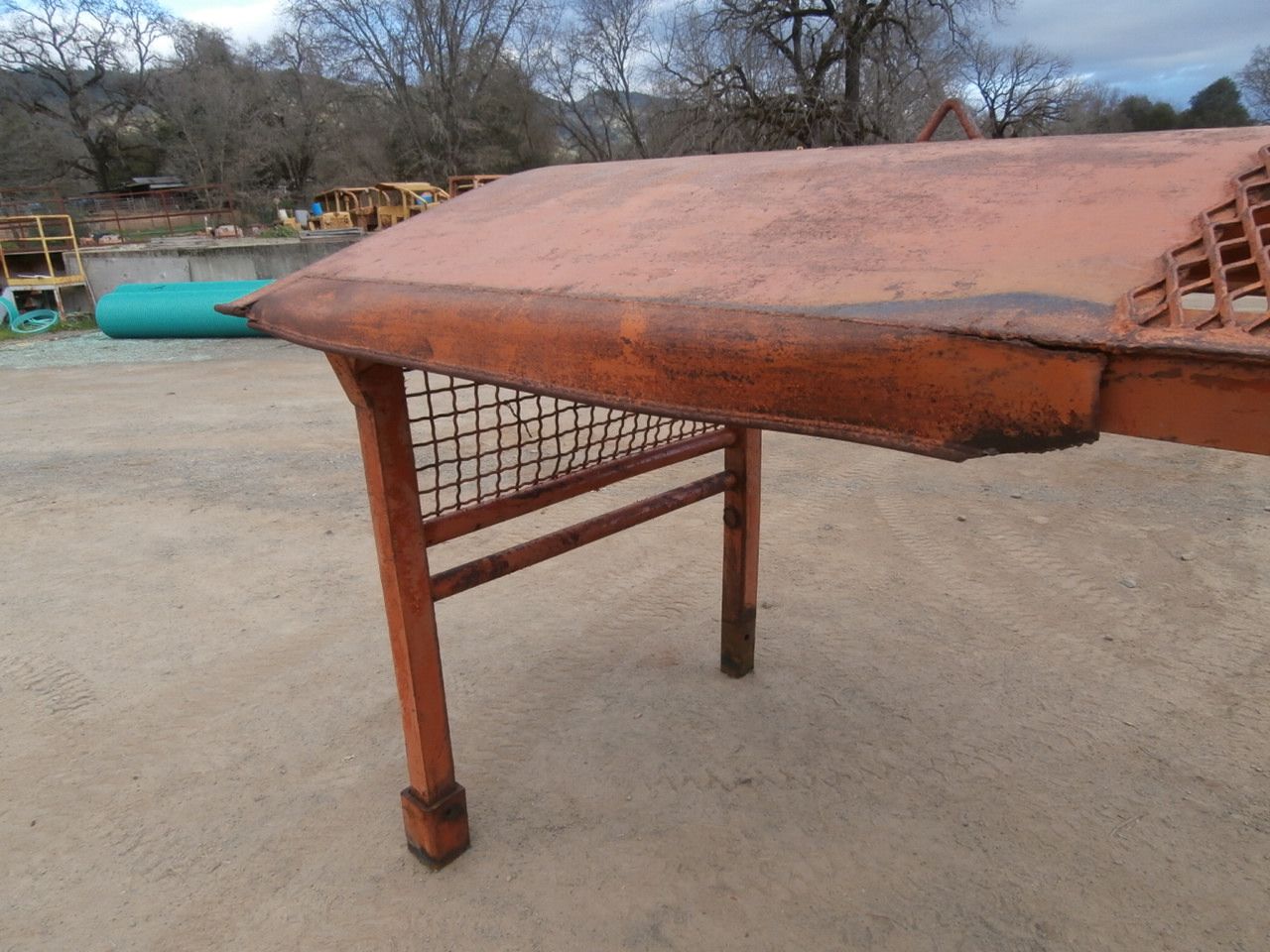

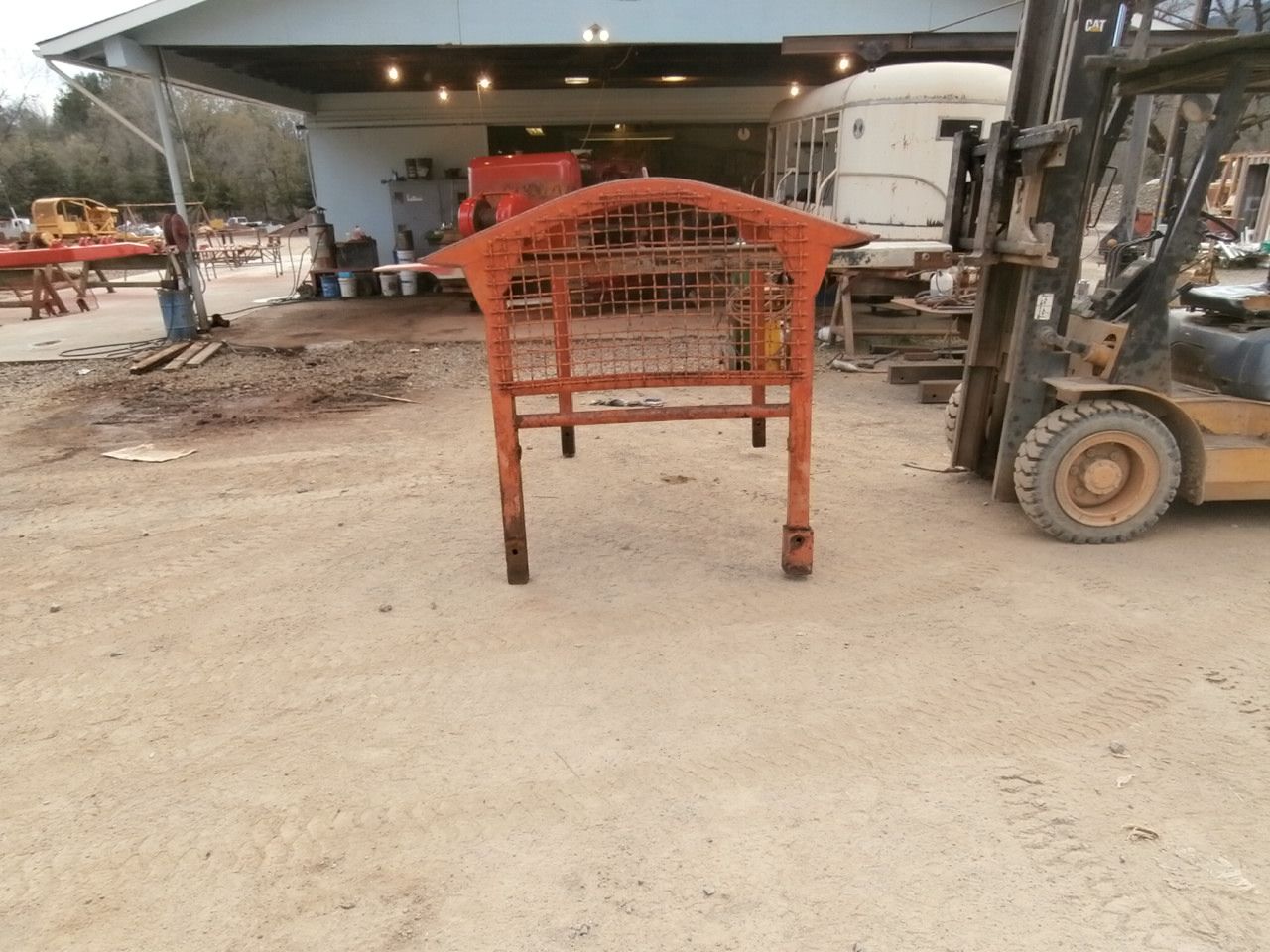

We found a better tank guard (donor tractor) that only needed welding and grinding instead of major straightening.  photo P2150043_zps4qxsfqhr.jpg

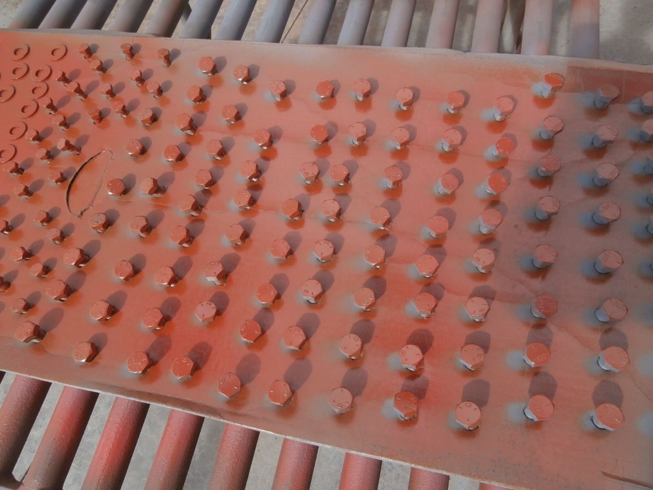

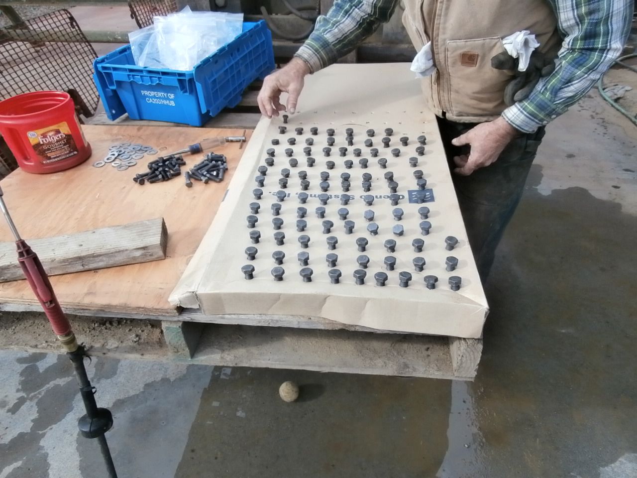

One of the other things we've learned is that trying to paint plated bolts is a pain. Most all suppliers seem to only stock plated bolts anymore photo P2260017_zpswj75k3qk.jpg

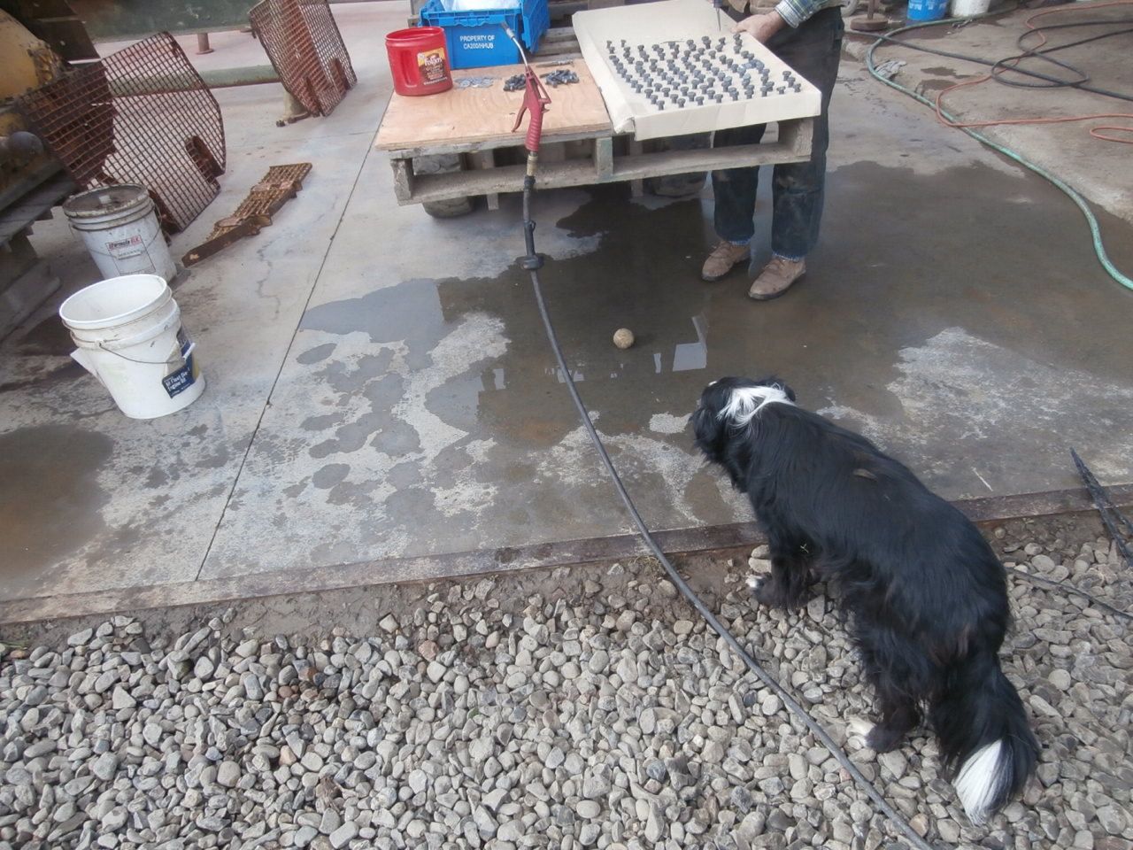

Our supplier would get us plain black nuts and bolts, but I didn't get started on that in time. So are driver John dug through bolts and found some of the appropriate AC sizes, washed them with super clean, dried them and prepared them for paint   photo P2260018_zps2jexzhh8.jpg
Of course this is done with Hooch's supervision cause he knows some one can at least kick the tennis ball while there working photo P2260020_zpsq1kjfch5.jpg

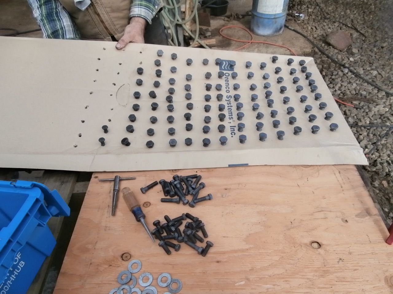

So when David starts painting they look like this photo P2260028_zpshwyguhxb.jpg

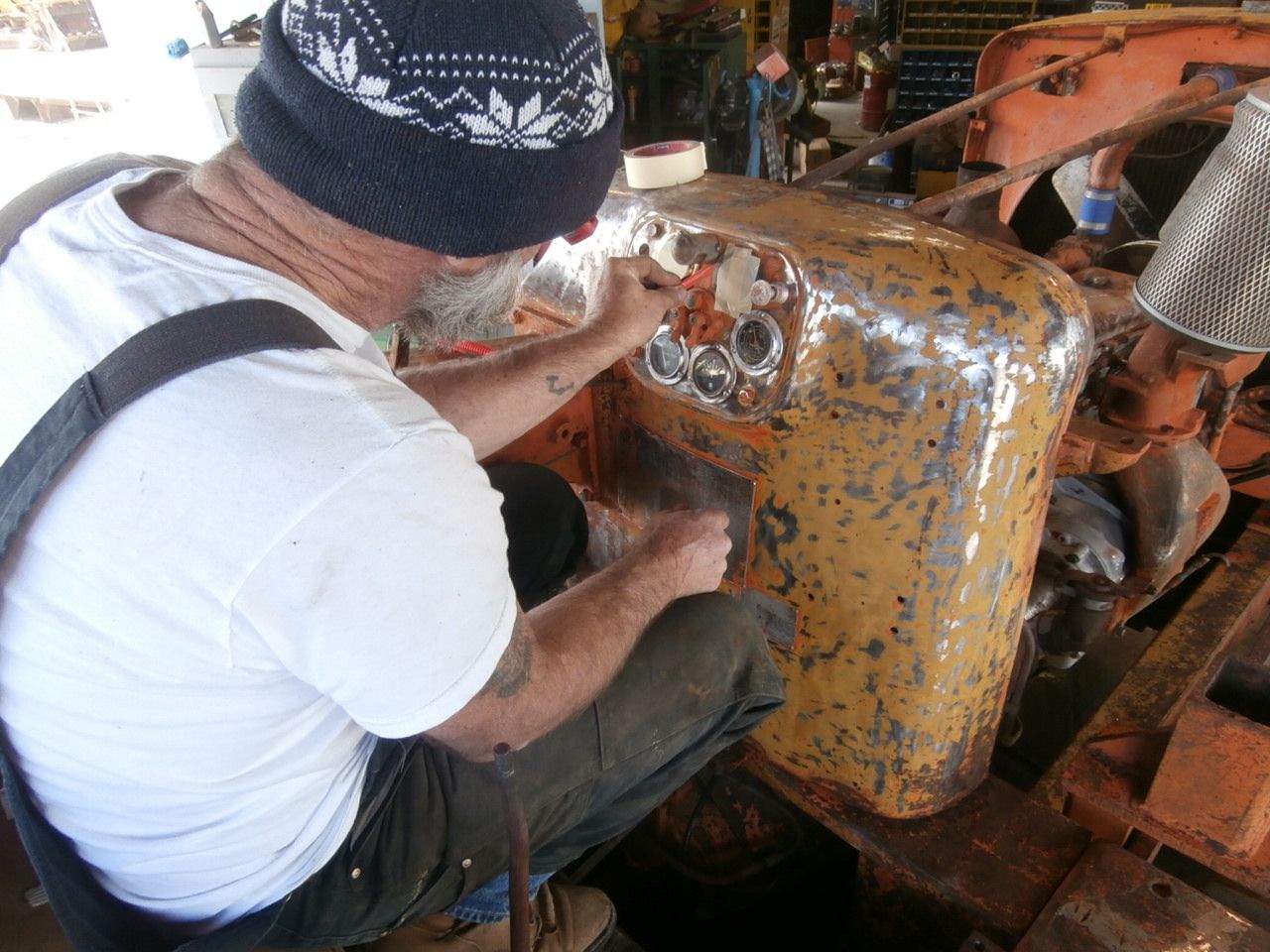

John also masked the guages for painting after we replaced all of them to the original AC 3 screw flange type guages. (one was even brass). We have just about used up all of the original guages from our donor tractors, so be on the lookout for those for us please. photo P2260025_zpsucx1apet.jpg

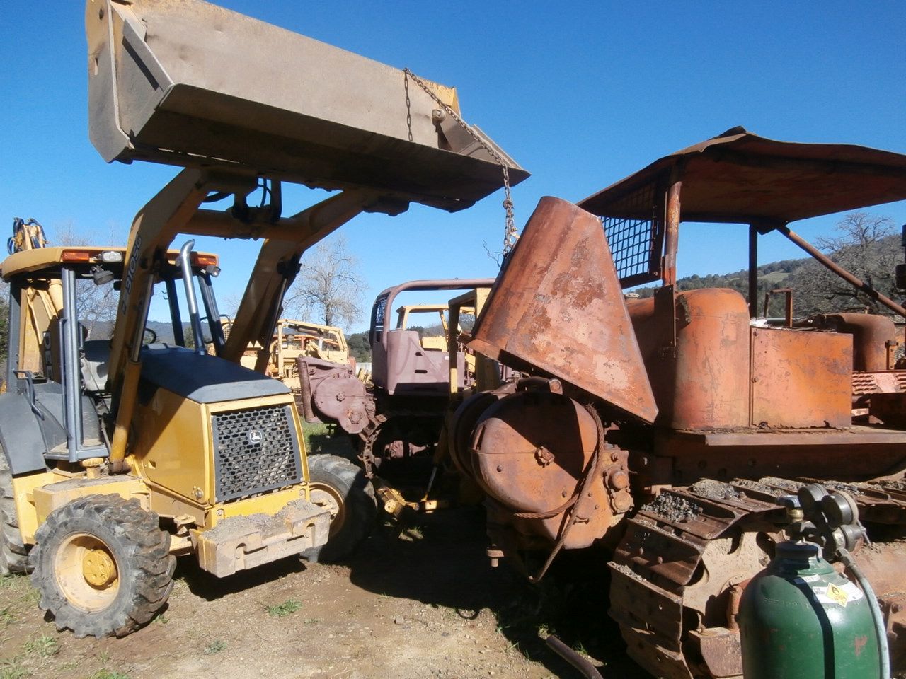

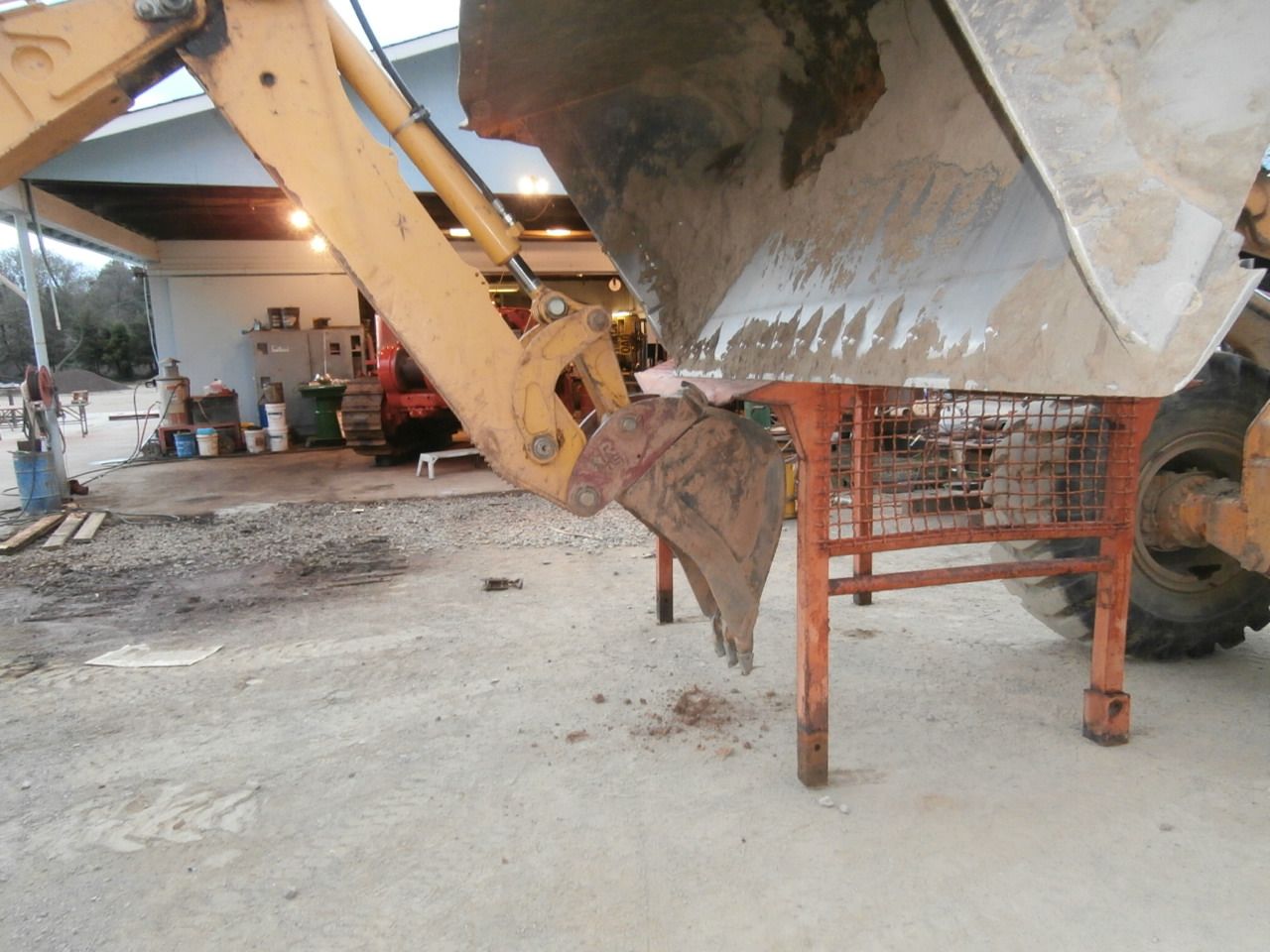

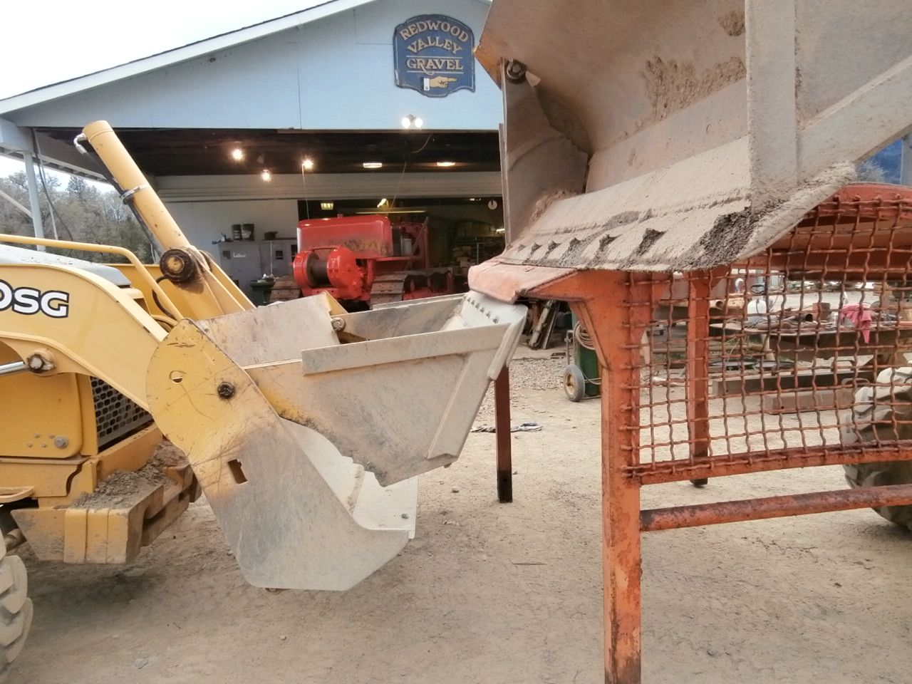

So I thought a straightening would be simple enough with all are metal technology.(LOL) So I brought are 2 John Deere backhoes to the scene for a quick fix. photo P2270044_zps9gulpcog.jpg UH-UH (it was beer time, so 2 beers later) I did what any knowledgeable mechanic would do. GOT A BIGGER HAMMER!. The 745 didn't have any problem holding it down and the backhoe bucket has more strength than the front bucket.  photo P2270046_zpsuagslpjw.jpg
