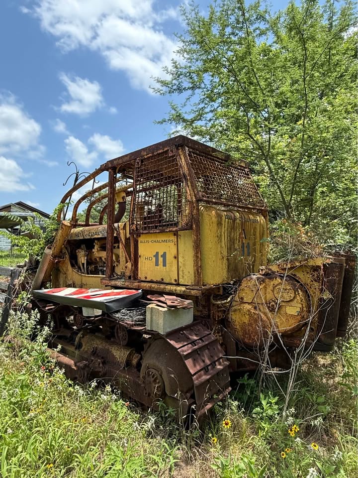

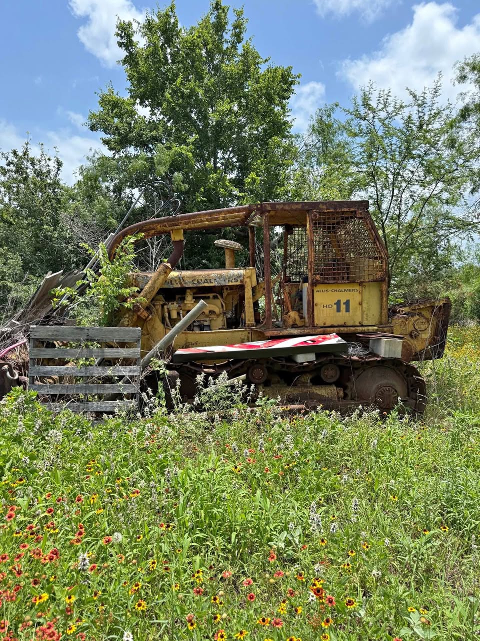

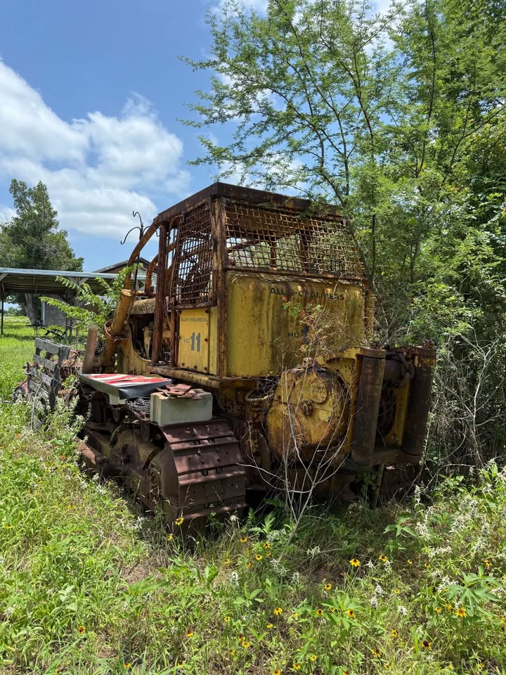

Here are a few pics.

I love it!
Better take a real close look at those tracks Ermm The near side is almighty loose Stern Smile

Yeah, the undercarriage doesn't look great to me, either.  I'll definitely spend some time checking it out when I go see the machine this weekend.

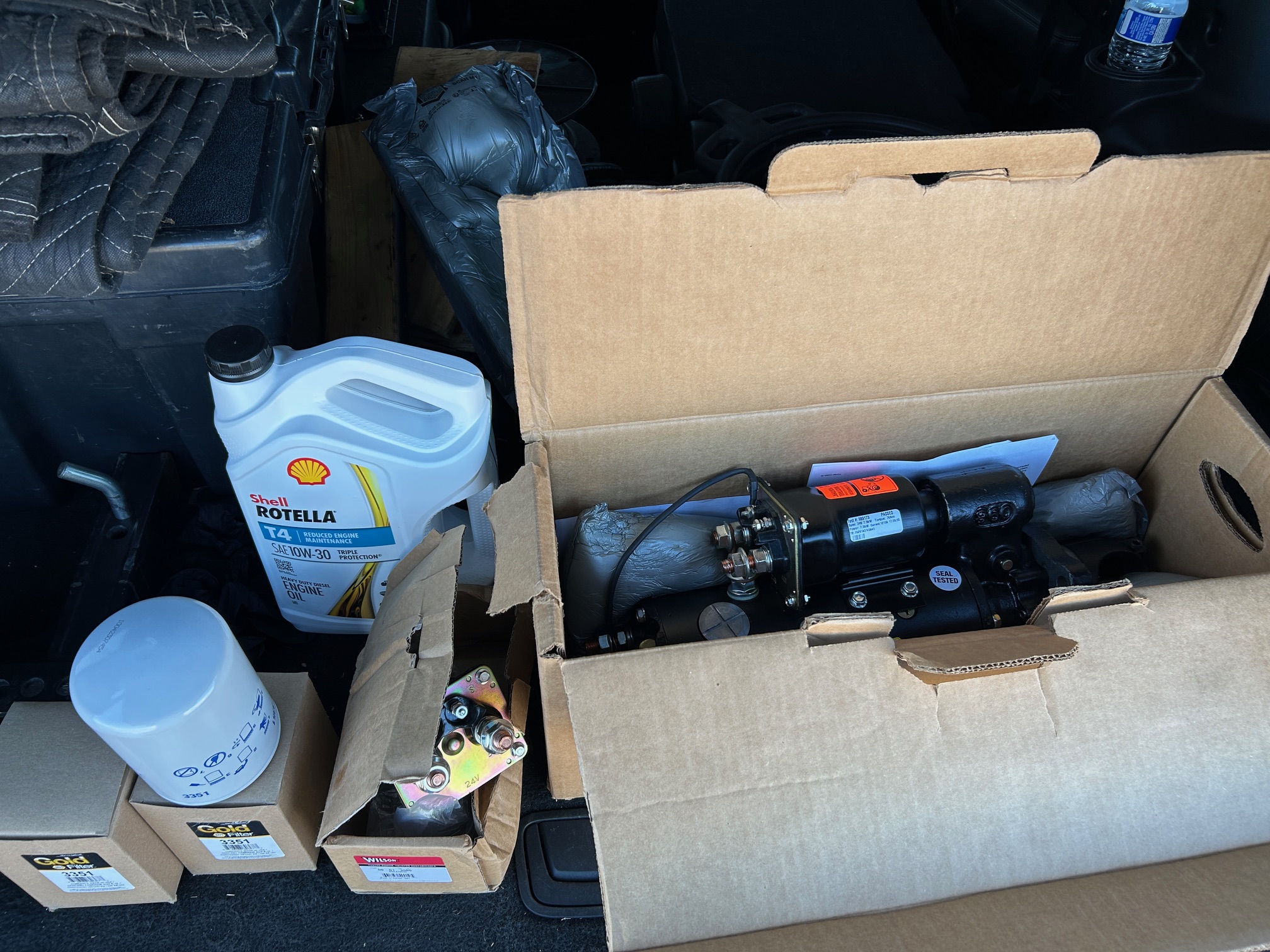

Dropped $700 at Napa today - remanufactured 24v 40MT starter, a 24v solenoid for a 40MT starter, two fuel filters, and a gallon of Rotella.
I think the starter and solenoid on the dozer are both good, but the dozer is 2.5 hours away, so I'm bringing them just in case.
Speaking of the starter, on another thread, someone mentioned that the 40MT starter, which was original equipment on the dozer, was apparently superseded by the 42MT and then the 42MT was replaced by the 39MT. I think the 39MT would be the best option (lighter and spins faster), but I'm not 100% positive that it's a direct fit, so I'm going with the 40MT.
The original fuel filters on the dozer are really rough looking, so if I get the engine to spin over, I'll remove them and replace them with new filters filled with fresh diesel (spiked with 2 stroke oil).
The oil was barely reading on the dipstick, so I'll add a gallon.
If I don't use the new solenoid and starter, I'll return them to Napa on Monday.
