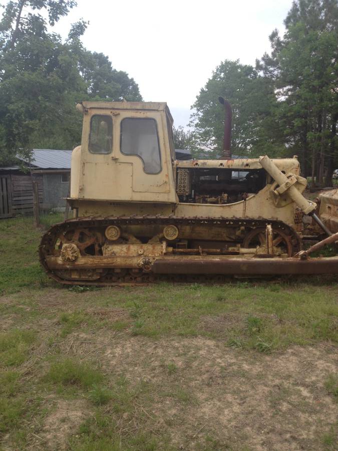

Post Options Post Options   Thanks (0) Thanks(0)   Quote DMiller Quote  Post ReplyReply Direct Link To This Post Posted: 07 Jul 2017 at 8:03am
One option, I missed the 953 rails, another got them as I could not afford the price on that previous page. The cat 6.906 rails have a smaller diameter bushing and with sprocket wear along with used chain wear may fit well enough to an older machine yet will have to adjust the number of segments to fit your tractor. Rollers are another concern though as Cat rollers will not directly bolt up to a AC machine, trucks have to be dismantled and re-drilled and ground out to use them. This size rail is common to a great deal of Cats but shoes could be a problem as to width, may have to have them cut to fit against a Allis tractor.

Post Options Post Options   Thanks (0) Thanks(0)   Quote Ray54 Quote  Post ReplyReply Direct Link To This Post Posted: 06 Jul 2017 at 3:38pm
That track is to tight looking from the picture.But there are reasons that would make it ok,if it was driven back wards to where it sits slack would be on the bottom. A inch to 1 1/2 inches is normal amount of sag in a track between support.
Running them tight may help keep them from coming off,but also increases the ware.

Post Options Post Options   Thanks (0) Thanks(0)   Quote DMiller Quote  Post ReplyReply Direct Link To This Post Posted: 06 Jul 2017 at 3:12pm
It has the longer 8 bottom roller trucks, need to measure the rails for wear on pins/bushings measure across five pins, any five pins same edge to same edge and divide by four, if greater than 7.125 they are pretty well at Zero left. There are other measurements, sprocket wear, wear on the running surface of rails, wear on idlers but all together mean little if the rails are already worn thin.

Post Options Post Options   Thanks (0) Thanks(0)   Quote CAL(KS) Quote  Post ReplyReply Direct Link To This Post Posted: 06 Jul 2017 at 11:17am
imo hard to tell from the picture, its too far away.  its got the long track so it looks way out there but may not be.  really need to base it off of where it sits on the truck frame which you cant see from here

Post Options Post Options   Thanks (0) Thanks(0)   Quote Ferdinand Quote  Post ReplyReply Direct Link To This Post Posted: 06 Jul 2017 at 10:37am
I noticed this HD11B for sale. What do you think of track condition? I got it wrong last time I asked but,.... in this picture the tensioner for  the tracks looks way out , as far as it can go.
