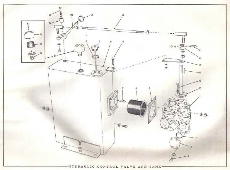

Here's a page from the parts manual for the Allis hydraulic system for the HD11.You can see which is the breather and which is the dipstick. This is the tank on your right-hand side. Also has the valve and lever mount as you can see.
Of course, if yours doesn't have an AC hydraulic system, then all I have done is posted a weird picture to confuse you......

Andrew_D --- Sir ,    Thank you for the great photo ! Exactly what I have !
 Question --- is it likely that the hydrolic system you have shown me here is also the control for the three (the drive and two steering ) clutchs as well ?

That hydraulic system controls only the blade. (Also controlled the rear ripper too if you have one.)
As with many crawler tractor manufacturers of that era, the blade and control systems were a seperate item. The parts book I have lists the hydraulic and cable blades (11BD, 11GD, 11BDC, 11GDC) that Allis offered for the HD11. Everything from the push arms, C-frame, blades, front root ripper (brush/stone rake), hydraulic tank(front mount and side mount as shown above)/pump/valves/cylinders/lines/diverter valve for rear ripper, cable sheaves (Not the cable control unit though. CCU's would have been manufacturer dependent.)
In searching for certain parts, I have found that some items also crossed with the HD16 and HD21. Not the blades, push arms or anything big like that. But filters, tanks, hydraulic pumps, valves, etc.
I can email you (or anyone else!) the PDF parts book if you'd like. 54 pages, 12MB.
