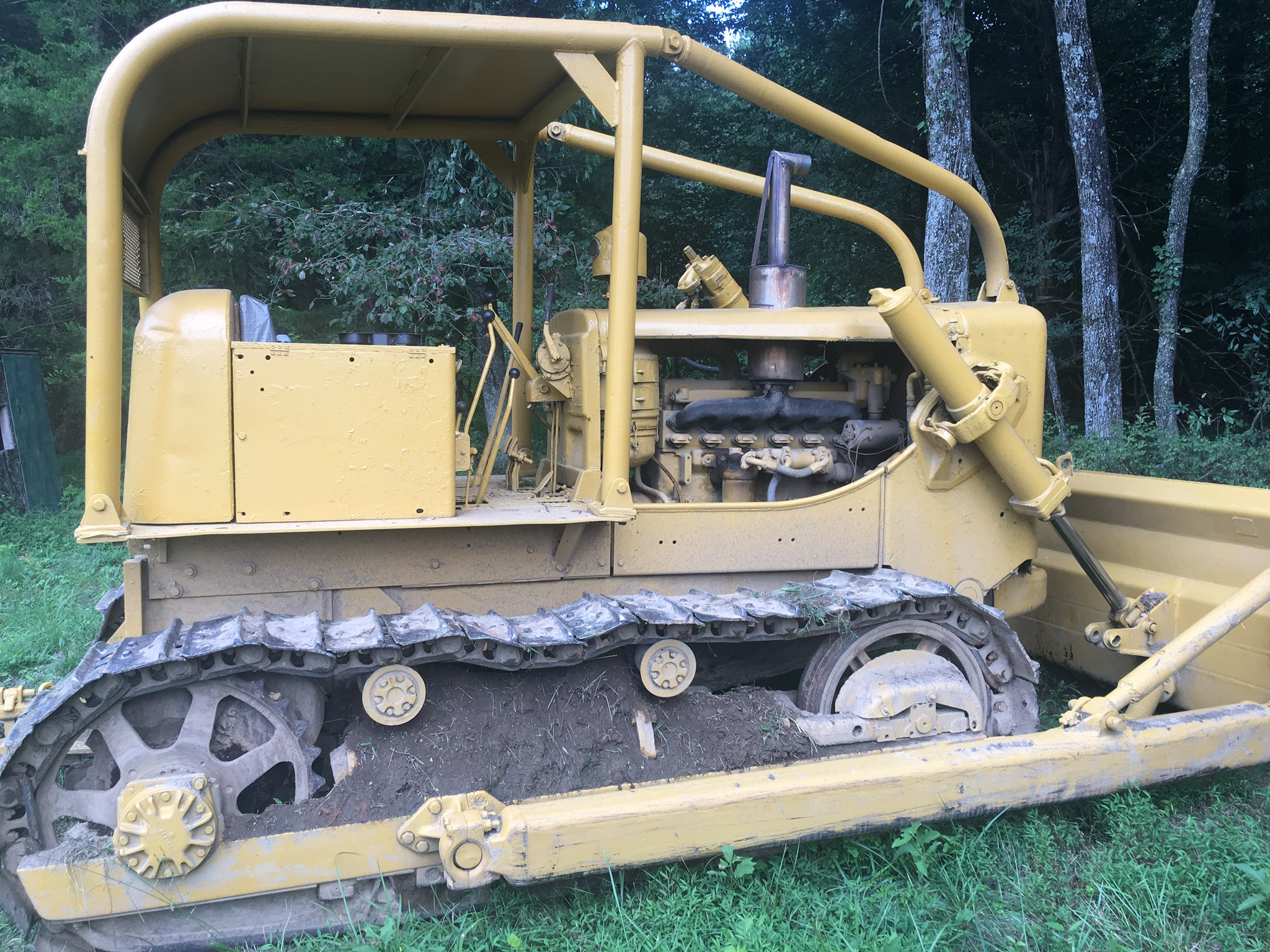

Can anyone help me with adjustments on my HD11 clutch is it like a PTO clutch or like a semi clutch pics sure would be helpful I have ordered a service manual it won't be here for 10 to 12 days any information would be highly appreciated

Post Options Post Options   Thanks (0) Thanks(0)   Quote Hunt Quote  Post ReplyReply Direct Link To This Post Posted: 08 Sep 2017 at 5:16pm
Pic

Post Options Post Options   Thanks (0) Thanks(0)   Quote gemdozer Quote  Post ReplyReply Direct Link To This Post Posted: 08 Sep 2017 at 6:22pm
Nice HD11 with BUDA ALLIS motor and the track are too much loosed

Post Options Post Options   Thanks (0) Thanks(0)   Quote Hunt Quote  Post ReplyReply Direct Link To This Post Posted: 08 Sep 2017 at 6:28pm
Thanks you know anything about clutch/brake

Post Options Post Options   Thanks (0) Thanks(0)   Quote Steve allis dozer Quote  Post ReplyReply Direct Link To This Post Posted: 09 Sep 2017 at 7:36pm
 It has a late model quick drop ram on one side , does the blade function ok they are meant to be a pair ? when lowering the blade does it twist ) left hand side would release quicker and the right ram would have all the weight .

Post Options Post Options   Thanks (0) Thanks(0)   Quote Lazyts Quote  Post ReplyReply Direct Link To This Post Posted: 09 Sep 2017 at 9:26pm
Looks like one of the late ones with the dry clutch.  They have a ring type clutch, you take off an inspection plate on the top to adjust, loosen the retainers and turn the ring I believe...  Interesting to see that one quick drop valve for sure- you could adjust it to minimize the effect.

Post Options Post Options   Thanks (0) Thanks(0)   Quote Hunt Quote  Post ReplyReply Direct Link To This Post Posted: 10 Sep 2017 at 12:37pm
Yeah it actually works really well both sides come up an down evenly their might be a slight slight difference

Post Options Post Options   Thanks (0) Thanks(0)   Quote gemdozer Quote  Post ReplyReply Direct Link To This Post Posted: 10 Sep 2017 at 1:58pm
The idler is at the end track frame and you have to make turned boushing or removed a link track and final drive sprocket is leaking.
