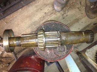

hopefully this pic of the axle went through. not sure what else you may need

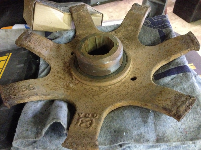

hub pic
