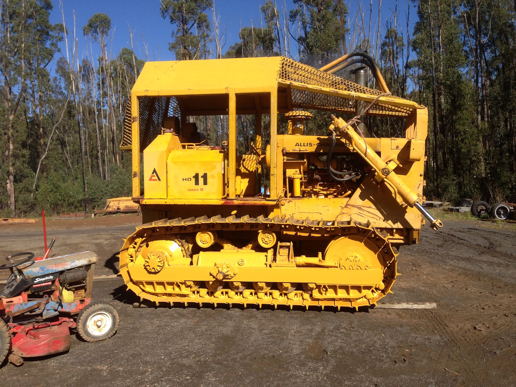

For comparison to Baremetals HD 11 EP sprockets  yours look the same as these
Regards steve
baremetalworks View Drop Down
Joined: 26 May 2016
Points: 26
Post Options Post Options   Thanks (0) Thanks(0)   Quote baremetalworks Quote  Post ReplyReply Direct Link To This Post Posted: 02 Jul 2016 at 10:20am
Thanks for the pic Steve! those do look the same. I posted a pic of the numbers on the other thread, I will be back out at the farm tomorrow to look at it again

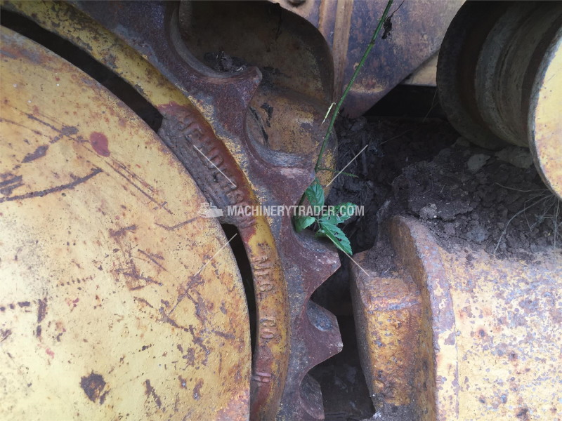

Hope you don't mind Steve, but this thread seems like a good place to ask this question:
Are these sprockets "bad". Seller says they need replacing.
What do y'all think?

Not sharp at the tip so I don't think so. Would sooner say bushing have may be bad if having issues with track. But hard to get a picture of that,easier to feel how out off round with your hand.

I agree with Ray  they have plenty of life left in them, and looking at the welds on the spokes they appear to have been fitted not long ago

yeah if a guys was using it every day might be an issue,  sparatic or farm use probably outlast you

Sprocket teeth appear in better condition than my 7G with the same pitch rail, nothing wrong with those as mine are within dimensions of operation.
Points: 35666
Post Options Post Options   Thanks (0) Thanks(0)   Quote DMiller Quote  Post ReplyReply Direct Link To This Post Posted: 14 Jul 2016 at 2:23pm
My old rails are sloppy, lots of bushing/pin wear so have become snakey and will try to roll off when in a side load.  Just need to be careful of them and keep them snugged up in tension for now.
