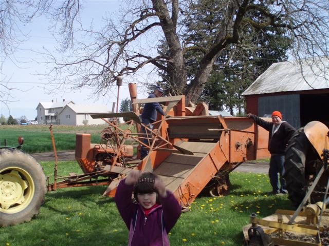

Model 60A on a 102" tilt deckover....my way(as taught to me by my helper)...critique away...and yes I had to go over a mountain..took all my TD Dodge could give.

I think you did a fine job loading it. Better then alot of folks you see. Does your state require you to use that style binder or that your prefrence?
437 HP??!!!  Boy I wish I had that!! But your MPG has to suck - So I guess I cant be too envious??
Not aware of any requirement, but I do prefer those binders.  That other type scares me!

I hate rachet binders personally. But I heard, and it maybe rumor, some states are making pressure binders illegal. Thats why I asked.

What you did worked and that's what counts. I was able to get a 60 on a 102" trailer - with the tires barely on -- the jacked it up enough to get the weight off the tires, blocked it that way, and chained / racheted it down tight and drove home couple hundred mile, unblocked and rolled her off.

Only thing I would have done differently Tom would be to add two more chain downs, one on each axle to give a more vertical pull down to the trailer.

If you angle the front of them blocks about 30 degrees to the outside they would be lot more stable.

Thanks for the pointers!
