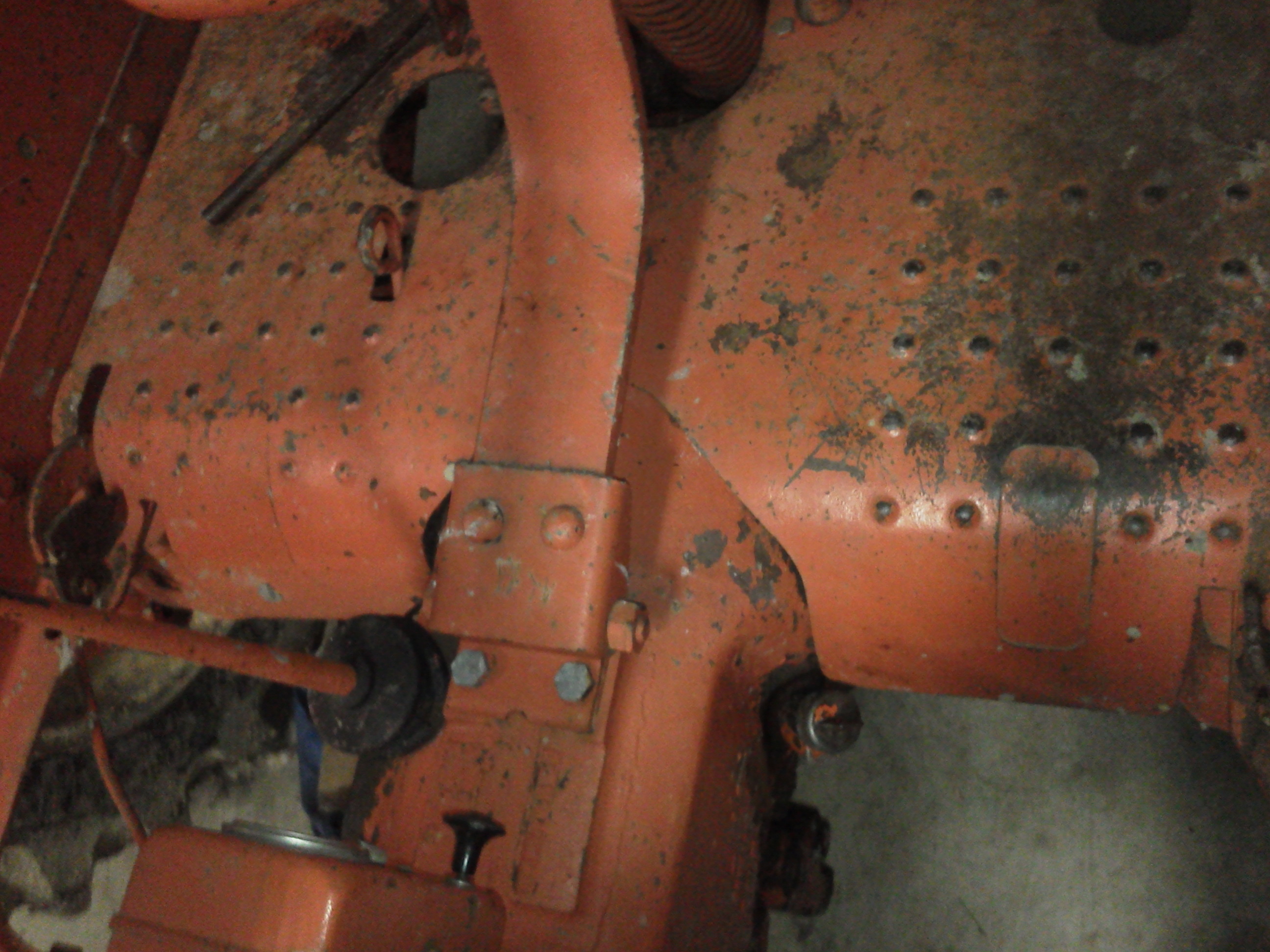

I just acquired an CA , several folks told me to be sure and check the hand clutch. I looked all over and couldn't find one. After looking at pictures, I see where it would mount through the platform. My knock out in the sheet metal has never been removed. Is it possible that it was originally ordered without the hand clutch?

Hand clutches were an option so yours must not have come with one. You can still install one but you just need to round up all the parts.

you can clearly see the knockouts but neither has been removed. Guess mine is special.
Post Options Post Options   Thanks (0) Thanks(0)   Quote CTuckerNWIL Quote  Post ReplyReply Direct Link To This Post Posted: 05 Mar 2012 at 8:06pm
Yes, I would agree.
