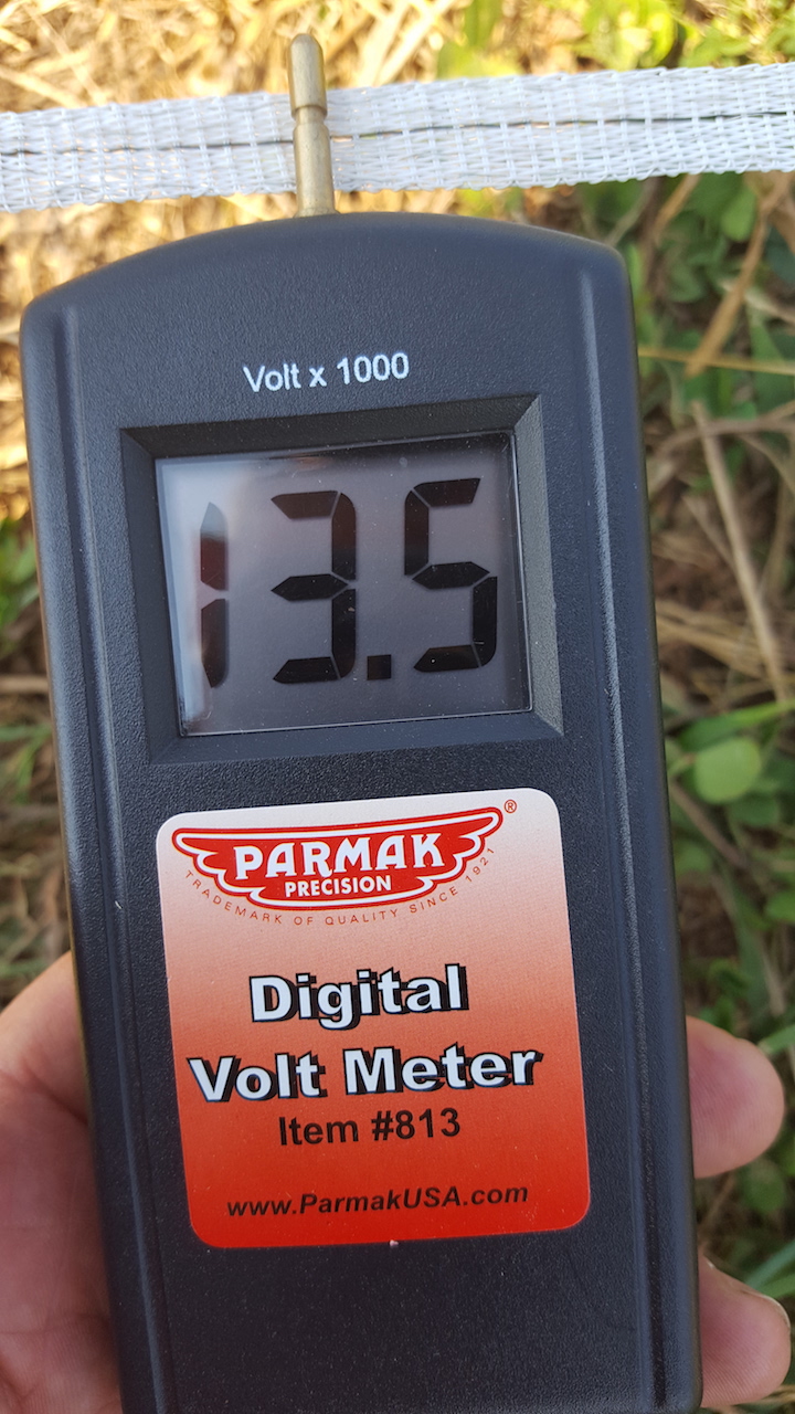

Don't know if this is just my warped sense of logic........but this is the voltage tester I use on my E fences.......it has a digital readout vs. the less expensive "christmas tree" versions......most of which top out at around 7,000 volts.
Anyway......my logic is if I test at the fencer.....straight from Hot side to ground.....and this is the voltage......and if I test the fence........from hot wire to soil.......and if I get the same reading.......my grounding system is good enough (negative probe on the tester always buried in the soil.....not touching the ground system.
In general, when I build a complete fence enclosure, the terminal end returns to the beginning. So as a fault finder, I start by testing the terminal end.....knowing if it's hot there, it has to be hot all the way around too. And hopefully, I get the same voltage. I usually do with wire.....not always with the poly tape if that is older and may have some broken strands in it.....or if spliced, a bad splice. Also like to test it at the farthest point......to me that is a  test of the ground system.
But if I get the same reading, I'm not sure how adding more ground rods will make it any more effective? Unless a cow, horse, dog, etc, represents a larger load to punch through than my voltage meter?

mo, I think you're exactly right, the load of a body is WAY different than that of a meter.  And I have the same type meter as you do.  Kind of like, you turn the key on your tractor, you get lights, but hit the starter and there's nothing.  You've got the voltage there (the lights are telling you so like a meter), but when you need the current the ground doesn't conduct it if it's not "good".  A meter has extremely high resistance, hence very little current through it when testing.
I have a Parmak that has a digital display built in.  With 1 ground rod, if it dipped down around 10000 or so, the critters might start disrespecting the fence.  Now, I've seen it drop down around 6500, still get a hard zap.  IDK, I still see things with the meters and the fencers that confuse the living crap out of me at times.......I'm surely not saying you are wrong.
