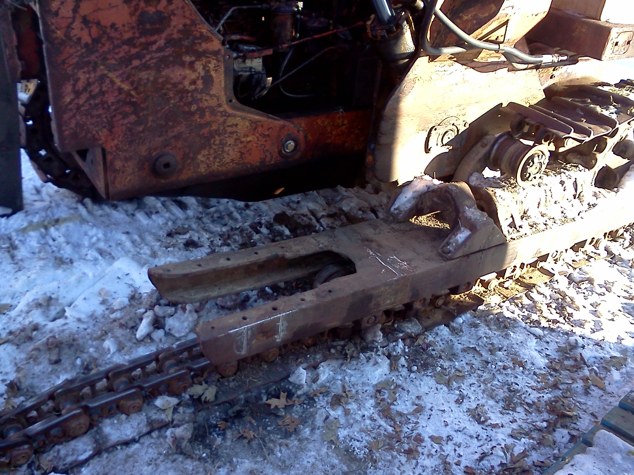

Why does my dozer gradially turn to the left when I'm driving.
It has exactly 38 links per side.
With a solid rear end (no differential) just steering clutches and final drives this does not make sence how this is possible?
Is it fixable?
Picture is out of date, she's in much better shape now.

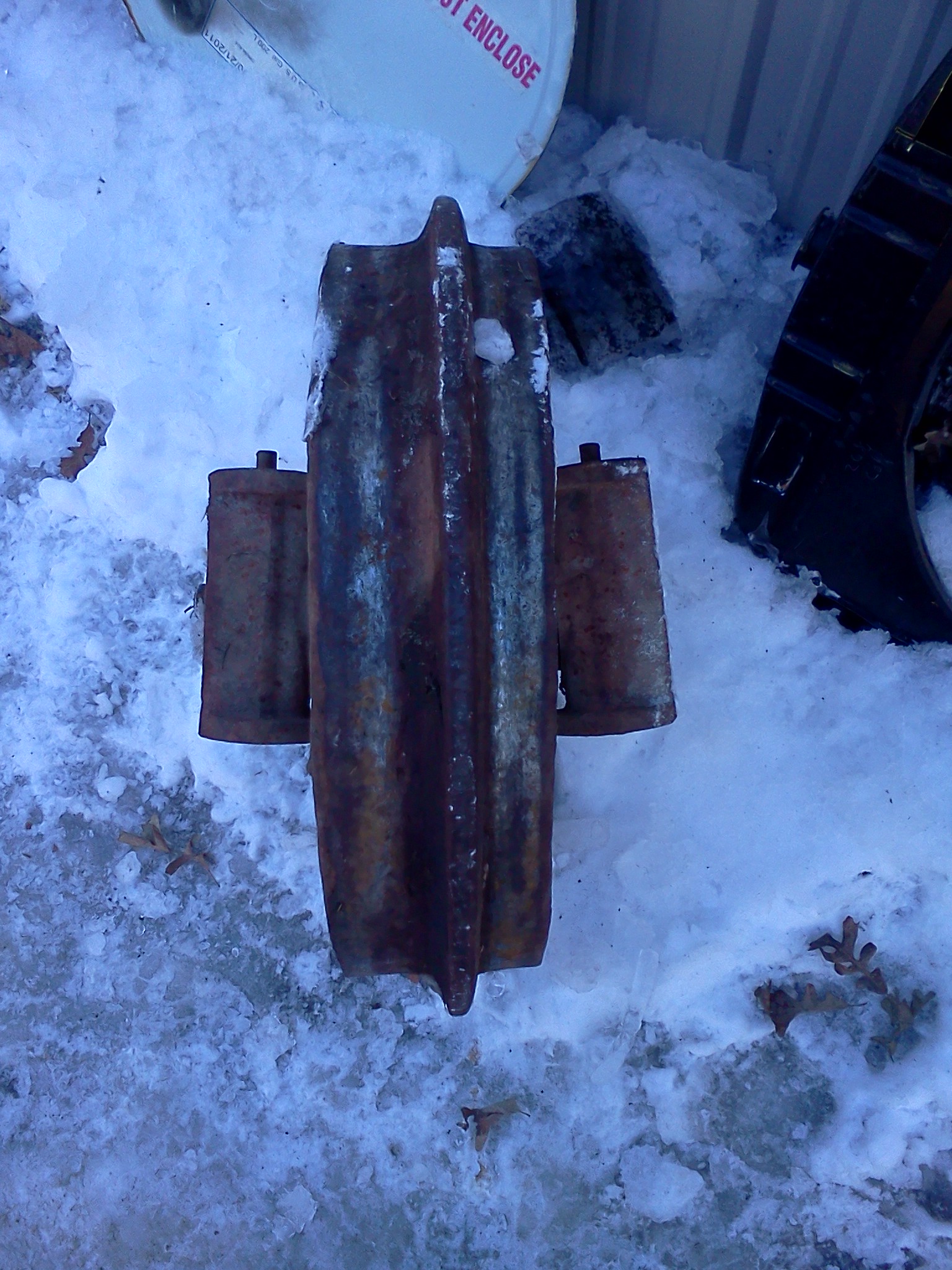

I pulled the front idle wheel off and found everything in rough shape. I'll squeeze the track frame back together, but any good ideas how to get the shaft out of the front idler so it can be staightened. I'm not sure this is the right front idle either?
My picture got fat somehow, sorry.
Somebody hit something real hard to bend this shaft!
