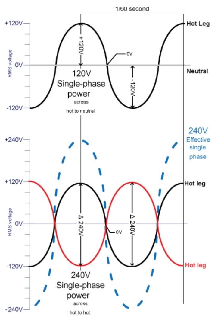

House current is SINGLE PHASE... You have TWO HOT WIRES that have 240 volts between them  ( like the dual 30 amp breaker that COKE shows)..... You have a third wire that is NEUTRAL ... If you go from ONE HOT to NEUTRAL, you get 120 volts..
Interesting, you have two phases, 180 degrees out of phase, and you call it single phase. I'm not arguing with you, you are correct, the text books say it is called single phase. US power has many peculiarities.

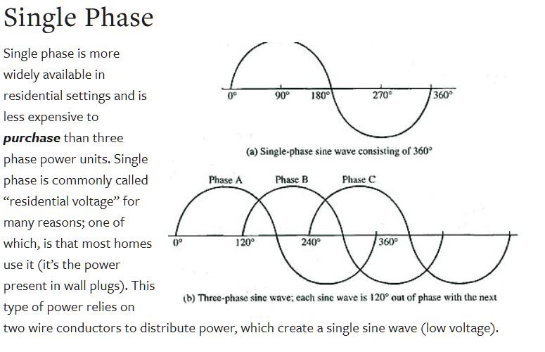

You dont have two PHASES, you have two LEGS...  The PHASE is a SINE WAVE that moves 180 degrees as you said... If you had TWO PHASES, you would have TWO SINE WAVES that were out of PHASE with each other.

Most POWER PLANTS put out 3 phase power on grid -- ( poles running around the country)... they have 3 HOT wires and a neutral.... If it take ONE HOT wire and a neutral ( and drop the voltage to 240v in a transformer), then i have HOUSE CURRENT, Single Phase.

Actually Steve, are the lines coming in from the transformer to my house are 2-120 volt, and 1 ground? I have followed the wire trail ( from ground level of course), and it appears that way to my untrained eye. I don’t see a neutral, every other pole or so, that 3rd wire goes to ground, am I correct?

Yes, there are 3 wires coming into your house.. ,  HOT - NEUTRAL- HOT........ on the POWER COMPANY SIDE, the Neutral and GROUND are the same wire ........ In your house at the Electrical Box they ARE THE SAME WIRE... on the OUTLET side of your electrical box, going to the wall plugs, you have a BLACK (hot) and a WHITE (neutral) and a BARE ( ground) ......... basically the GROUND is a SAFETY wire... inside the MAIN breaker box  the WHITE and BARE are connected to the same GROUND lug.
And dont confuse AMPS with VOLTS...  most wall plugs run back to a 20 amp breaker ( 120v)... the plugs in my garage run back to a 30 amp breaker ( 120 v).. I do this so  I / son could run two skill saws or grinder at the same time......
The  240v circuits go to the larger load appliances... Cloths dryer and kitchen stove and water heater are 240v , and normally 30 amps ( could be 40) .  Welder in the garage can be 40-50- or 60 amps depending on the length of run and size of the welder. You may have a lathe or air compressor that is 240v and only need 20 amps.. So AMPS are not determined by VOLTS..... Look in your fuse box.. If you have a DOUBLE BREAKER (two tied together) that is a 240v breaker...your AMPs may vary depending on appliance.
