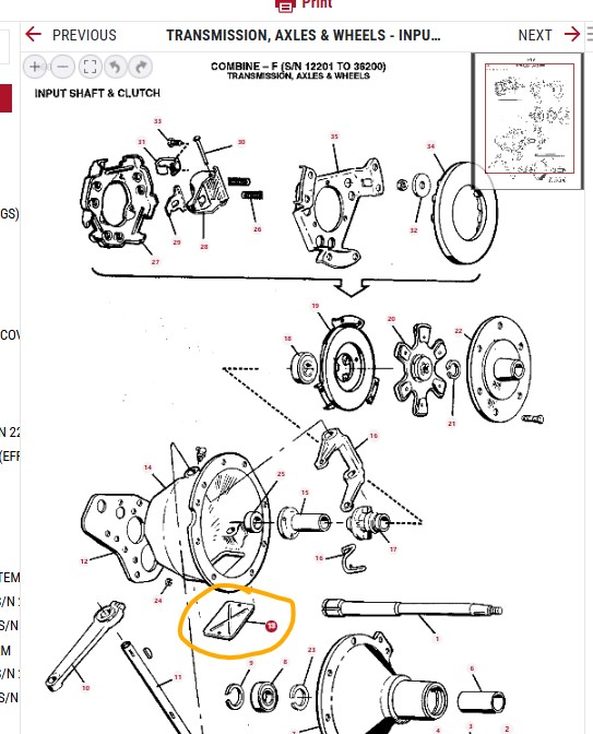

Yes on the 262 gas in early F's. Ser on plate riveted to left side near rear ladder. Jack up rear wheels and spin them. See how dry they sound and if loose brgs. Not a project for the shoulder on the drive.
