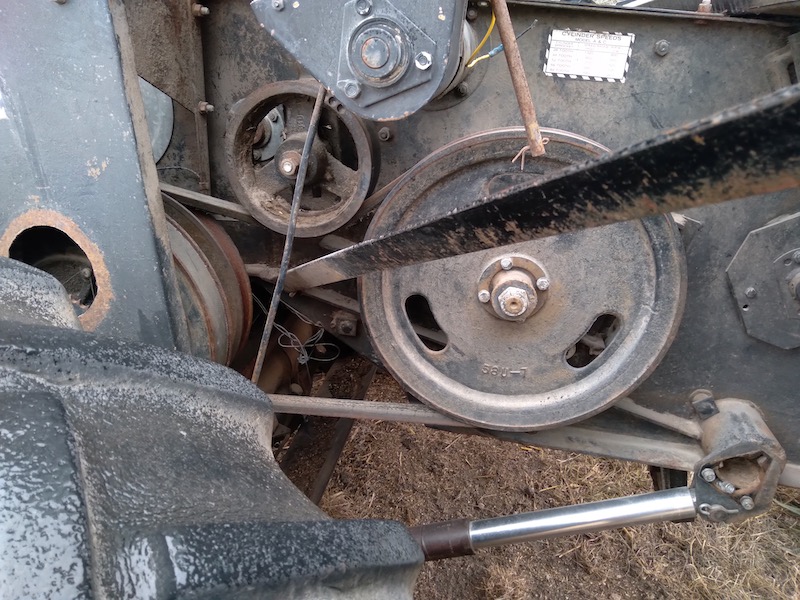

Post Options Post Options   Thanks (0) Thanks(0)   Quote AC7060IL Quote  Post ReplyReply Direct Link To This Post Posted: 04 Jan 2025 at 2:10pm
wJohn, thanks for your photo. From photo I now understand that a C2 has a single groove cylinder drive belt. Was unaware of that. And,,, the C2's pivot shaft's cylinder drive pulley that mounts to the back side of the variable speed sheave assy is larger in diameter 14"? compared to 10.25"OD double groove F/K drive pulley.  So is this cylinder drive pulley a 2 piece with a corresponding 2 piece chain sprocket?  I mean, if not, then a single piece design would require the entire variable speed assy be removed from pivot shaft to change over from belt to chain - right? Or,,, I guess maybe the chain drive sprocket is already/also bolted in there??

AC7060IL, I just figured out the F has a two groove pulley drive from looking at the parts catalog - so we are both learning and now on the same page. The CII does indeed have a one piece single groove pulley on the pivot shaft that is probably close to 14" or so in diameter, and the variable speed assembly has to first be removed to replace that pulley or a sprocket (one or the other can be installed at a given time). I don't think I can retrofit the F/K drive onto a CII.
That is why I think if I had to change to a chain drive in order to get any cylinder speeds below 800 RPM, I might as well just get the fast speed cylinder sprocket and then ditch the belt drive altogether. I could then leave the drive sprocket on the pivot shaft behind the variable speed assembly and never have to remove it or the variable speed assembly again. I'd just swap between 28T (fast speeds - same as my current belt drive setup) and ideally a 52T sprocket or similar for slow speeds. Might have to add or remove a chain link or two as well.

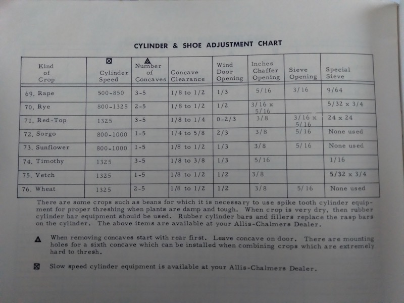

I am really starting to question some of the speeds listed in the CII manual - it says 800-1000 RPM for sunflowers:

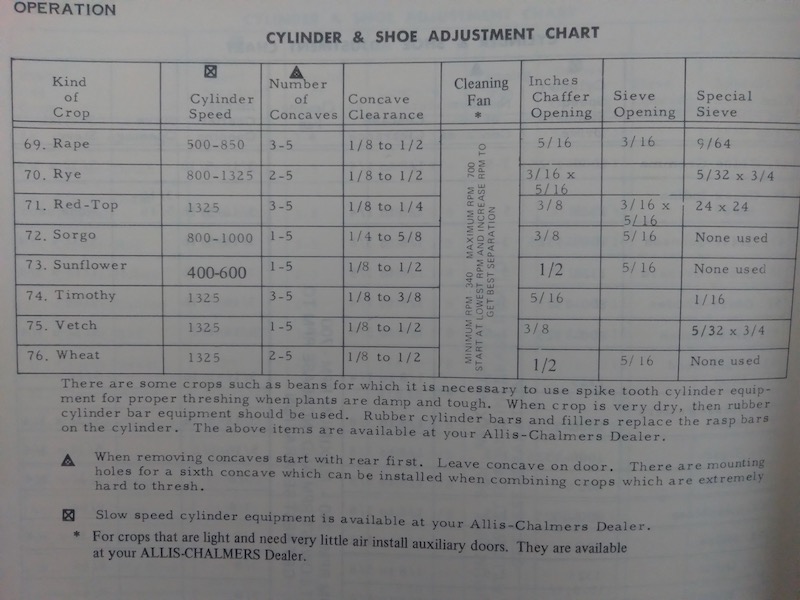

What's really interesting is that a later F manual (SN 18501 & up) shows 400-600 RPM which is more in line with what you were running, and what everyone on the internet says. AC clearly changed the numbers as the font is entirely different for the sunflower speeds compared to the rest of the chart:
Looks like a 66 tooth cylinder sprocket would get you to 560-335 RPM. An 84 tooth would do 440-265 RPM. Thanks for sharing your experience! I see why you ran the belt as much as you could with 700 acres of use per year.
