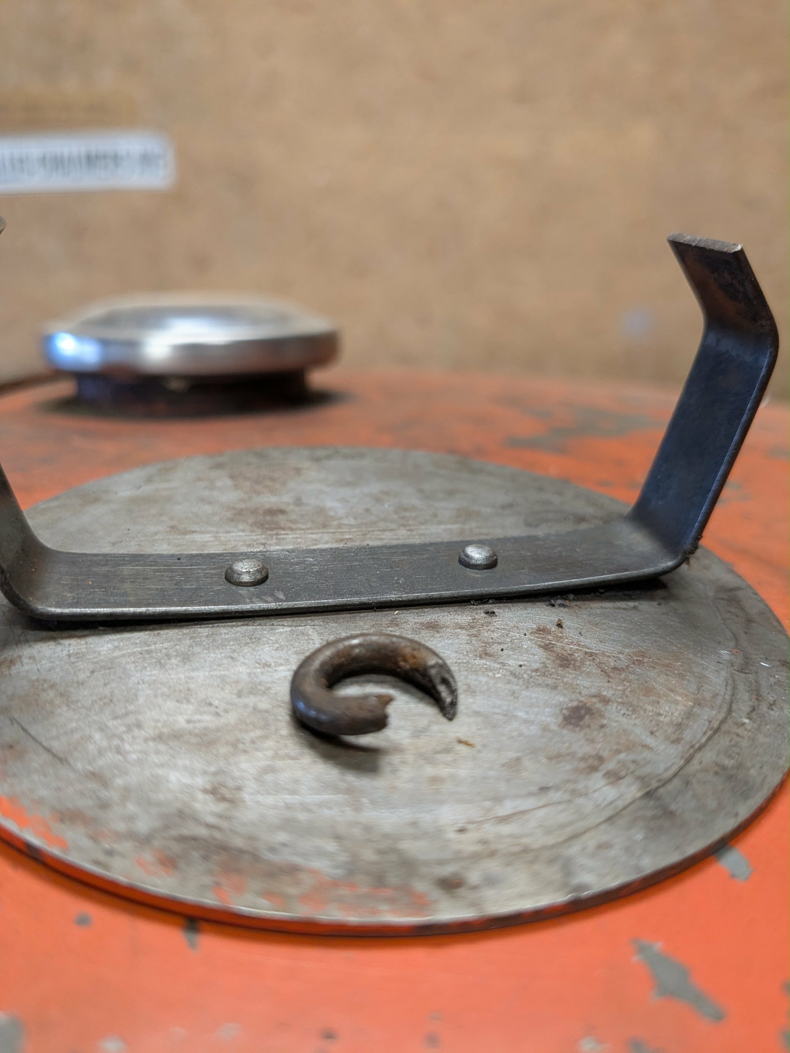

Brought the newest acquisition into the shop for some winter time TLC.  First of all, I removed the inspection cover under the clutch housing and found what looks to be part of a spring.  Pretty small - Maybe 1/2" diameter.  I am assuming it's probably from the clutch.  Can anyone give some insight?

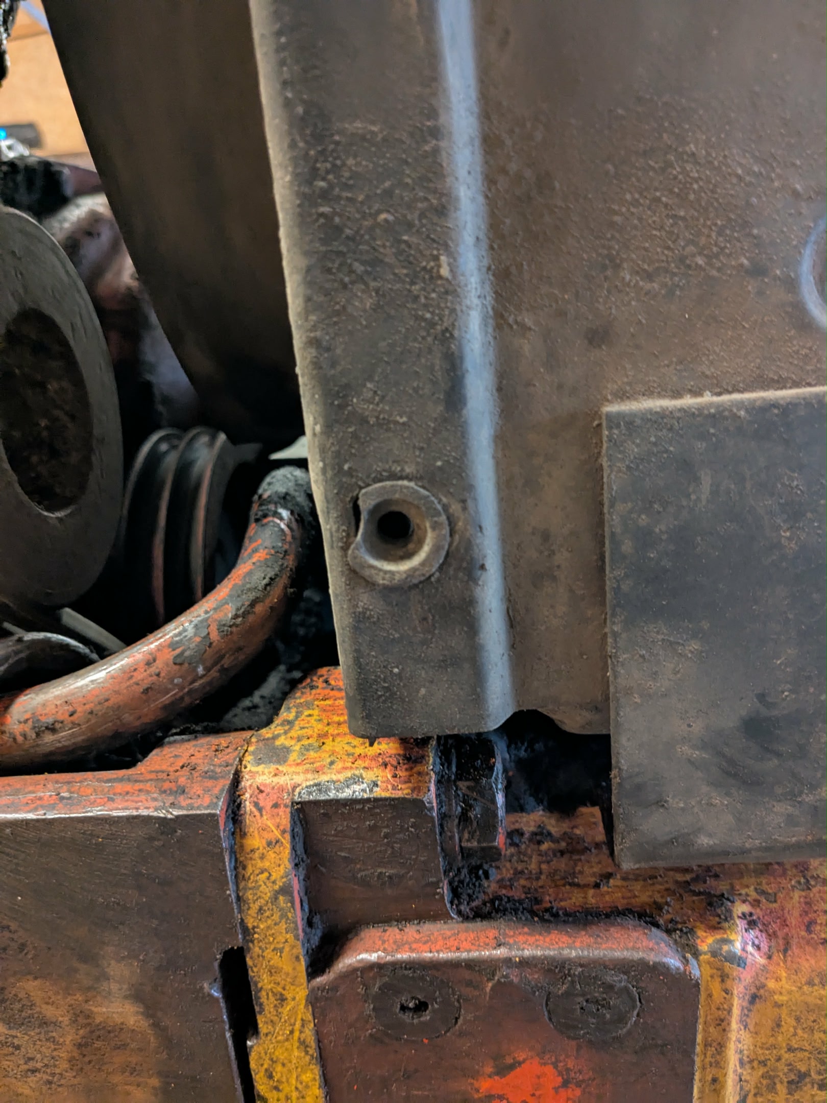

Secondly, my radiator is missing most of these "nuts" that secure the grille shell to it.  Are these available and does anyone have some?

Kimball midwest has rivet nuts to fix that but you will have to also get the tool to expand them

Any nut and bolt place can get you a rivnut kit. Buy the install tool and the correct size of thread insert. Fairly easy to use. Very handy to have. You will find many places you can use it. Smile

Post Options Post Options   Thanks (0) Thanks(0)   Quote DrAllis Quote  Post ReplyReply Direct Link To This Post Posted: Yesterday at 12:40pm
Clutch damper spring end.

Google Spaenar in Kitchener for any fastener.
