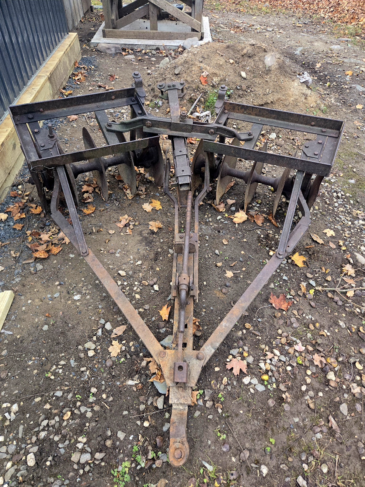

Hi all. Can anyone confirm the make and/or model of this disc? It might be the front section of a larger disc (not really certain). It has bearing housings with "WD28" stamped on them. The bearings are wooden. I need 4 bearing houses and bearings for it. Any help would be greatly appreciated.
Scott

Unless you are just over flowing with luck, you can make them faster than the time you spend looking for them. Or convert them to something parts are a around for.
I have never made a wood bearing for a disc, so I could be wrong. But see what would be good hard wood, you can get your hands on. May have to glue pieces together to get a block and then find a whole saw as close as posable of the size you need. Then very careful use of a die grinder. That is if you really have your heart set on using this.
But that looks like really nice yard art.
