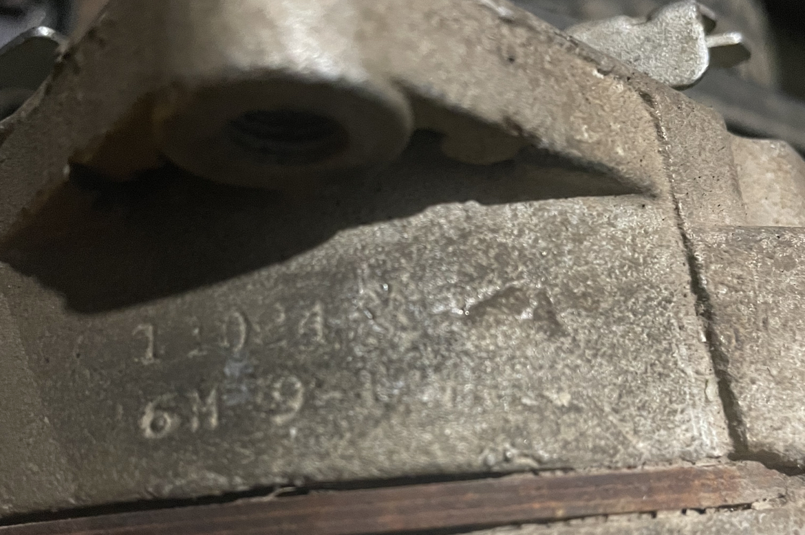

So I picked up 2 delco remy alternators that don’t work, the one worked when I first got it but it quit and the other was stuck but it came loose and never worked and so I’m trying to find parts for them but I can’t seem to find anything.
So I can only find numbers on the nicer one which I think is:
Delco-Remy
11024M
6M 9-12V
Both are 3 wire..
1955 AC WD45 diesel with D262 repower, 1949 AC WD45

That's most likely a Delco 10SI alternator with built in solid state regulator. If you want to take on rebuilding it yourself, click below and take your pick. As said by others, you can use your old unit as a core and get one already remanufactured or get a new one from a place like DB Electrical.

A Delco alternator part number should be 7 digits, no letter, from any I have seen.   Back away from the alternator a bit and take another picture of it showing the entire back of it and the connections.  The 10DN series has 3 connections as well as the 10/12SI series, but are externally regulated.

Take one of them and use it as a core. Pick yourself up a 10 SI series Alternator at the Auto Parts store. The stuck one probably had water in it, so it's probably junk inside. You'll be way ahead of the game. You didn't mention what Tractor you're working on, but the "SI" series will work on the "W" series Tractors as well as a B and some of the "D" series Tractors. If you have a C or CA or a G, you'll want to move to either a Delco "CS" 121 series Alternator which is the smaller cousin of the "SI", or the mini Denso. Those will be a little more expensive, but well worth the dough especially if you're cramped for room.  With the Delco Alt's you can pull the 1/2 wide pulley off of them and install the pulley off your Generator being they are the same .670 shaft. The Denso incorporates a 15mm mainshaft, so a special pulley is needed if installing it on the early Tractors that take the 5/8" wide belt pulley. We have that special pulley in stock if interested, if you're going to move to the mini Alt Denso.  Wire your Tractor for a 3 wire system so you don't have to rev the snot outta' the engine like ya do with a one wire. Save the one wires for the hotrodders....... HTH  If you need any more info, just drop me a line. Be happy to point you in the right direction....

That is a 10 SI series Alternator in your pic. Stroll in the Napa, hand them the one that was stuck, and ask em' for a 7127-12, and plop that junk one in the core box, and tell the counter guys to have a nice day. You'll be waaay ahead of the game.....
