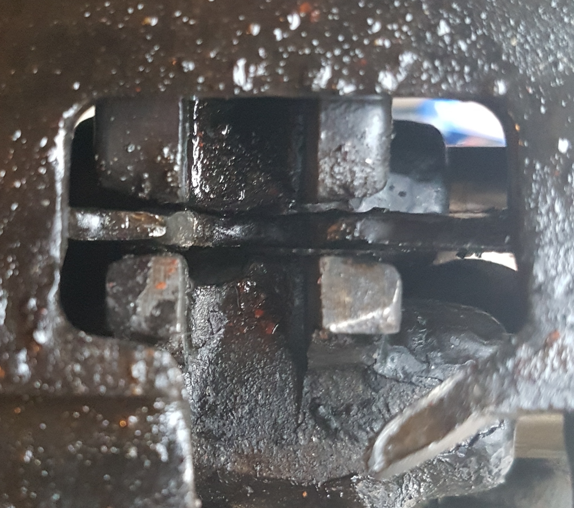

Replace shifter. The casting where the shifter seats may be worn also. That being said it shouldn’t jump out of gear unless the fork isn’t being moved all the way in to the detent or the detent is worn or broken/missing spring.

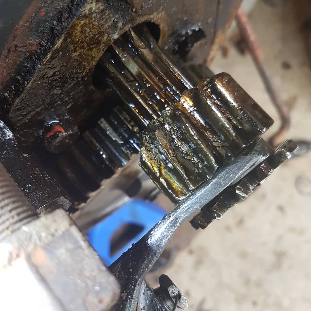

Do not forget the creeper gear.  The B-C transmission is used however, in front of the transmission case there is a housing in which the creeper gear resides.  A lot of times the creeper gear will not engage.  There is a shiftier rod that is part of the gear shift pattern.  More than enough the Shiftier rod gets out of the pattern.  Merely move it back into alignment and you will have the full four gear pattern.

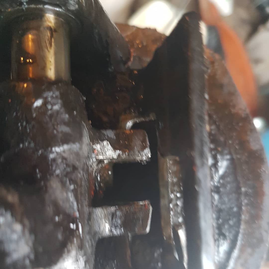

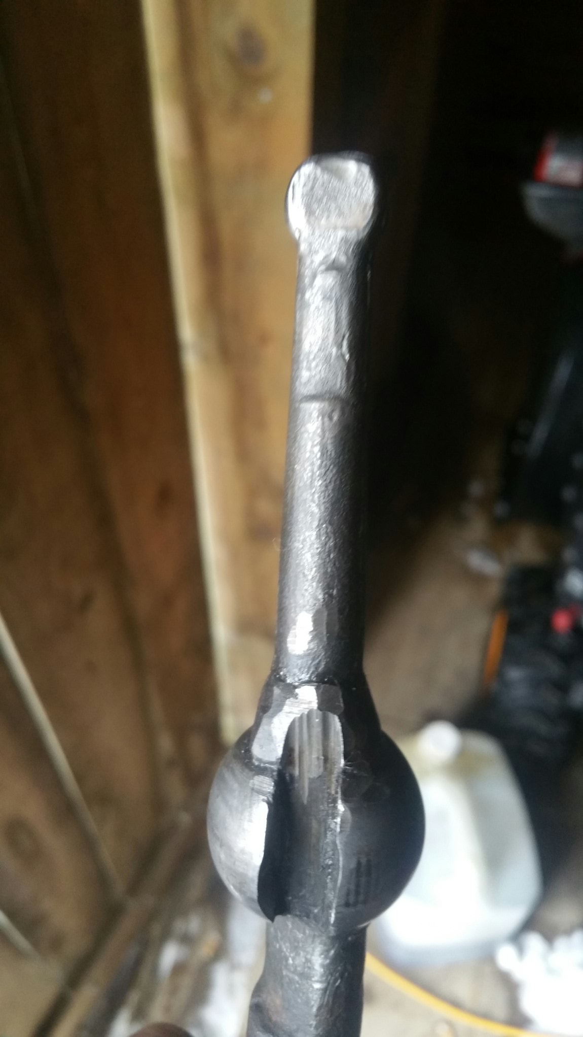

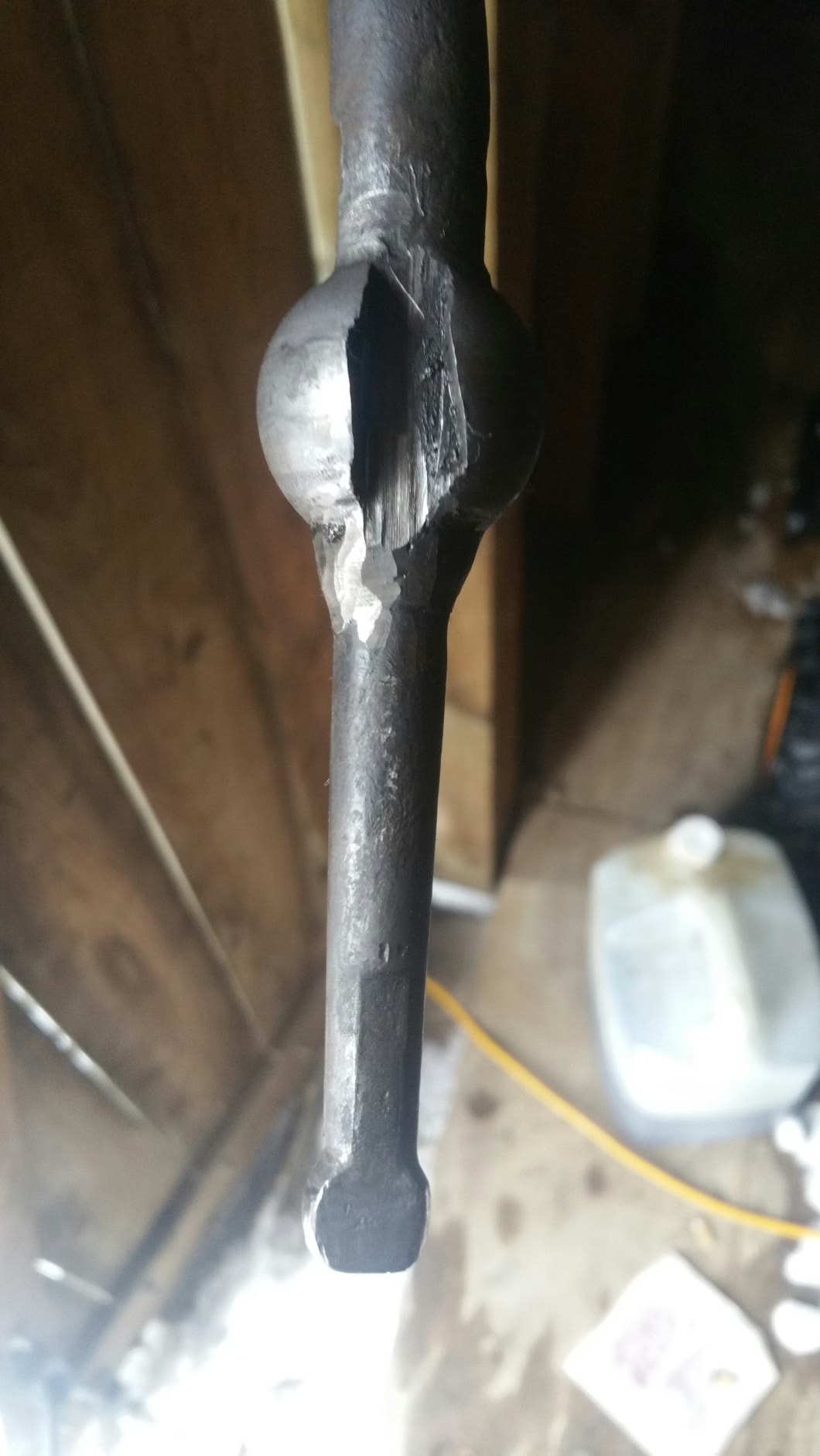

Anyways I tore the g down good throughout the week. I cant say I know what the issue is exactly but I think it's the shifter. Didn't see anything wrong with the forks or gates on the shifter fork plate. I do see one part on the bracket that's riveted to the plate that I believe is bent but don't believe its causing me an issue.

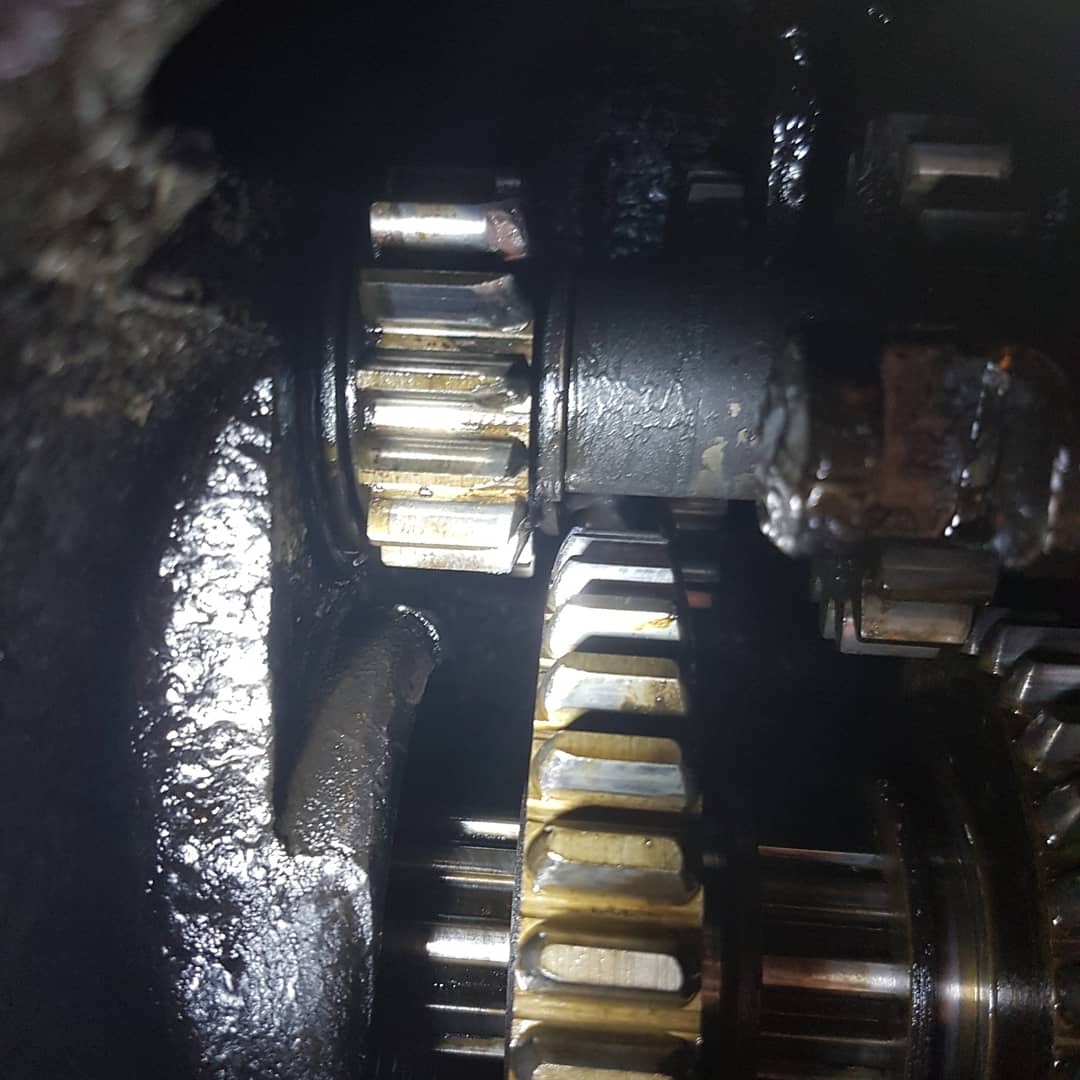

When I had the torque tube off I could see the creeper gear was too far forward for me to ever have engaged it. I bumped it back with a plastic mallet and was able to shift it. When I did I could only get the gear in about half way until the shifter ran out of stroke as it hit the housing.
I'm guessing since the bottom of the shifter is messed up it's not fully engaging gears and some how its able to slide in between the two gates. I think I'll get the shifter off the parts g when I can (it's not at my house) and see how it feels in there. My current shifter is floppy as hell when in gear.
Also looks like some one used tar as lube in this thing as its nasty. Also looks like someone thought creeper gesr eas a heavy pulling gesr as the small gear is right messed up and the large creeper gear is rough. I'll clean the large gear up with a fine file and replace the small one.

Post Options Post Options   Thanks (0) Thanks(0)   Quote AllcropJay Quote  Post ReplyReply Direct Link To This Post Posted: 09 Mar 2019 at 6:40pm
Bottom left is the part I believe to be bent.
