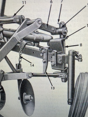

In the final stage of restoration and I have mounted the plow.  When I use the hand lift, It swings inside and rubs against the lift mechanism.  I never had this problem before I took it apart.  I took lots of pictures while I dismantled it and it looks like I have everything back together correctly.  I recall someone had this same problem around a year ago, but I cannot find it.
Hopefully you can see in these pictures...

Myron, you're missing #13 in the picture

That was me asking this same question earlier and Joe had the information to get me on the path to a solution. Ended up having a fabrication shop make a replacement piece that solved the problem.

Never had a problem with it before I tore it down.  I will be heading to my local fab shop in a couple of days.  They are always happy to see me $$$

bet getting everything cleaned up let it pivot and swing easier, allowing it to hit
